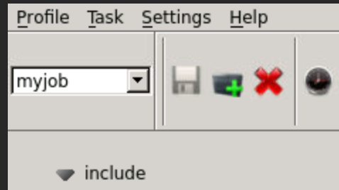

Hey, I've been checking this on daily basis.
Could you explain what you meant with "cron from the host"?
Is there a way to make a cron within UnRaid to run the task's within LuckyBackup, or..?
Sure thing create a new Cron entry on the host with the following script contents and the preferred execution schedule:
#!/bin/bash
docker exec -i --user luckybackup luckyBackup env DISPLAY=:0 /usr/bin/luckybackup --silent --skip-critical /luckybackup/.luckyBackup/profiles/default.profile
A short explanation:
  • docker exec -i --user luckybackup (sends a command to the container as user "luckybackup")
  • luckyBackup (this is the actual name of the container, change it if your container is named differently)
  • env DISPLAY=:0 /usr/bin/luckybackup --silent --skip-critical /luckybackup/.luckyBackup/profiles/default.profile (is the actual command that is passed to the container that it should execute - ATTENTION change the underlined text 'default' at the end to eg: 'myjob' (without quotes) if your job that you created in luckyBackup is named 'myjob')
(Please make sure you've run the task once from the GUI otherwise the Cron job will not work)
If you have any questions feel free to ask. :)
#!/bin/bash
docker exec -ti --user luckybackup luckyBackup env DISPLAY=:0 /usr/bin/luckybackup --silent --skip-critical /luckybackup/.luckyBackup/profiles/default.profile > /dev/null 2>&1
  • docker exec ti --user luckybackup (sends a command to the container as user "luckybackup")
  • env DISPLAY=:0 /usr/bin/luckybackup --silent --skip-critical /luckybackup/.luckyBackup/profiles/default.profile > /dev/null 2>&1 (is the actual command that is passed to the container that it should execute - ATTENTION change the underlined text 'default' at the end to eg: 'myjob' (without quotes) if your job that you created in luckyBackup is named 'myjob')
Massive thank you for the script!
I feel like I might be missing something here though, should the scrip work through "User Scripts" plugin for UnRaid?
I tried to manually run the script, and it doesn't seem to be doing anything as far as I can tell 🤔
I didn't change anything from your script, as my current task within LuckyBackup is named "default" and I haven't changed the container name either.
Yes, you should create a new script in the User Scripts plugin.
For testing purposes you can run just the full command from the Unraid terminal (not the Container terminal!).
You will see no output but the Backup should run just fine, this is because it is running silently, but this is basically the same as when you create a Cron entry within luckyBackup.
Make sure that the task was run once.
Yeah, I figured the "silent" part within the script would do that, but still, I should be getting some sort of a log somewhere about this, right?
Also, I tried to see within the LuckyBackup, if those backups had been made or not (from the "task" -> "manage backup" options on top, you can see the latest versions of the backups)
Please read the post from above, slightly modified.
No, no log output since I'm redirecting this to /dev/null...
Remove the '> /dev/null' part and you will get a output.
The log says:
Script location: /tmp/user.scripts/tmpScripts/AutoBackup/script
Note that closing this window will abort the execution of this script
the input device is not a TTY
The log says:
Does this happen when executing from the terminal itself or from the User Scripts, if from the User Scripts change '-ti' to '-i' (always forget about that... :D ).
Aces! That seemed to fix it, and the script seemed to run just fine! :)
And I'm getting a log from it, which is is good for me.
Only one issue I'm having now, is that it doesn't seem to mark the last backup within the "task" -> "Manage backups"
So in a case of restoring a backup, it doesn't show up in the menu 🤔
Try this command:
docker exec -i --user luckybackup luckyBackup env DISPLAY=:0 /usr/bin/luckybackup --silent --skip-critical /luckybackup/.luckyBackup/profiles/default.profile > luckybackup/.luckyBackup/logs/default-LastCronLog.log 2>&1
Try this command:
Log:
/tmp/user.scripts/tmpScripts/AutoBackup/script: line 2: luckybackup/.luckyBackup/logs/default-LastCronLog.log: No such file or directory
6 minutes ago, REllU said:
Log:
Then I can't help and you won't see it in luckyBackup because this is basically the default command that is run by luckyBackup with a Cron schedule.
But at least you can run the backups on a schedule for now this way...
I suppose it'd have something to do with permission issues (atleast that's what I was able to gather from a quick googling)
Either way, thank you for the amazing support! :)
I'll be doing my daily check-ins here to see when the issue gets fixed within the GUI
