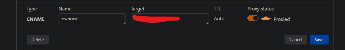

@alturismo Thanks for the feedback.   I am almost certain cloudflare (which apparently now sells a streaming tier) is also involved here somehow.
Fortunately I can reach owncast via the local ip address so there is no need for me to take on this task at this time.
I was just interested if @Mr_Jay84 was working remotely and if he'd conquered the same problem.
@eds in case, take a look at your dns settings in CF, turn off "proxy" feature (orange cloud = on, grey = off, then its just like a dns service ... but like i said, rtmp is a different protocoll and needs some setup (to use the rtmp module) to proxy a rtmp stream, which is then not going through the http part and not really using the domain selection, you will figure it.

19 hours ago, eds said:
 I am using ngnix proxy manager and I have cloudflare as my registrar.
I can reach the domain's admin page no problem, but I cannot access owncast using rtmp with the domain name.
I believe it is because cloudflare is blocking it.  I turned their proxy service off the cname and still no luck.
I am beginning to believe I can't use owncast with cloudflare, but I cannot be sure.
Maybe you can tell me if there is anything in the logs I should be looking at to see if in fact this is the problem.

Using https my owncast is totally unstable.
Is your stream setting in OBS, for example,  https://mydomain.com/live or https://mydomain.com:1935?
Edited by eds
Is your stream setting, for example,  https://mydomain.com/live or https://mydomain.com:1935?
I think you're getting confused here mate.
You use RTMP to stream from OBS to Owncast. This is normally done on your internal network i.e. rmtp://YourUnraidIP:1935/live.
Port 1935 is what you stream to from OBS. It's not the port users should connect too, which by default is 8080
Then to access the Owncast page via https use (for example) https://Owncast.yourdomain.com
No port is required as it's https.
Your gateway should be pointing the domain to the internal address i.e. http://YourUnraidIP:8080
Edited by Mr_Jay84
I see. I was unclear in my initial question to you.  I should have asked what you have obs connecting to, the domain name or the ip address of owncast.
I have no issue with remote viewing or access the admin page from the domain name.
For me it was always about OBS connecting to owncast.  And it appears as if you are using the ip address via rtmp to do that as am I.
