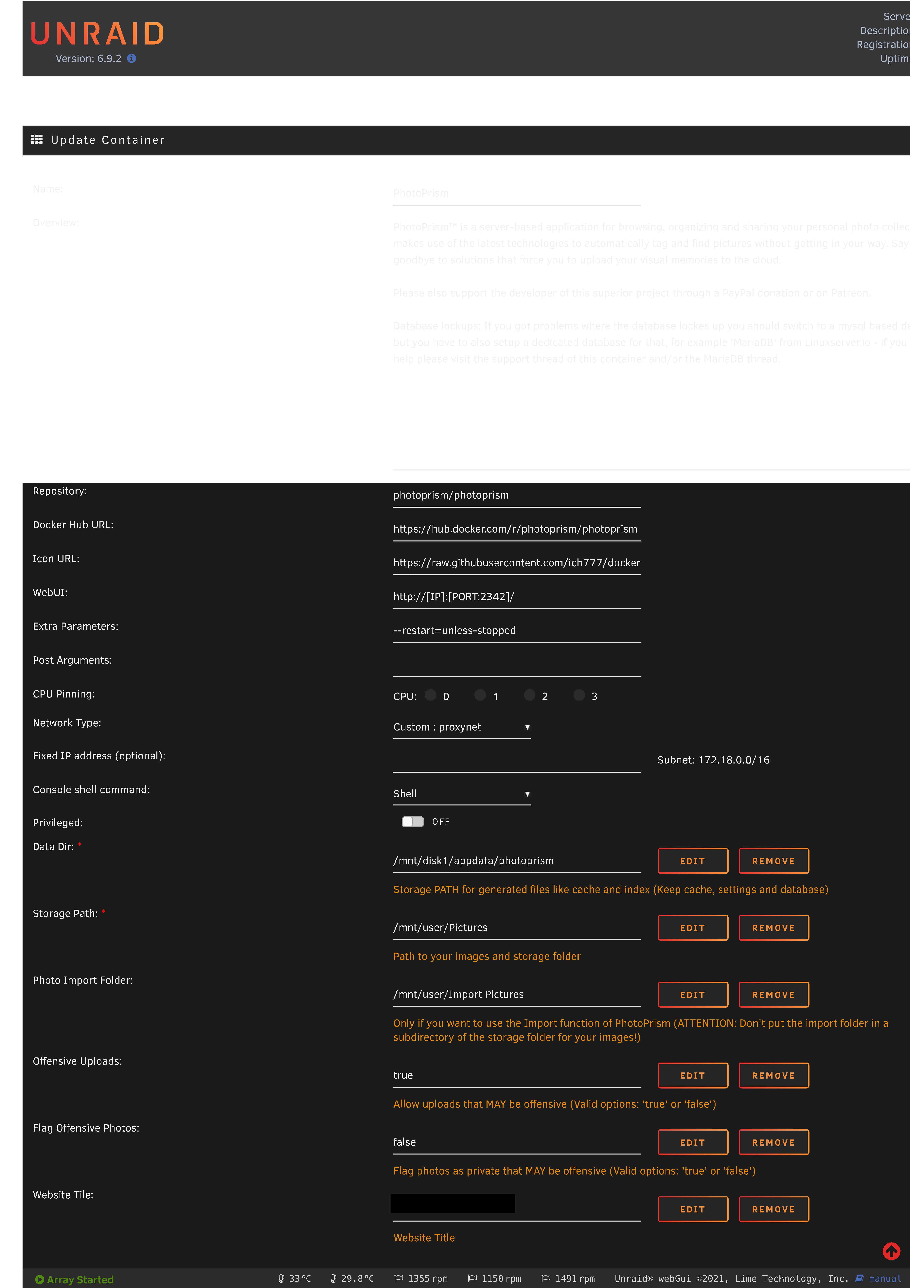

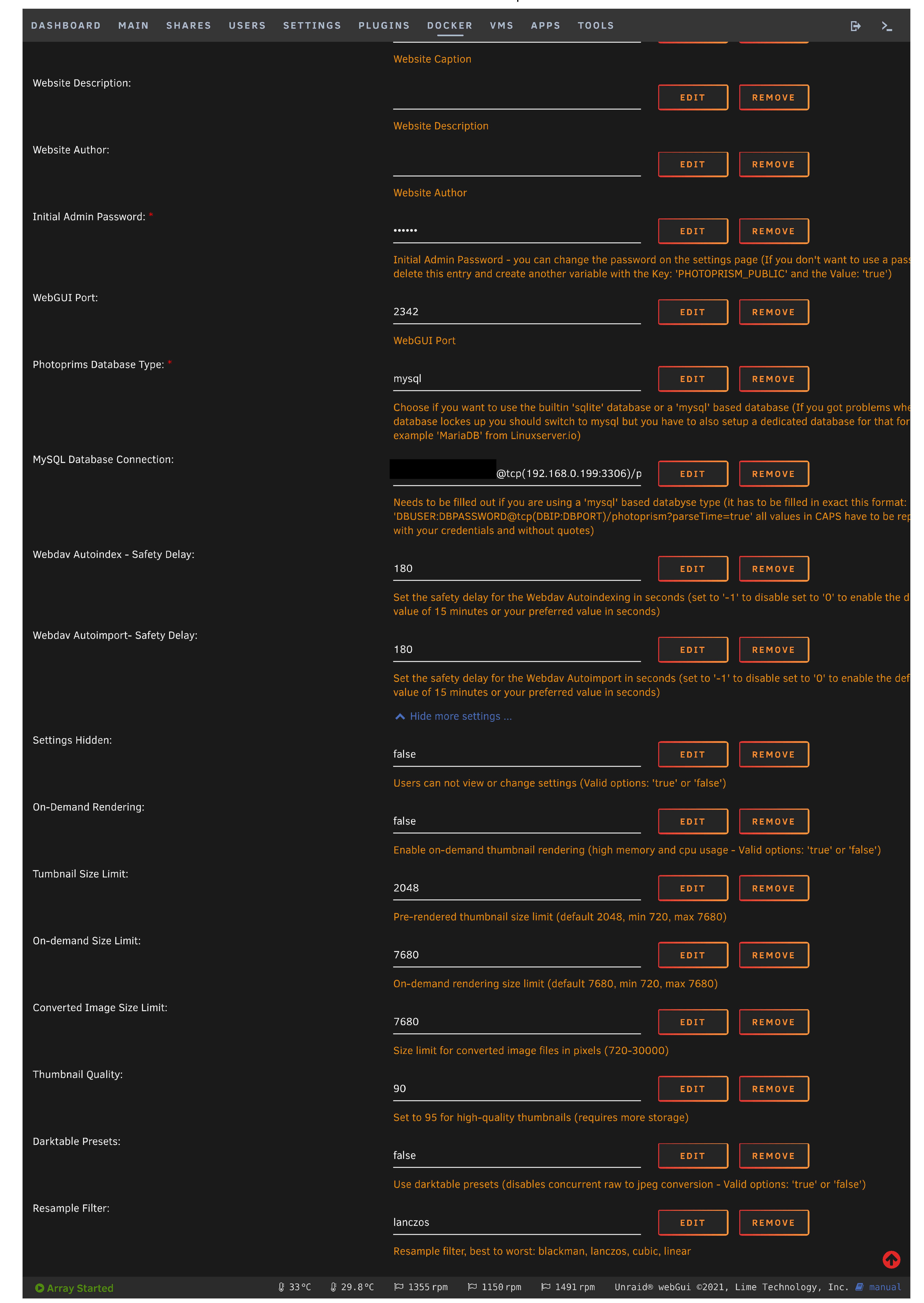

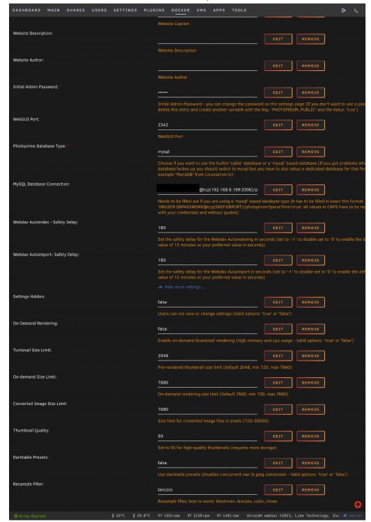

@ich777
is PHOTOPRISM_AUTO_IMPORT is this for webdav only ?
we have 180 sec by defualt in docker.
i dont see that auto import working for import folder of photoprism.
also in log nothing about auto import from import folder
only i see in log auto indexing working every 3-5 min but not import ,
how to fix it ?
Thanks

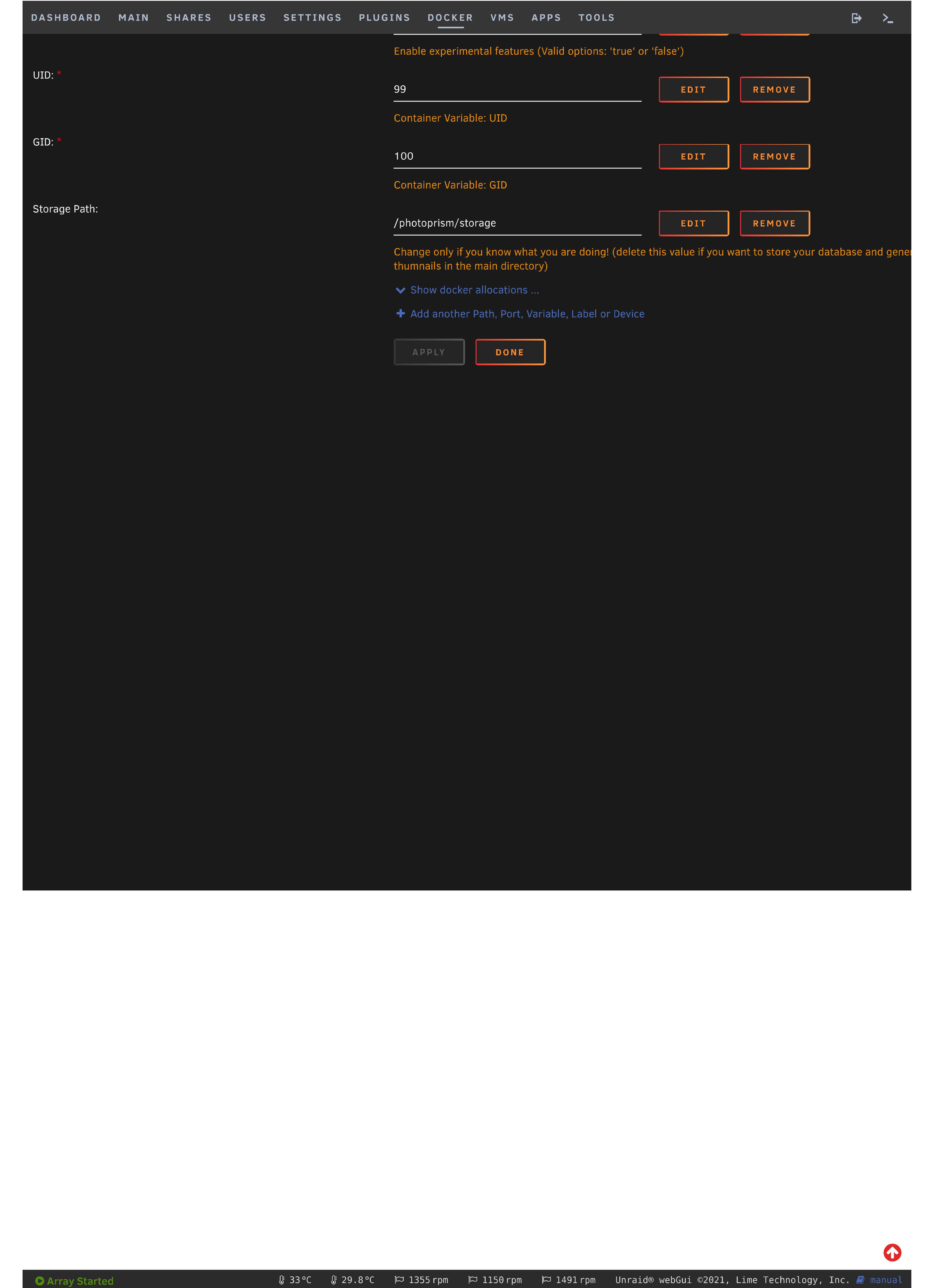

1 hour ago, ich777 said:
Seems like something is not configured properly
Sending config
Edited by Masterwishx

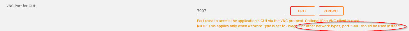

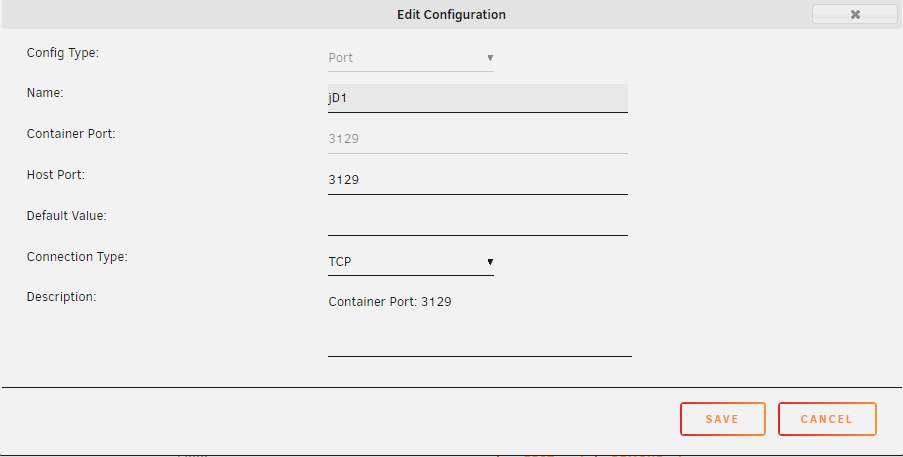

Hi!
i'm trying to route my jDownloader Docker through your openVPN Docker.
Atm jDownloader loads with 9kb/s so i think maybe i should pay more attention to this:
To tunnel traffic from another container through this container edit the template from the other container, set the 'Network Type' to: 'None', enable the advanced view in the top right corner and at 'Extra Parameters' add the following: '--net=container:OpenVPN-Client' (replace 'OpenVPN-Client' with the name of this container if you choose a different name for it) and write down the port(s) that you need to connect to.
After that go back to edit this containers template and add the port that you have noted in the above step to this container and click 'Apply' now you can connect to the container that you tunneld the traffic though this container.
... and write down the ports that you need = the ports that are shown in the docker allocations?
After that go back to edit this containers template and add the port that you have noted in the above step to this container and click 'Apply'... >>> "Add another Path, Port, Variable, Label or Device"? i configured 3 ports (3219, 5800, 5900) like this:
now i can't reach myjdownloader anymore... without these 3 ports configs (but with network none / extra parameter '--net=container:OpenVPN-Client') i could at least reach mydownloader and access webgui (extremely poor performance).
what am i missing?

8080 is used by another container, is this the port?
5900 is already configured with container 5900 and host 5900. (see screen above)
tried with container 5900 and host 27445 but i can't access through the container ip:27445
this is the container ip, right? (different ip range from my lan)
I wouldn't use port 5900 since this is also used by VM's, try something different or at least you can configure it like in this template with the Container Port 5900 and Host Port 7907 in the OpenVPN template and delete this port entry first from your JDownloader template to avoid conflicts.
@ich777can you please check the config I sended to see if any problem of auto import here...
Sorry overlooked the answer yesterday.
The config seems fine, in what folder did you copy the pictures that you want to import?
Please also look at this Github issue: Click
2 hours ago, ich777 said:
I wouldn't use port 5900 since this is also used by VM's, ...
i don't have any VM's running and i had no problems with the jDownloader Docker before i tried to route the traffic through the openVPN Docker.
i should remove the VNC Port for GUI entry from jDownloader container?

30 minutes ago, pika said:
configured the ports in openVPN container >> myjDownloader not reachable.
May I ask what the ports are for? You basically have to create a port for the noVNC webport in the OpenVPN container and/or for the VNC server if you want to connect directly to it.
If you want to configure it in the OpenVPN container, yes, I would recommend that.
