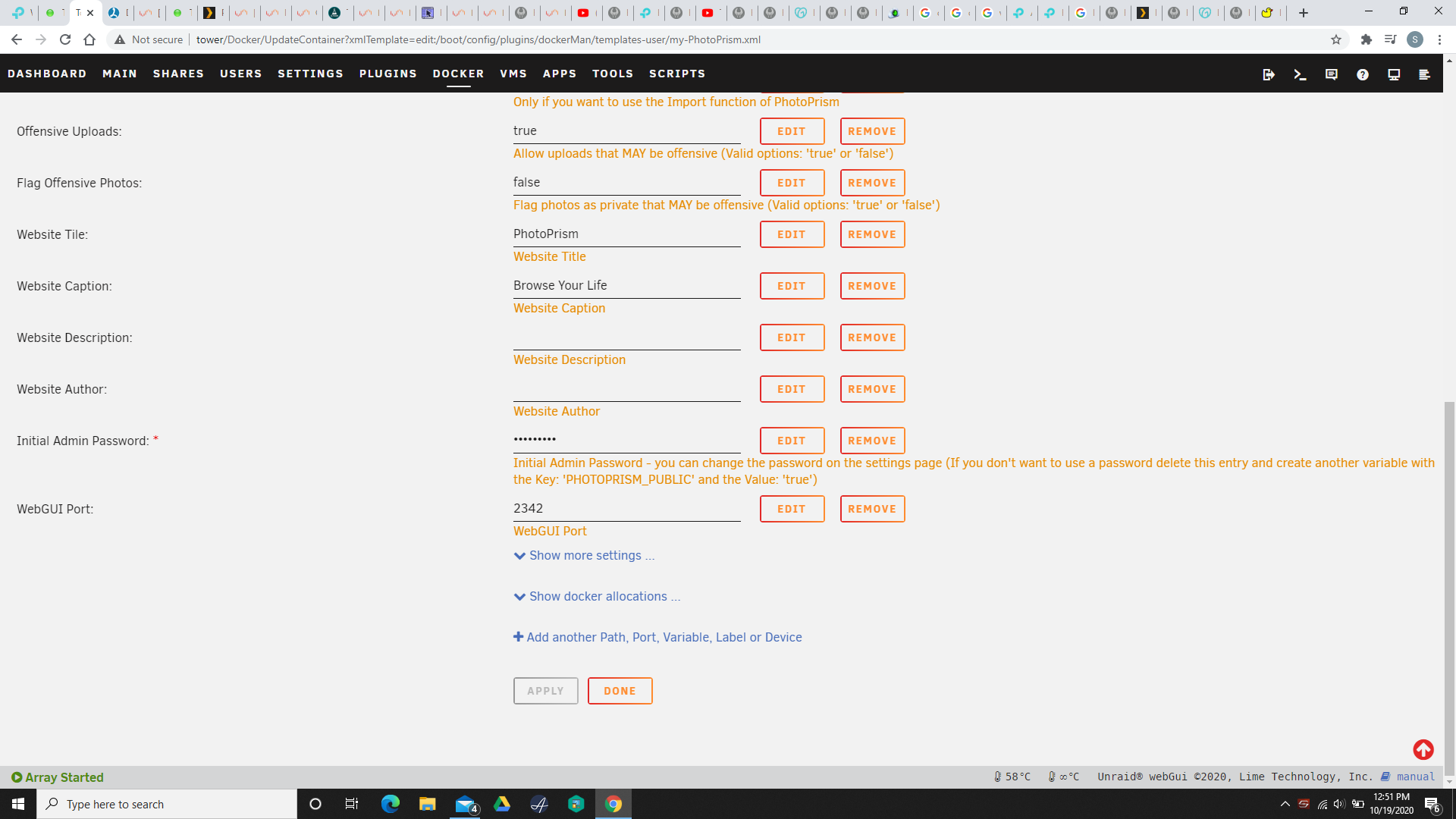

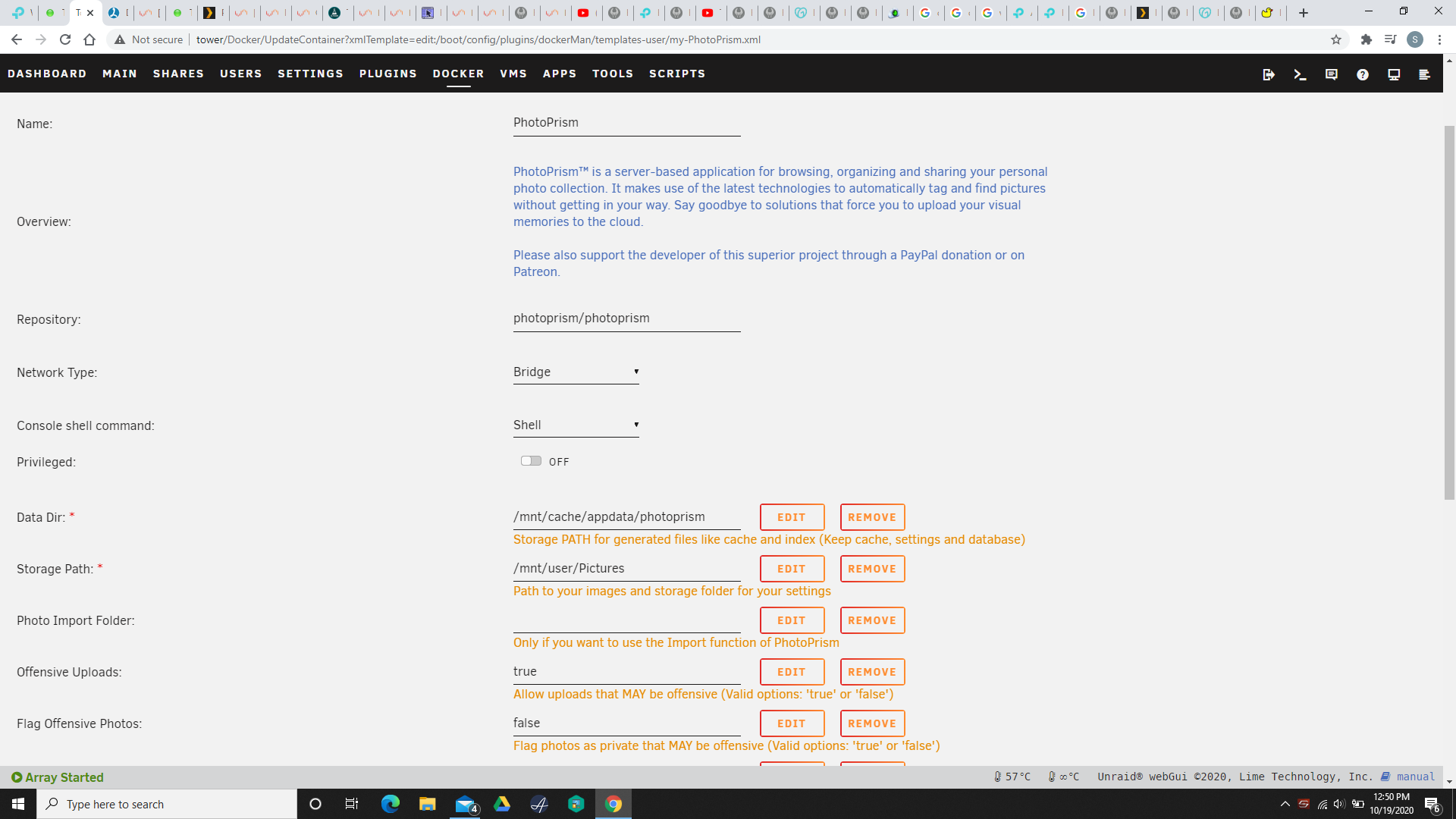

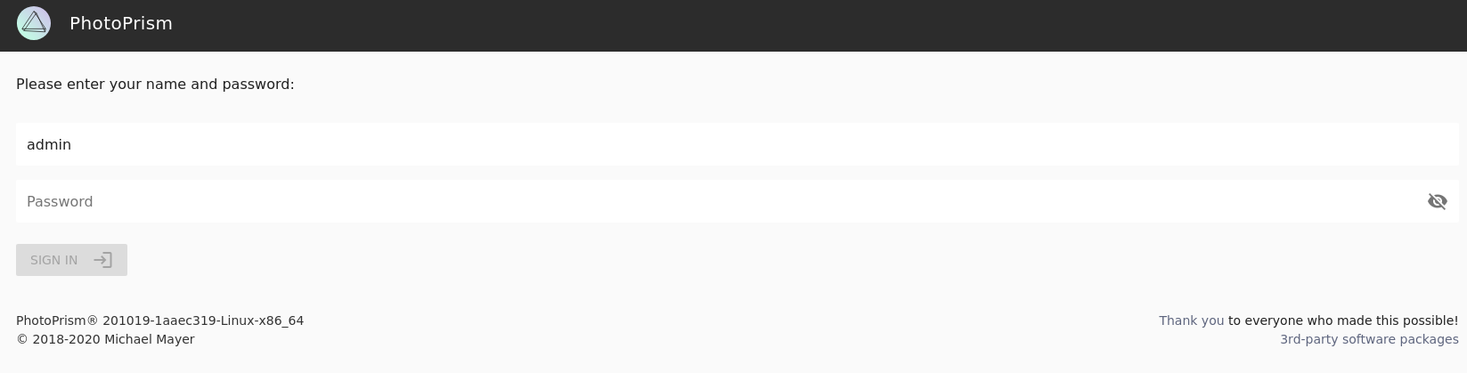

Hello, I just installed PhotoPrism, I didnt change anything except add a password that is asks for. It starts, however when I go to the webgui it isnt working. I get "this site cant be reached" page
Is there something in my Unraid that is causing this? The docker template network type is still set to the default Bridge. I'm not having a issue like this with any other apps.
Edited by SPOautos

18 minutes ago, SPOautos said:
Changed to host, but its still doing the same.  I'm not sure what it could be except Swag reverse proxy but typically when I install apps Swag doesnt have any affect on them unless I assign them to the custom network type that is related to the reverse proxy.
How do you connect to it? YOURSERVERIP:PORT or did you just reverse proxy anything yet?
Can you give me the log output?
Have you configured something in your Unraid Network configuration? Have you installed a Cache drive? Can you provide a screenshot from the template?
I just went to PhotoPrism in the docker tab, clicked and went to webgui.  It tried to open it up in the brower using the serverip:2342 but says that it cant for some reason. However I can open other apps just fine. Just late last night I installed DiskSpeed which also installs in Bridge type and its webui opens in the browser using the serverip:port and it opens fine. I dont see what going be going on that would cause two apps both using Bridge type and the same ip with just different port numbers to open one and not the other.
Here is the log info.....

Edited by SPOautos
That's fine because the port is routed from the internal Docker network to the hosts network and so you can reach two different Docker containers on different ports from the hosts IP:PORT.
If you are using two Docker containers with the same Port Unraid will throw an error.
I can't help when you don't answer the other question.
I need the log (the little sheet icon on the right side or the blue text that states how long the container is running), the template page itsef and all the other questions answered above to look into this to eventually help you out.
I had gone back and edited the post to include the log file...just took me a minute....I pasted it into my last post (is that what you wanted me to do or to attach the log file as an attachment?)
Edited by SPOautos
The log tells the problem. It simply can't start the container and is now looping.
  1. Stop the container
  2. Remove the container completely
  3. Remove the folder 'photoprism' from your appdata folder
  4. Redownload the container from the CA App
  5. Fill in the password and also try to define a import folder
The log should only be ~3 lines that tell you that the webserver and app startet.
Its working. I had actually deleted and reinstalled before posting here but I didn't know to delete the appdata folder. That fixed it.
THANK YOU

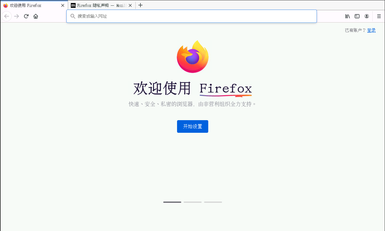

Hello, I just installed Firefox, and I found a problem is that the Chinese cannot be displayed correctly。How can i fix it?
I will look into this, should be a quick fix, I will update the container as soon as possible. I will edit this post if the new version is online, please report back if everything works.
EDIT: Please update the container (force update):
For the PhotoPrism docker you should add in options for using mysql isntead of sqlite since the built in sqlite is horrible with performance and getting itself "locked" causing issues.
Here's what I've added on mine to get it working.
Key: PHOTOPRISM_DATABASE_DRIVER
Value: sqlite (default) or mysql
Description: Change my mysql instead of sqlite to use a MariaDB or MySQL database.
Name: MySQL Data Source Name
Key: PHOTOPRISM_DATABASE_DSN
value: user:pass@tcp(IP.OF.DATABASE.SERVER:3306)/photoprism?charset=utf8mb4,utf8&parseTime=true
Description: MySQL database connection information. Leave alone if using SQLite
NOTE. Would just need to test actually leaving DSN blank/unchanged for sqlite, it shouldn't use it at all if sqlite is in use, but I haven't actually tested this.
All info from here: https://dl.photoprism.org/docker/docker-compose.yml
I have this up and working on the MariaDB container with this information above.

Yep I know that and the informations are all on the previous page I think but most of the people are not configuring photoprism with MariaDB or MySQL.
I cann add the options but don't think that anybody uses it, I'm also thinking about pulling the container from the CA app because the reals devs don't take Unraid serious and don't understand how Unraid permissions work (or most consumer grade NAS are working).
EDIT: btw I thank you for researching this yourself since most people doesn't do that.
