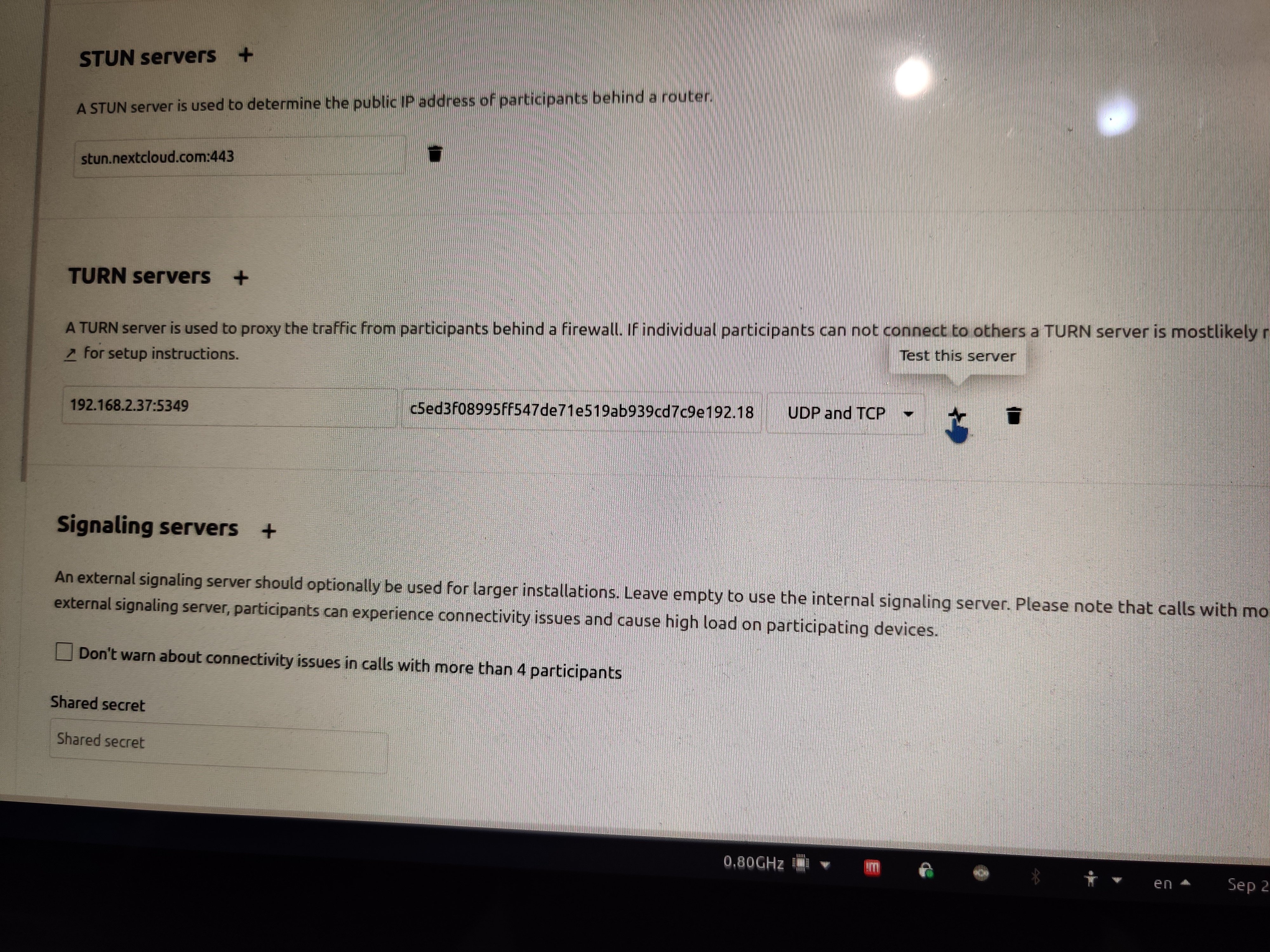

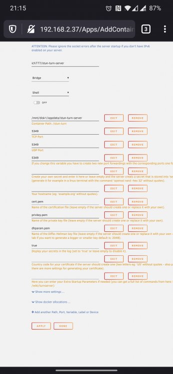

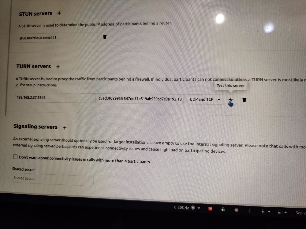

Hi,can someone post screen shot with Stun-Turn server for Nectcloud i cant get it work.
Id like to ask is it works for anyone at all so i know if i still have to continue to trying.
Thank tou very much.

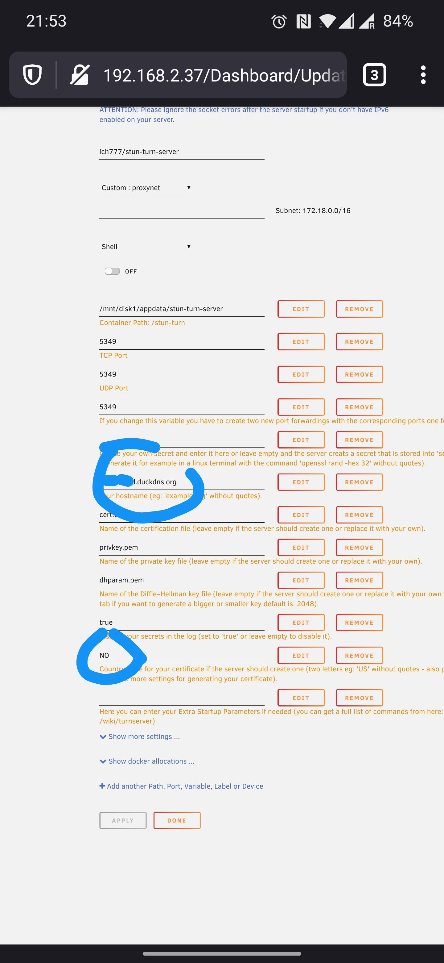

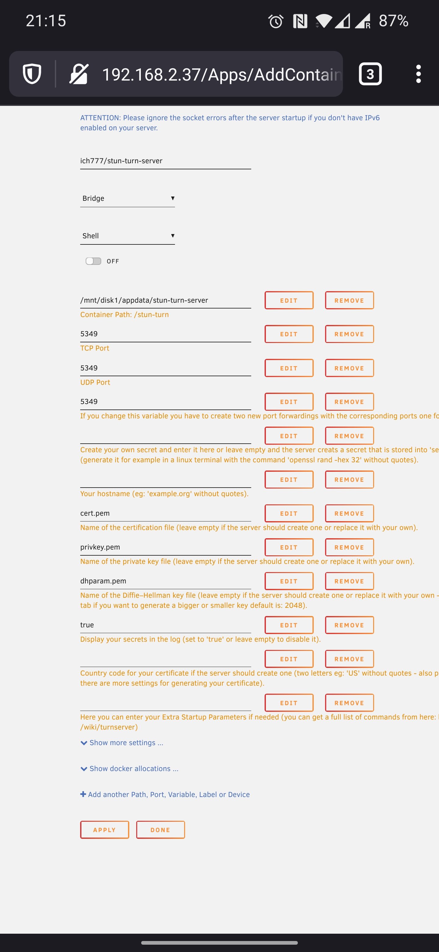

Please tell me how i have to fill up😃😃😃
i have setup my nextcloud by Spaceinvader video with let's encrypt no Swag docker.Do i need to fill up something in Advanced settings.
My Nextcloud and Swag docker's are on Proxynet network and should i put Stun-Turn server need also be on same network.
I forward ports on Pfsence.
I mean i dont know maybe how to configure it correctly because on 4G network outside me Lan not works on My android phones i cant ring and not getting messages.

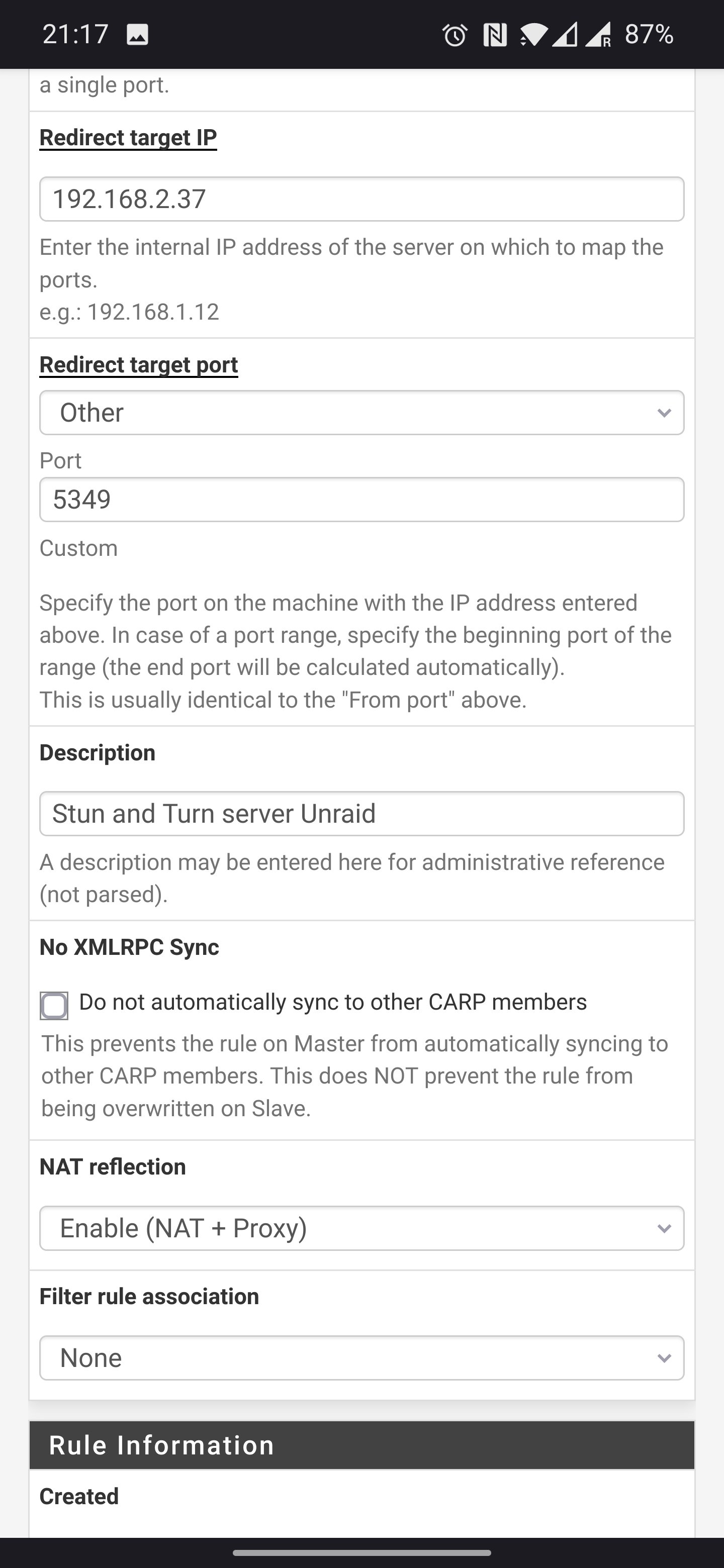

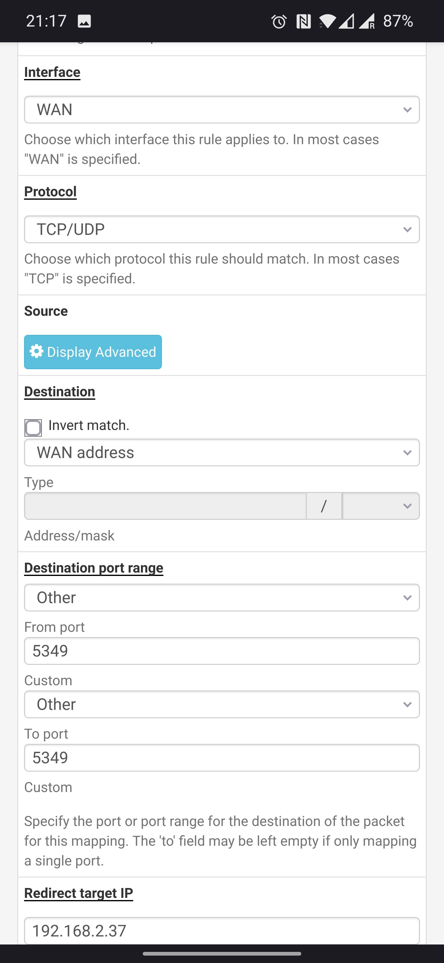

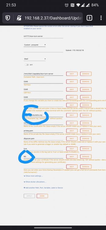

First of all you have to enter your domain name (please note I never tried that if you use DynDNS, DuckDNS or any other DNS service,...)

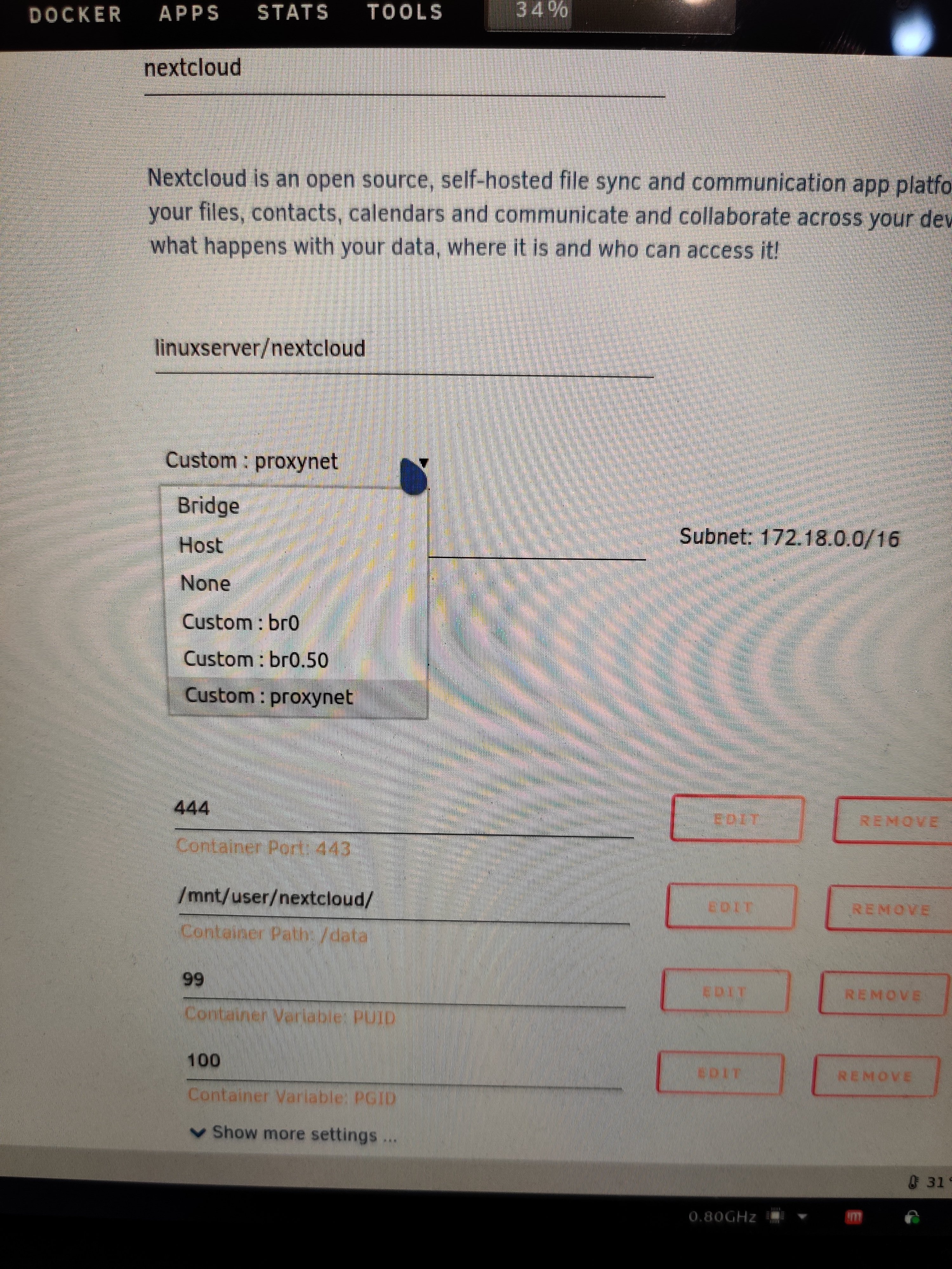

Sorry for asking what is Proxynet network?
You simply have to just forward the ports in Pfsense TCP/UDP and then you should be good to go. ;)

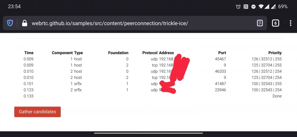

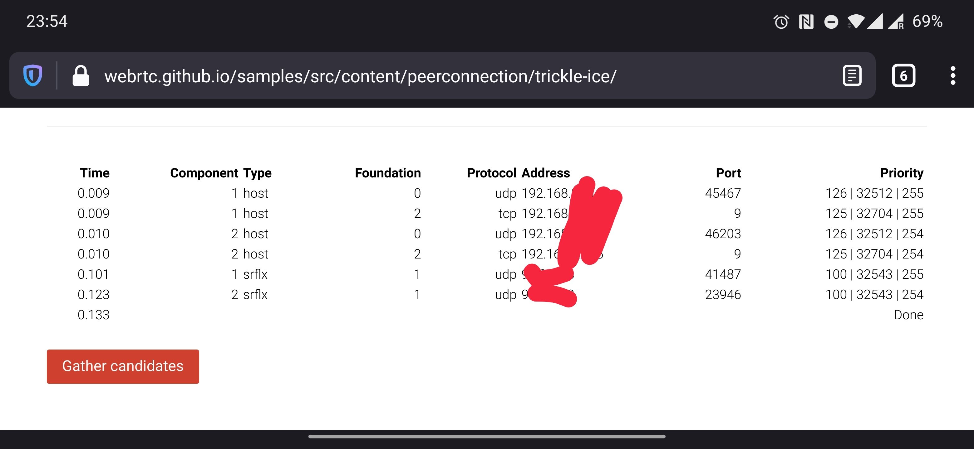

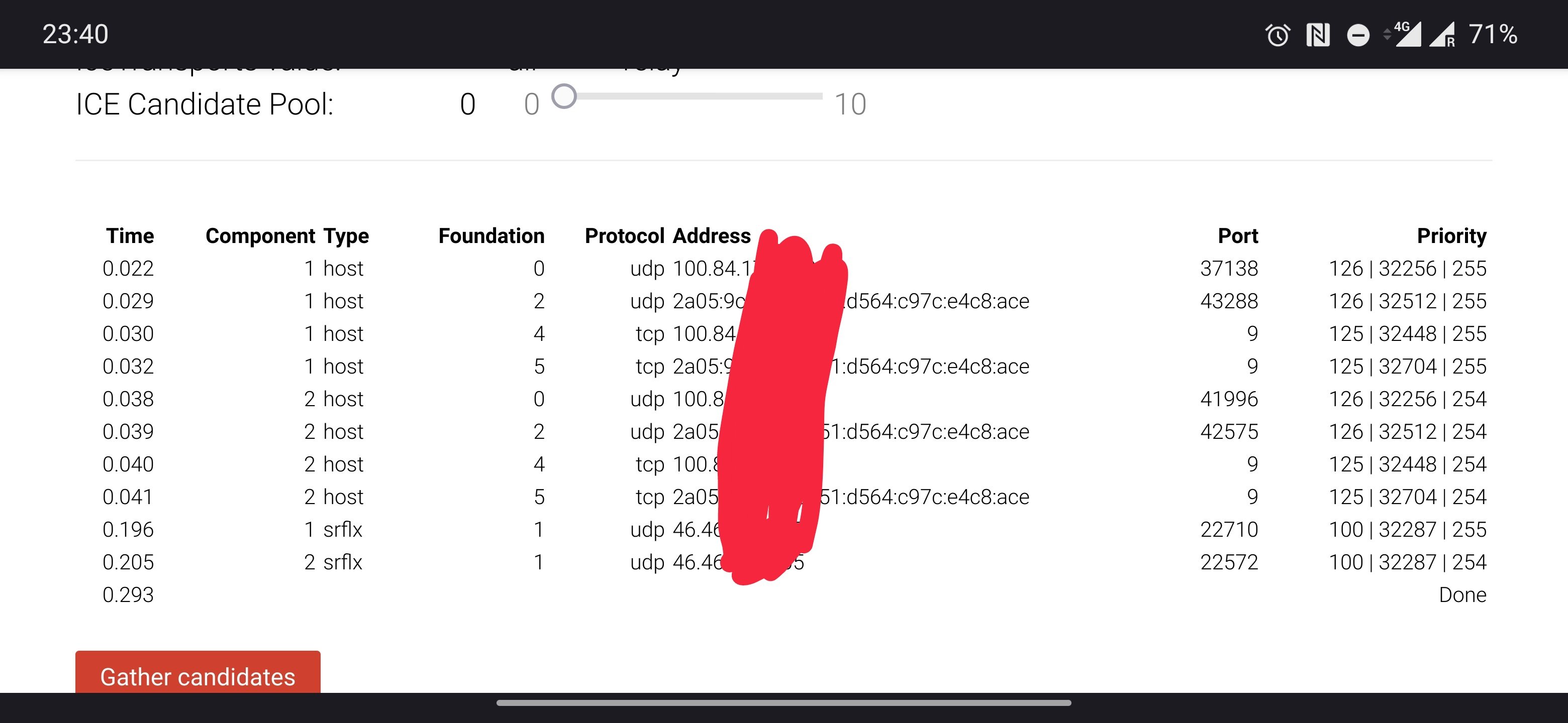

Then you can test your server here on this page:
https://webrtc.github.io/samples/src/content/peerconnection/trickle-ice/

First id like to thank you very much for helping me.
Proxynet is custom network in Unraid which i add and Swag and Nextcloud are using it i add a screenshot.
I use Mydomain.duckdns.org .
Edited by Vesko
Is it mean that now works.
