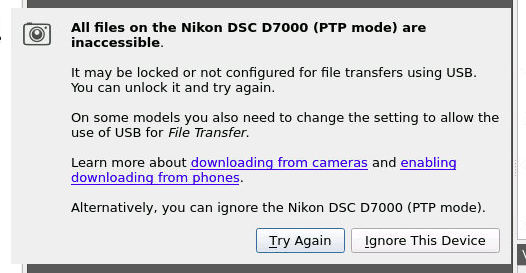

I've a problem with RapidPhotoDownloader,
Installation goes well, docker start too but when I plug my Nikon D7000 in a USB port it pop into RPD and I have this message :
I'm confused because I usually connect it to a raspberry with gphoto2 on it and everything works well !
In docker logs thre is this :

�[31mERROR �[0m Unable to access camera: GP_ERROR_IO�[0m
everytime I click "Try Again" the last line repeat.
Has someone ever had this issue ?
Thank you !!
Alex.
Thank you !!
Alex.
How did you mount the camera inside the container? With an extra startup parameter '--dev=' or did you mount the path to the camera directly in the template?
Is the camera in PTP mode (Picture Transfer Mode)? Seems like RapidPhotoDownloader is detecting that the camera is read only.

I didn't mout the camera into the container, when I connect usb, it pop in. In dmesg from the container console i can read this when I connect my camera :
usb 1-6: new high-speed USB device number 7 using xhci_hc
Futhermore, my camera is in PTP mode and I can't change it from it's menu, and if I connect it to my Windows machine it is R/W.
official help says :
Downloading from Cameras and Smartphones
Unlike devices like hard drives or memory cards, when a camera or smartphone is plugged into your computer, only one program at a time can access it (the same applies to any MTP or PTP device).
Because only one program at a time can access the camera or smartphone, if another program is using the it — Gnome Files, for example — where possible Rapid Photo Downloader will request the other program give up its exclusive control of it. For programs using Gnome technology (GVFS to be precise), that means "unmounting" or "ejecting" the camera / smartphone.
Edited by alesck
And there is the problem, the container can't simply access the device itself, you have to physicaly mount it somehow to the container (the container can see it but not mount or even access it.
I never tried to pass a device directly to a container but it should you should do it like follows:
Go into the template and add another path and set the container and host path to: '/dev/bus/usb' (also it is possible that you must enable Privileged, but I recommend you to try it out first without Privileged).
A Docker Container is an isolated image, it might see the device but can't actually connect to it only after you configured it right.
Also the 'Container' is not the same as 'your Computer'.
In unRaid Tools > System Devices > USB Devices my camera is present as :
Bus 001 Device 009:ID 04b0:0428 Nikon Corp. D7000
Unfornatly I've tried many configuration in privilege mode, none works.
share path (RW) /dev/bus/usb
share path (RW) /dev/bus/usb/001
share path (RW) /dev/bus/usb/001/009
share device /dev/bus/usb
share device /dev/bus/usb/001
share device /dev/bus/usb/001/009
I'm out of idea :(
I'm out of idea :(
I will try that as soon is i got time with a usb stick or something else (eventually my mobile phone).
What you can do is to import your folder on your unraid and then import it in RapidPhotoDownloader.
Or if you want to automate that process you can use the Unassigned Devices Plugin with auto mount and a copy script.
I don't think we can mount PTP or MTP devices without abstraction like lib-gphoto2, in fact that's the purpose of RapidPhotoDownloader.
Doese it show up in the Unassigned Devices on the Dashboard?
I cant test this since I don't have any PTP or MTP device...
I'm sorry but i don't know how other users been using it since on this container has at time of writing 7.7k pulls i think it should be working somehow but i can't help since i don't got such a device, eventually i look into it wich devices have this mode (my phone sadly not) and eventually i find a cheap device that i can buy to test.
Nop, nothing in Unassigned devices.
Any android phone is PTP or MTP (selectable in parameters beside Mass storage media (maybe in hidden developper menu in some cases)), any camera with PC link over USB should also be PTP or MTP.
I will try to install RPD in a graphical ubuntu VM to test USB passthrough .. maybe it will works.
On my phone not (I'm run a custom version of Lineage OS).
Yes that will work but for usb hotpluging you need to passthrough a whole controller to the VM as long as i know, also a VM is a little overkill for this... :D
Also now that you've mentioned it is a ptp device not listed under /dev/ptpX?
Try to create a new path with /dev and hand that over to the container (eventually try also to run it with privileged mode).
EDIT: Is there no option on the camera to use it as a normal usb drive (then the solution with Unassigned Devices should work).
Edited by ich777
