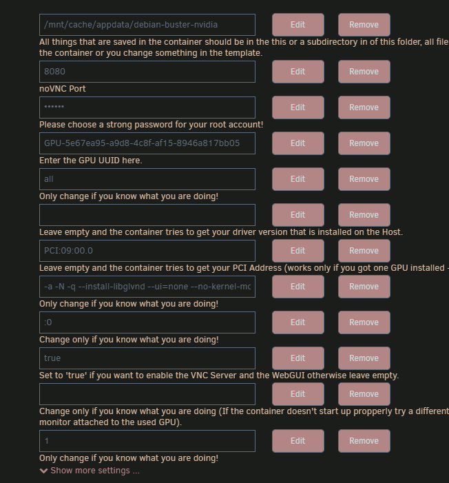

First of all thank you for this container.
My plan was to do without a VM with this container. This puts my home automation on a touchscreen. In order to save resources on eminem unraid I came across their container.
The installation went without a problem, but I can't get it with VNC and there is no picture on my monitor.
In the log file I see that the container always starts again,
unfortunately I can not see exactly what the problem is.
In one line I should change the resolution and the HDMI port in the "/debian/.config/container.cfg".
However, on the one hand, I don't find any .config in the folder and on the other hand, due to the constant restarts, my console is constantly closed.
So hope for help here.
Regards Maggi

You have to install the Nvidia Plugin from Linuxserver.io and then install the corresponding images and reboot your server.
It reboots because this variable is not configured properly: 'Xorg Dsplay Output Port' (or you simply have to leave it empty if you have a monitor attached)
You have to try out wich what for you.
EDIT: If you have a monitor attached please leave the fiel 'Xorg Dsplay Output Port' empty but also be sure that you don't use the primary graphics card from the BIOS with this container!
The line with the contianer.cfg is only there if the resolution is not set correctly and you want to set your own resolution or a different resolution.
2 hours ago, Maggi0r said:
I looked at that again. I installed the NVIDIA plugin and also installed and restarted NVIDIA UNRAID. But the mistake still seems to be the same.
Can you open a terminal and type in: 'nvidia-smi' and post the output?
But you have installed a nvidia graphics card in your server?
Also please provide the full output from the log.
EDIT: Found the problem, you've entered the wrong PCI adress or in the false format you have: 'PCI:09:00.0' but right it would be: 'PCI:09:00:0'
Edited by ich777
Ah ok thanks that was the error with the PCI BUS.
