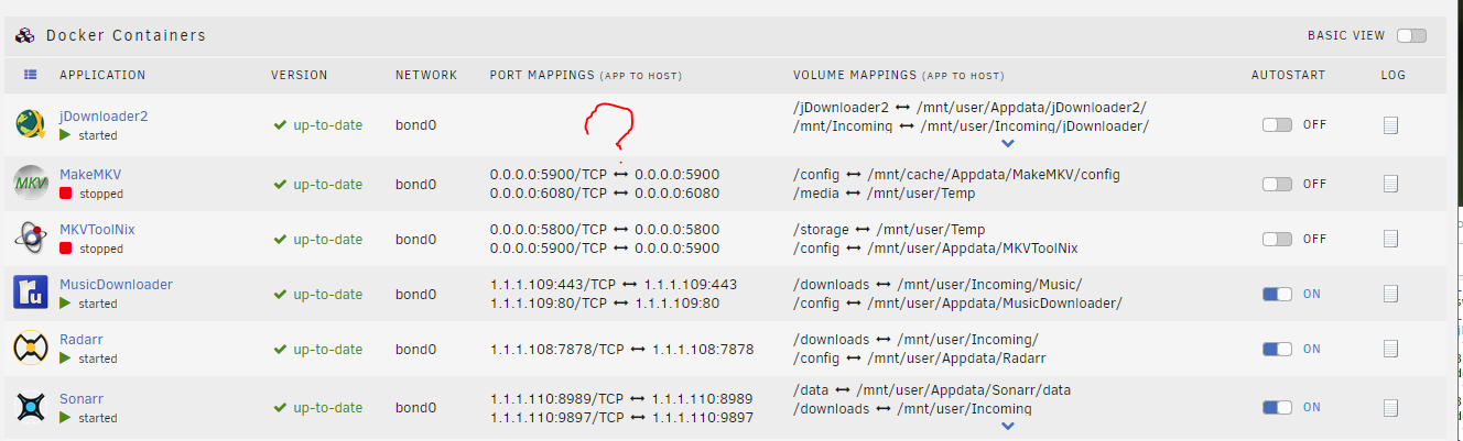

Because i didn't expose the ports in the Dockerfile, is it essential for you or doese something not work properly?
For the VNC_PASSWORD, i didn't even thought of this but if it works it's good :D
Edited by ich777
Not essential just doesn't look good in the gui, all works fine.
Is there any security advanced in not exposing the ports in the docker file?
Thanks and merry christmas!
Eventually, if i got two containers with the same port and someone is installing them it simply doesn't work (also other containers like Homeassistant also doesn't have ports exposed).

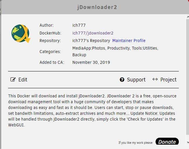

54 minutes ago, je82 said:
EDIT: Oh, i must ask, other docker containers i've used i can install multiple ones, but this jdownloader docker seems to be limited to just one? I would want to install a second one, why is it not possible? What i can do to fix that?
Don't understand the question, what's the error or what does not work, you can always install multiple instances (Please note that the ports must be different, the name of the container itself and also i recommend you to create another directory in the appdata folder).
If you can't download it again from the CA App then the answer is simple, you have to change the name of the installed container or a workaround is to go onto your Docker page in unRAID, click on Add Container select your jDownloader2 (change the name to 2ndjDownloader2 or whatever, change the portnumber, and make another directory in the appdata) done. ;)
Ah, so the name of the docker has to be different? I renamed the container from the original name of "jDownloader2" to jDownloaderX" just to test and i still cannot install another instance of this docker.
As you can see the docker tab tells me "edit" is the only available option to me, no install.
What could be blocking me more than the name?
Does the data dirr
Edit: Also renamed the Appdata path to "jDownloaderX" from jDownloader2 and the issue presists. Since i am using network type: bond0 and a unique ip for each docker, does the port really matter? I have the same port for multiple other "same dockers" with different ip no problem.
Edited by je82

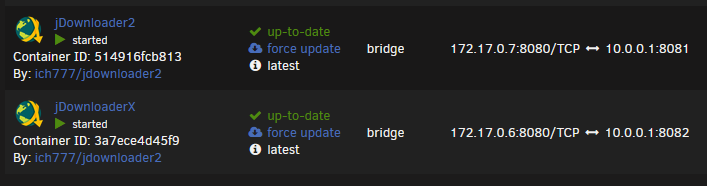

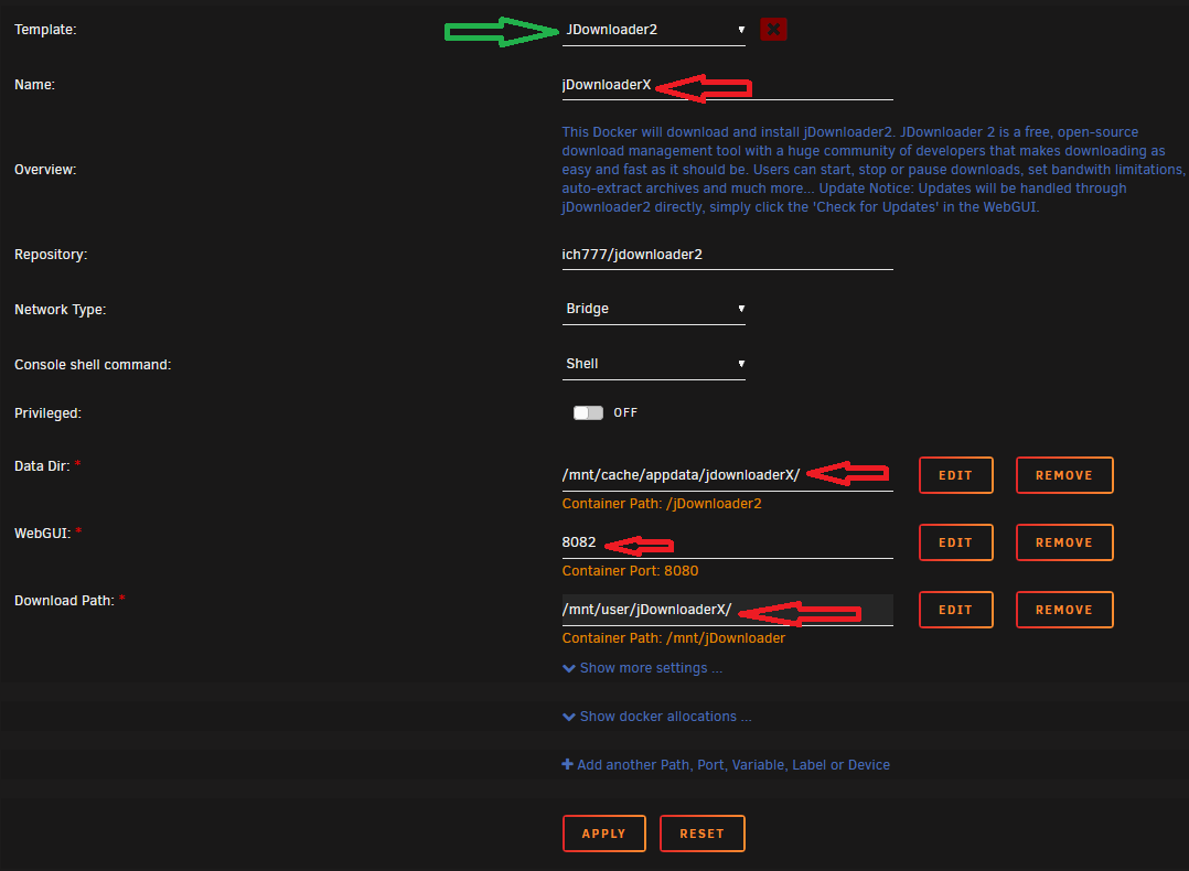

No you've got me wrong go to your docker page and click on:
Then select your existing jDownloader install (green arrow) and change the other settings (red arrows) and click on apply:
Now you've got two different running instances of jDownloader2:
ah i get it, ok, weird... other containers have been able to be installed multiple via the CA no problem, thanks for the heads up.
Edited by je82
Just now, je82 said:
ah i get it, ok, weird... other containers have been able to be installed via the CA no problem, thanks for the heads up.
Yes but you've installed it initially with the name that it has in the CA App and that's why, if you rename it in the first place you can always redownloaded it from the CA Apps.
You have to delete the my-jDownloader2.xml from your templates-user directory than it works again ;)
ah yes, you are right, the other containers i have renamed from the beginning. thanks for the heads up! :) it works fine now.
