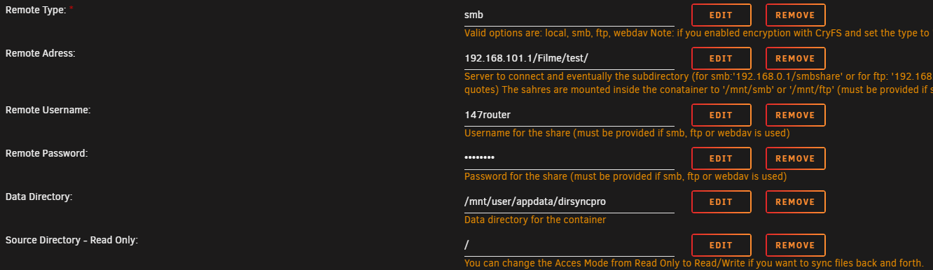

Hello,
I'm trying to use DirSyncPro to sycronise some folders on my laptop, unraid home server and an external HDD attached to my home router, all in the same network.
So, I have tryed to configure Remote Adress to see my router HDD share at least, but it is impossible for me.
This is my setup at the moment:
....but it ends in the following error, and VNC will not start:
---Mounting SAMBA share---
mount error(22): Invalid argument
Refer to the mount.cifs(8) manual page (e.g. man mount.cifs)
---Couldn't mount 192.168.101.1/Filme/test/---
Using "local" at Remote Type, I could start VNC, but could not see the network shares.
By the way, I have chosen port 8081 for VNC to start to "local", because 8080 did not work.
Plese show me what I'm doing wrong!
I will try...
I think you got another container with the port 8080 allready running that's why it doesn't work.
Can you try to only test it with: '192.168.101.1' without the full path (also please don't use the last '/' since this can also cause problems).
Can you access the share from another remote machine?
Have you any special characters in your password (please don't post it here), some special characters also can cause problems...

I have tried with:
192.168.101.1
[email protected]/Filme/testRouter/
192.168.101.1//147router/Filme/testRouter/
....and no avail.
---Couldn't mount 192.168.101.1---
I can acces the share from laptop, phone, binhex-Krusader docker, even from windows VM hosted by unraid.
I have no special characters to the password.

1 hour ago, costi147 said:
I have tried with:
192.168.101.1
....and no avail.
I want my work files synced to unraid and router drive. At the moment I can achieve this only manually through binhex-krusader.
The reason for backup to router is that if a blackout occurs and unraid machine will not start, I am sure that my HDD attached to the router will be online and give me access to my data, wherever I am, through VPN. This is verified.
I will look into this as soon as i got a little bit more spare time, in the meantime you can mount the share also with the Unassigned Drives plugin from the CA App and set it to 'Automount' (the share is then mounted to /mnt/disks/whatevernameyouchoose).
Set the container to local and mount the share that you've created as 'RW Slave'.
Start the container and it should now appear.
Thank you for your time!

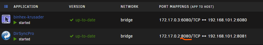

Can it be related to DirSyncPro using port 8080? Can I change it?
Nope you can't change that because i've hard coded that but thats the port inside the container and is via NAT mapped to the unraid host on port 8081 as you confiured it.
You can have 20 Containers with port 8080 inside the container and NAT them all to different ports on unraid.
I can't tell you what's wrong and why it's not working with Unassigned Devices but it should, the container has definetely a problem with the SMB mounts that can i say for sure but i can't investigate that in the next few days so you have to stick with Unassigned Devices for the time.
