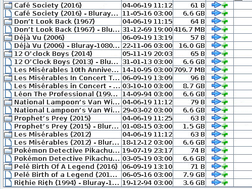

Does anyone have an issue with DirSyncPro when trying to copy files that have an apostrophe in it?  It seems like it can't read character and thus even if it exists on the destination it copies the file over changing the ' to a ą instead creating a second different copy.

See here.  The files are identical on both source and destination.
Sorry but the screenshot's that you attached from the folders show the same file or am i wrong?
It only displays it wrong in DirSyncPro itself or am i wrong?
Yes, they are the same.  But DirSyncPro copying a second copy of the file because it's reading the files with ' and -- in them as different.  I'll do a test on a few files and show you what the result looks like.
So I just did a test Mirror A -> B incremental with the file I screen shot above.  The folder and file are identical on both servers, but it copies a new file over and I wind up with a duplicated directory and second file with the changed character on the destination.

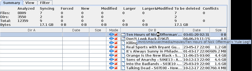

Is this only the case for files with the ' bevore the . from the file extension, i see that it reads other files with an ' right but the only one with the â is the one with the ' bevore the .
Can you try this Then Hours of Nick Offerman's "YuleLog"?
I think it has something to do because the ' is at the end.

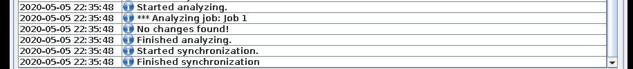

I can't reporduce the error, everything copys just fine and if i click a second time on sync nothing will sync anymore:
Click on sync for the 2nd time:
