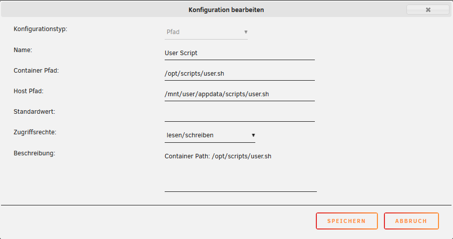

Why don't you run the games with proton? All games I've tried run with it.
Here is an example script: user.sh
I would recommend to create a folder called scripts in the appdata directory itself, then put the script in it (this basic script that I've provided does a 'apt-get update' to get all the latest packages and then installs nano with 'apt-get -y install nano' don't forget the '-y' switch otherwise it won't install the packages.
After that go in the template from the container and create a new Path with this configuration (you have to type in 'user.sh' since you can't directly click on it):
Hope, this makes sense, if you got any further question please feel free to ask again ;)

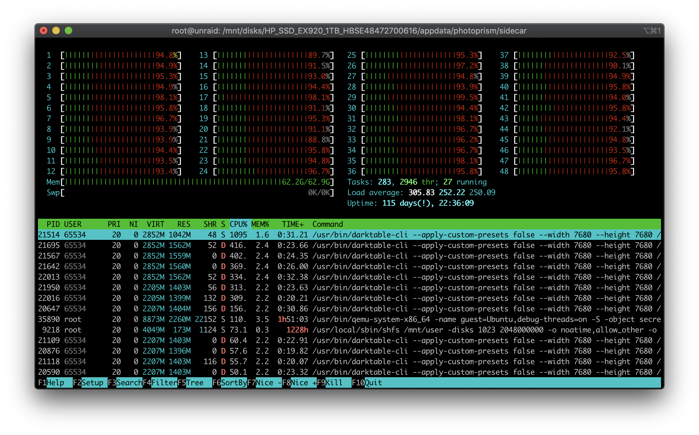

Thank you very much for the photoprism docker!
Feeded it with my last 5 years raws folder, never seen this load before, haha :)
