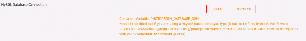

Hi everyone,
I have failed miserably with many attempts to setup mariadb and photprism on unraid. Are you able to share a step by step guide? assume I am an idiot.
6 minutes ago, epicurean said:
Hi everyone,
A quick Google search brought up this:
But I would recommend skipping Step 4 from the Reddit tutorial and put in the credentials here (please read the description from the variable):
Hope that helps, I also think that @Sycotix has also made a Youtube video on this.
Thank you Sir! For the mariadb part. do I setup that docker first, or the photoprism first?
Appreciate if steps for mariadb (with regards to photoprism) also explained. Thanks again!
Like the Reddit post tells you, first the MariaDB, because Photoprism needs a Database that it can connect to.

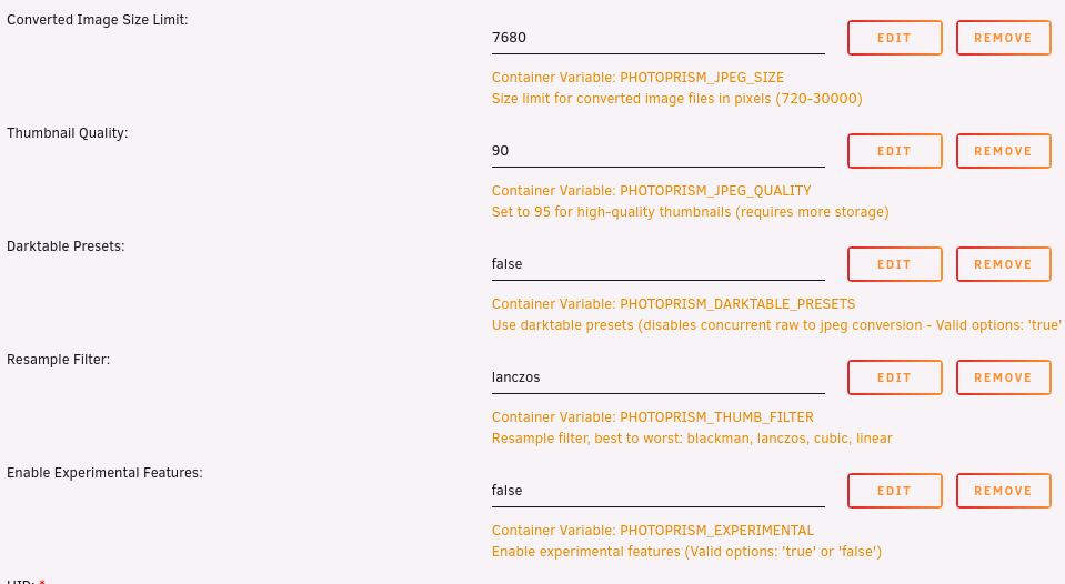

I used your PhotoPrism App to get the PhotoPrism as Docker configured in my unRaid.
Works like a charm.
With the newest Release all the variables were changed in the config and have a prefix PHOTOPRISM_.
Do I need to edit the complete config manually or did you already update the app that I can skip this?
Until now there was no update available from your app, so I presume I have to edit the config manually - correct?
I don't understand since all the variables in the template already have the prefix "PHOTOPRISM_"
For example:
Also please note, this is not my Docker container, I've created only a template for unRAID for the official PhotoPrism Docker container.
No, not all, for example UID and GID. And others are no more available in the newest Docker compose. Please have a look here: https://dl.photoprism.org/docker/docker-compose.yml
I am just not sure what will happen if I update the docker container with a new image.
