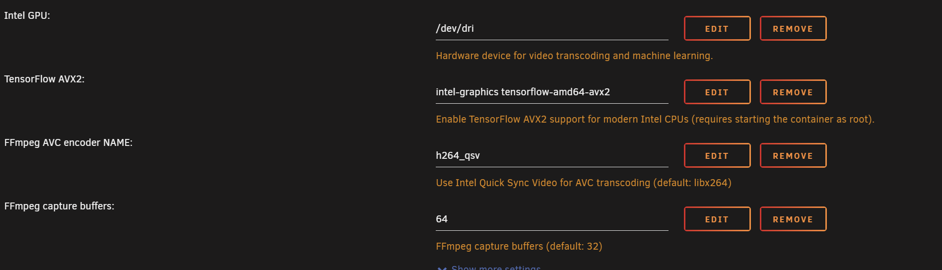

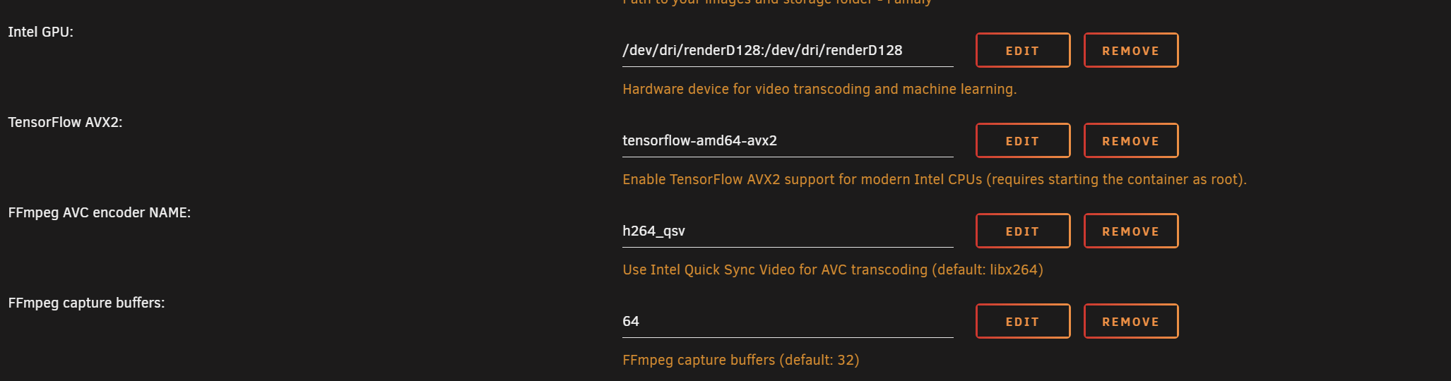

@ich777Should we use 2 Devices for IGPU or only one ? :
devices:
- "/dev/dri/renderD128:/dev/dri/renderD128" # Intel GPU
- "/dev/dri/card0:/dev/dri/card0"
For what exactly?
I would strongly recommend to pass through the device /dev/dri:

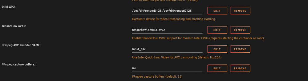

36 minutes ago, ich777 said:
For what exactly?
Sorry i forgot , its for PhotoPrism ,
i added
PHOTOPRISM_INIT: "tensorflow-amd64-avx2" is working and when only first time container start i have message about starting avx2.
but for gpu they write :
Optional hardware devices for video transcoding and machine learning:
# devices:
# - "/dev/video11:/dev/video11" # Video4Linux (h264_v4l2m2m)
# - "/dev/dri/renderD128:/dev/dri/renderD128" # Intel GPU
# - "/dev/dri/card0:/dev/dri/card0"

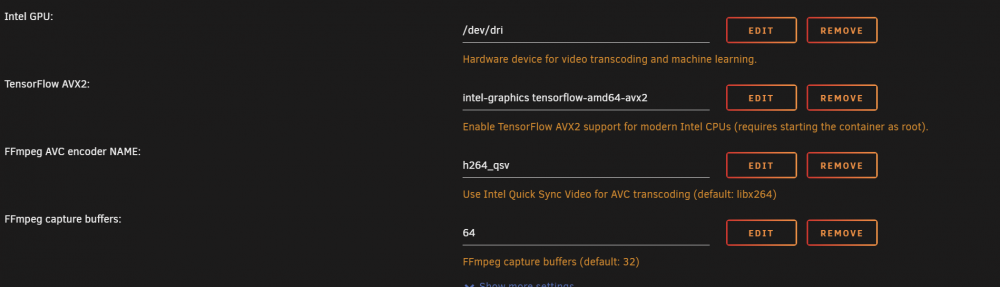

Do it like in my example above, this will basically expose the whole /dev/dri device which includes renderD128 and card0.
Please keep in mind don't pass this through as a path, you have to do that as a device like in the example above.
You don't have to user /dev/dri:/dev/dri
OK thanks , i saw now i forgot "intel-graphics tensorflow-amd64-avx2" instead "tensorflow-amd64-avx2"...
Thanks again for this cool container, next spteps they should add Multi user support :)

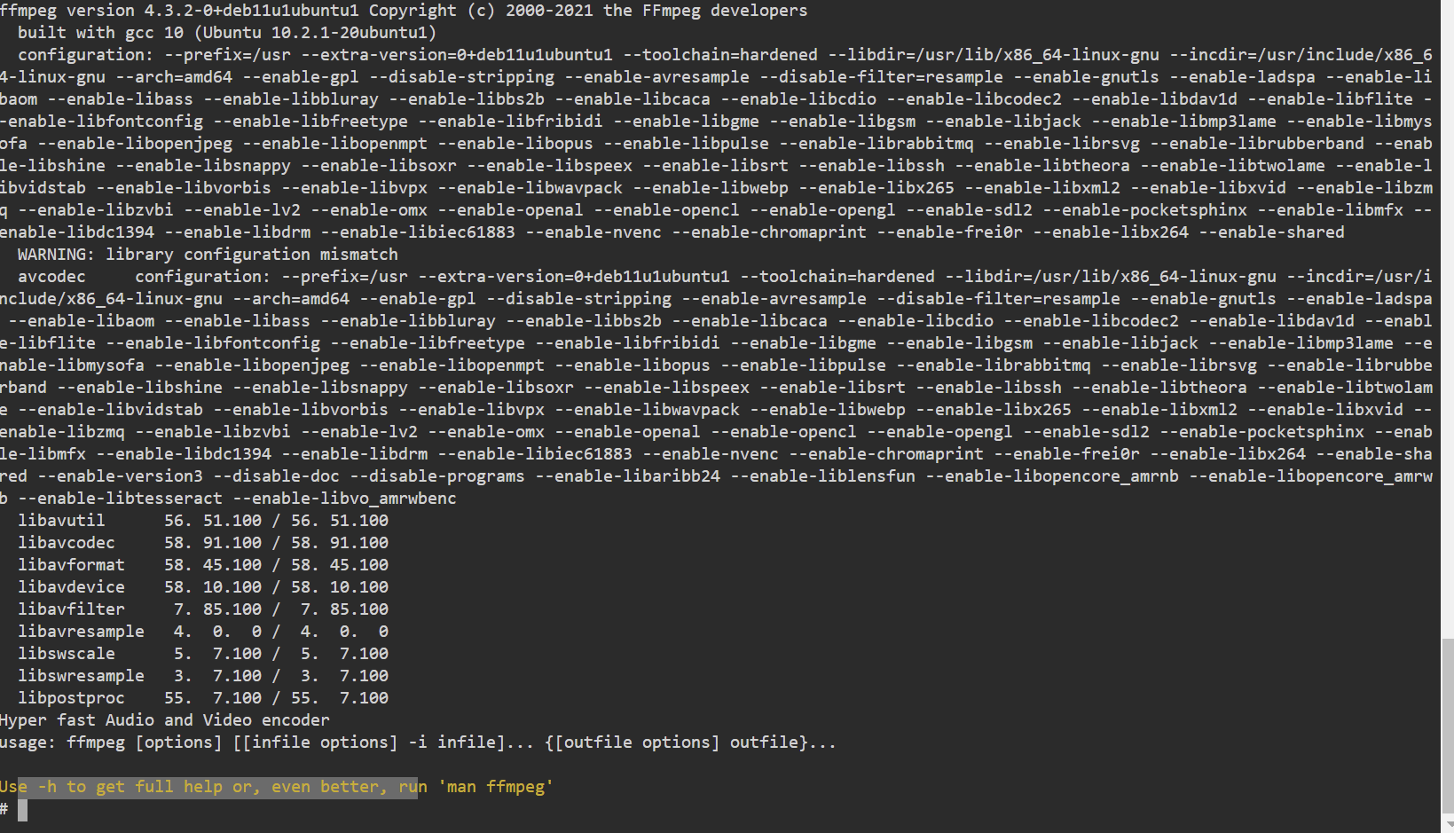

@ich777 forgot to ask maybe you know i was some warning in console ffmpeg also befor IGP added to container :
WARNING: library configuration mismatch
is my config right and having iGPU enabled ?
Please see this issue here: Click
Also keep in mind this is not my container, I've only created the template for the official Photoprism container. ;)
Yea i know , sorry for bothering im fist time trying setup iGPU to container and ffmpeg , i thought maybe you know about it...
5 minutes ago, Masterwishx said:
sorry for bothering
No worries, but it would be best to search for this specific error on the Photoprism Github.
