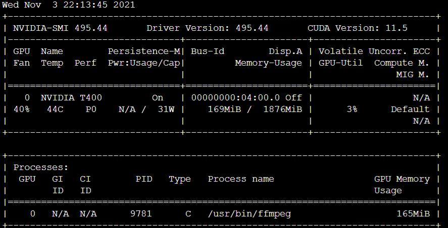

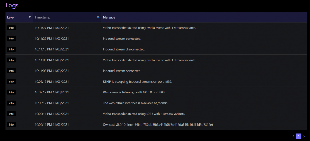

@joroga22 I think the GT710 is not compatible, tried it now with my Nvidia T400 and it works just fine.
Docker Log:
---Preparing Server---
---Starting Server---
time="2021-11-03T22:09:11+01:00" level=info msg="Owncast v0.0.10-linux-64bit (737dbf9b1a444b0b7d415da819c16d74d3d7812e)"
time="2021-11-03T22:09:11+01:00" level=info msg="Video transcoder started using x264 with 1 stream variants."
time="2021-11-03T22:09:12+01:00" level=info msg="RTMP is accepting inbound streams on port 1935."
time="2021-11-03T22:09:12+01:00" level=info msg="Web server is listening on IP 0.0.0.0 port 8080."
time="2021-11-03T22:09:12+01:00" level=info msg="The web admin interface is available at /admin."
time="2021-11-03T22:11:08+01:00" level=info msg="Inbound stream connected."
time="2021-11-03T22:11:08+01:00" level=info msg="Video transcoder started using nvidia nvenc with 1 stream variants."
time="2021-11-03T22:11:13+01:00" level=info msg="Inbound stream disconnected."
time="2021-11-03T22:11:27+01:00" level=info msg="Inbound stream connected."
time="2021-11-03T22:11:27+01:00" level=info msg="Video transcoder started using nvidia nvenc with 1 stream variants."
Owncast Log:
nvidia-smi output:
13 minutes ago, xorinzor said:
I tried multiple values, but none seem to work.
You have to reboot in between, since otherwise it won't work properly.
Is this the only graphics card in your system?
Is there any command to figure out what displays (if any) are available?
No, usually 0 is the default one and that should always work except if the container crashed or some other unusual thing happened.
I think you also have tried different values at DFP_NR or am I wrong?
As said above I would try to play around with the DFP_NR variable and reboot every time you change the value, I know this is a tedious process but I can't think of another way to do it.
Maybe something about AMD is preventing this from working correctly, that's just a wild guess from me, but in terms of Virtualization they are a little behind Intel from what I read here on the forums, but that should have nothing to do with this container but maybe it affects it in some way.
Hm okay, will have to do some more digging then.
It's indeed the only GPU in the system.
I have not yet tried different DFP_NR values since the error really seems to be specifically about what display it's trying to use. (ie; the DISPLAY variable).
AMD could very well be a bit behind in virtualization, but the old xeon CPU is from 2009, whereas the 5900X from 2020. I sincerely hope they managed to catch up on the difference over all those years😅
I'll just do some more digging, also with other docker containers to check if it's limited to this container, or if others are affected too.
Thanks
AMD could very well be a bit behind in virtualization, but the old xeon CPU is from 2009, whereas the 5900X from 2020. I sincerely hope they managed to catch up on the difference over all those years[emoji28]
Thanks
I think the best bet would be DFP_NR since these are actually the output ports and this corresponds to the display output, if the container doesn't find the DFP_NR or better speaking the output port the X Server would also fail and complain about that display 0 is not available because well the output port is not found, very oversimplified and I also hope that makes a little sense to you... :/
