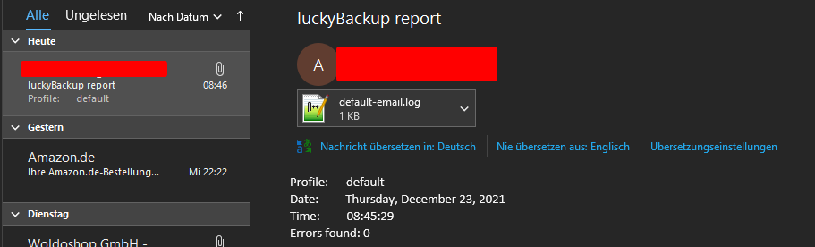

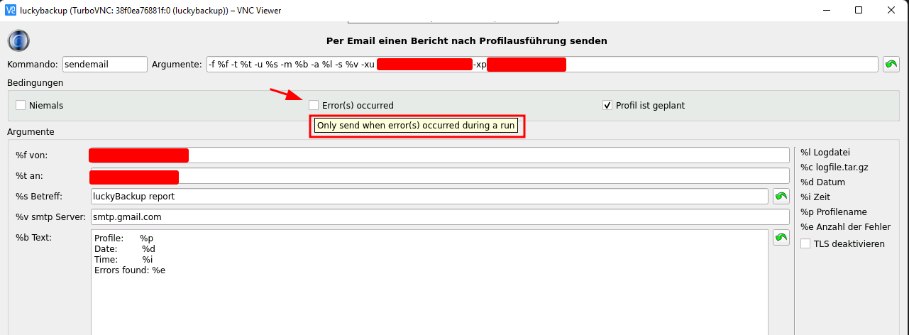

I have set the email config for SMTP notifications in LuckyBackup, and the test is OK. But, I didn't get the email after the task execution. What I'm missing?
Thank you.
What is checked at this option:
From what I know it should work just fine because I've implemented sendmail after a user request because I don't use it.
Exactly as the screenshot. In the logs I don't see any error.
Thanks in advance.
aint this checkbox (in the middle) mean "only when errors occur ..." ?
Thanks in advance.
ok, made some tests now
those checkboxes are limiting sendmail
- never (never send a mail)
- Errors (only send when errors occur)
- Scheduled (only sent when a scheduled run ...)
like this (all disabled) there will always be a mail sent, also testing manually ...

Ok, thanks. I will try with any checkbox.
Good point @alturismo, actually it is:
I think when this box is checked the "Profile is scheduled" is ignored if you got no Error(s).

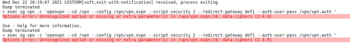

Hello sorry if I am at the wrong place, I want to understand a problem I am facing for the OpenVPN.
I am using: OpenVPN-client maintained by @ich777. I updated the vpn.ovpn file today to change the location and now when I restart the docker, I get this error.
seems like something different in the new ovpn file. can you suggest any resolution?
Thank you,
Technically it's maintained from dperson here.
Seems like something changed within the vpn.ovpn file.
Someone already created an issue for that: Click
The container needs to be updated, I also would recommend that you comment on that issue too.
If no one responds within a week feel free to contact me again and I will fork the repo and see what I can do in terms of updates. :)
Seems like that the container needs an update from OpenVPN to v2.5.0+

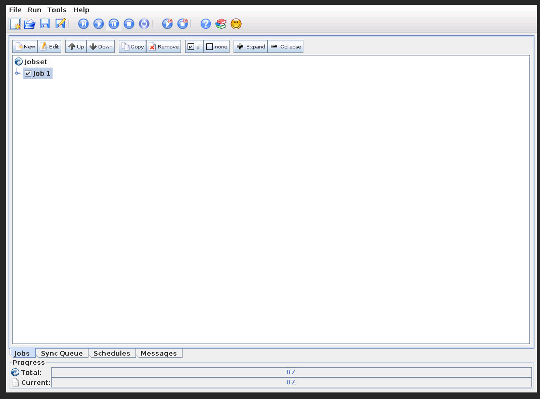

DirSyncPro.log
Does anybody have this issue and knows how to fix it?
thanks in advance!
Edited by ich777
put log into file to not bloat the thread
Something is really wrong with your container.
Please try to delete the container, the dirsyncpro folder from your appdata directory and grab a fresh copy from the CA App.
Hi, thanks for the help!
I removed the container and the folder from appdata having always the same results. The weird thing is that is was working as usual a week ago.
really don't know what to do
I've updated the container because I found a bug but that should have nothing to do with your issue here.
When I grab a fresh copy from the CA App it works just flawlessly.
11 hours ago, fadudba said:
Directory '/run/screen' must have mode 777.
This message seems like you have some issue with Docker itself because usually that's a path inside the container and if you pull a fresh copy it should fix itself but if not there must be some other issue. Have you changed anything to your server recently? Have you yet tried to reboot your server?
Here is the log output from my fresh grabbed container: dirsyncpro.log and here a screenshot:

I think that my error was not click on Profile/Save...
Thanks!
