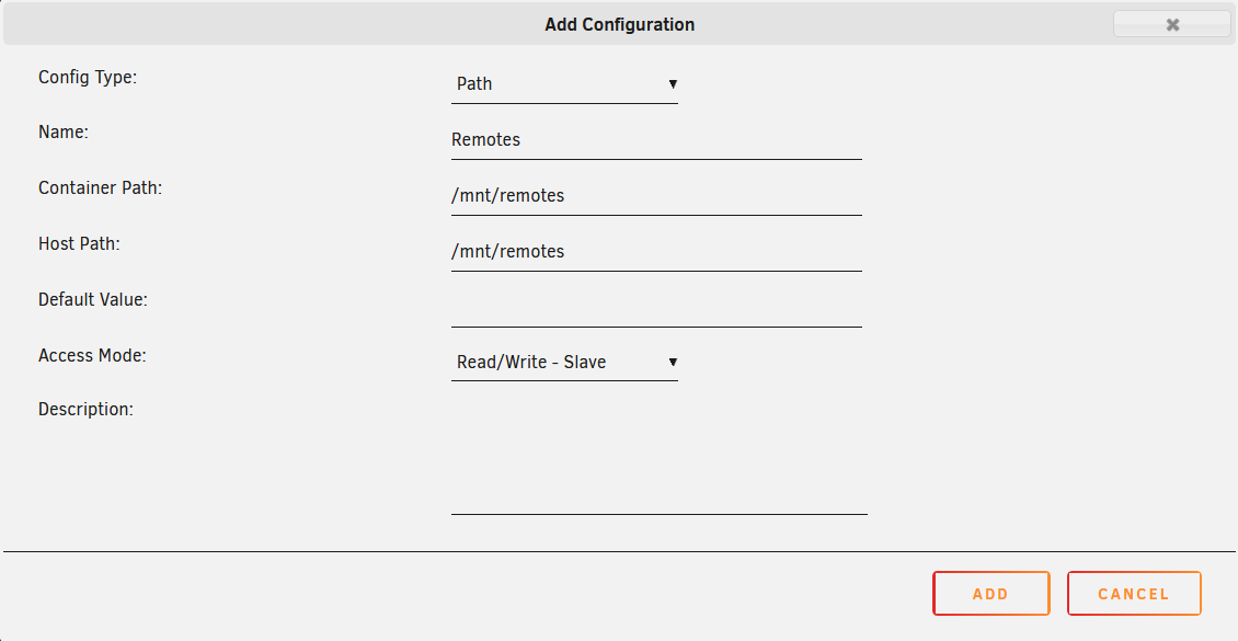

I want to use Krusader to move files from a previous unRAID server to a new unRAID server.  I have the remote drives mounted under the web UI in unRAID and I can see them in a bash prompt at /mnt/remotes.  How do I get these to show  up in Krusader?
Or is there a better way to transfer large amounts of data?
Add a path like this in the template for Kursader:
You will then find it in the folder /mnt/remotes in Krusader.

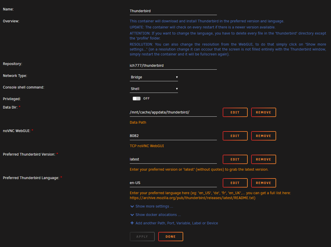

Having a little trouble getting the Thunderbird docker to work.  I have it setup like so:
I get the following output in the log:
---Checking if UID: 99 matches user---
usermod: no changes
---Checking if GID: 100 matches user---
usermod: no changes
---Setting umask to 000---
---Checking configuration for noVNC---
Nothing to do, noVNC resizing set to default
Nothing to do, noVNC qaulity set to default
Nothing to do, noVNC compression set to default
---Starting...---
---Version Check---
---Thunderbird v91.4.1 up-to-date---
---Preparing Server---
---Resolution check---
---Checking for old logfiles---
---Checking for old display lock files---
---Starting TurboVNC server---
---Starting Fluxbox---
---Starting noVNC server---
WebSocket server settings:
- Listen on :8080
- Web server. Web root: /usr/share/novnc
- No SSL/TLS support (no cert file)
- Backgrounding (daemon)
---Starting Thunderbird---
[GFX1-]: glxtest: libpci missing
[GFX1-]: glxtest: libEGL missing
(thunderbird:105): GLib-GIO-WARNING **: 17:30:21.927: Failed to execute child process “update-desktop-database” (No such file or directory)
The log putput looks good.
These messages are just warnings since there is no HW acceleration in the container available and I doesn't ship the libraries for that to keep the container as small as possible, but that won't stop the container from working.
I use the Thunderbird container on a daily basis.
Do you get an error message when connecting to noVNC? If yes, please post a screenshot.
Have you yet tried to empty the browser cache?

I'm an idiot! I just tried the WebGUI and it worked. I was trying to connect with a VNC client.  Thanks!
