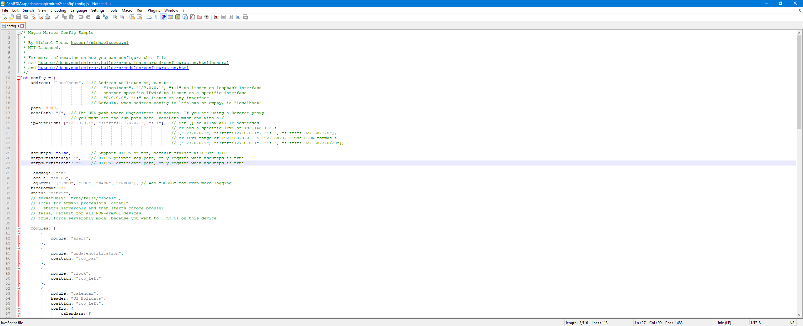

Hi guys,
I've just installed magicmirror2 with default settings, copied the default config over but am not getting the display up in a web browser. The only thing I've changed is the port it bridges to as I already have something set to 8080. Is there something else that needs to be done to make it work?
Cheers

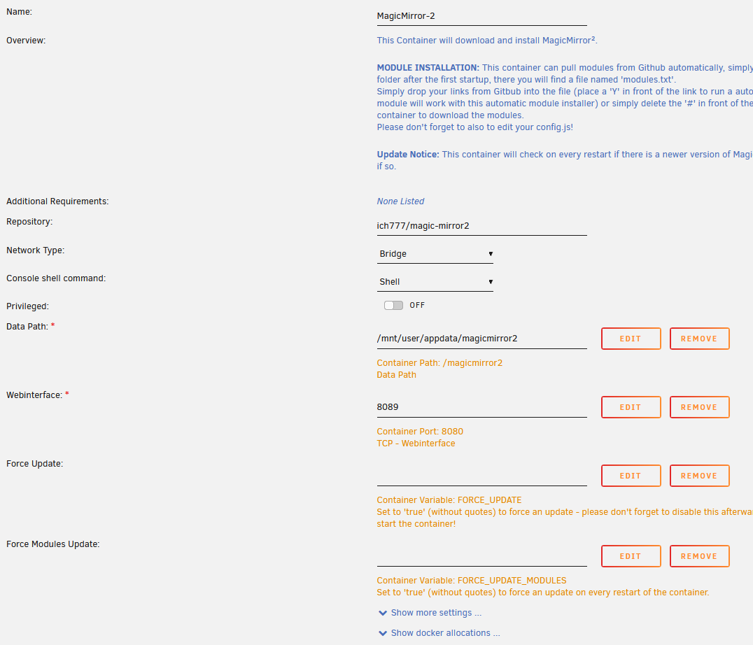

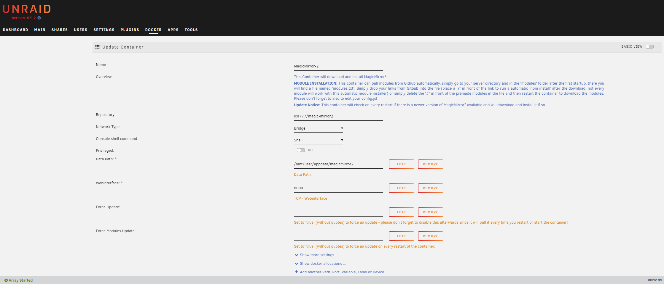

You don't have to change the settings file in order to do that, simply change the port in the Docker template and leave as it is in the config.
Thats what I did, I think? - screenshot attached
Can you post the log output from the container?

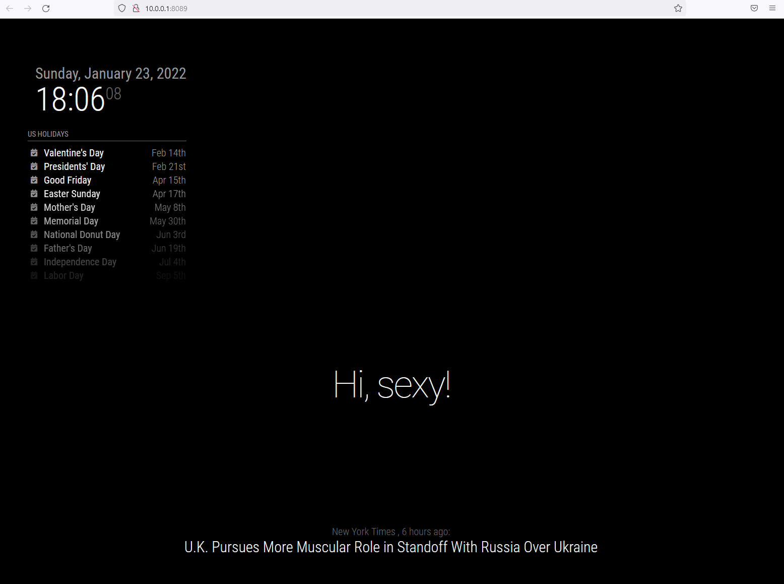

2 hours ago, mjvracing said:
Ready to go! Please point your browser to: http://localhost:8080
From what I see in your log it should work just fine.
I've also tried it now on my own (also with port 8089) but I cant reproduce your issue: magicmirror.txt
When I connect to: MYunRAIDIP:8089 I get the usual start page:
Please double check that you are connecting to: yourunRAIDIP:8089
Thanks for taking a look. Everything looked correct to me as well, having run MagicMirror2 on Ubuntu before this all looked the same. I'll do some testing. I'm definitely navigating to myunRAIDIP:8089
I would recommend to maybe start over, delete the container, delte the 'magicmirror2' folder in your appdata directory and pull a fresh copy from the CA App.
Could be only a small issue since it starts on my server just fine. :)
