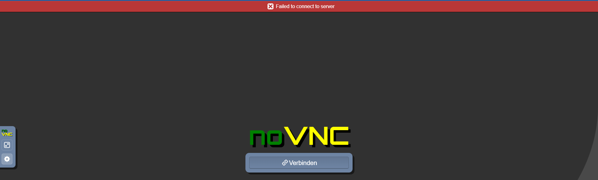

BUT: i tried to proxy the port 10000 (where the webui is) out to debian.mydomain.com
the vnc page appears but i cant connect.
Internal works fine but when i try to access from outside  it looks like the attached picture.
any idea where to check whats the problem ?
You also have to websocket, you can find a example for nginx here: Click
Please also make sure that you've have at least httpwd or something in front of it because only the VNC password is from my perspective not enough in terms of securing it.
The above linked example has also a basic-auth file in it that you have to configure first in your reverse proxy application (SWAG, Nginx Proxy Manager,...).
Thank you it was indeed the websocket.
I will take a look onto the httpwd ... good point thanks.

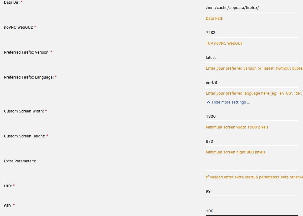

Been using the firefox container for some time, updated it and now I am getting an odd issue where it can't install firefox?

Just now, TexasUnraid said:
How do I figure out what went wrong or install firefox manually?
Can you give me a screenshot from your template?
Or better speaking what language variable are you using?
Should be all default settings besides the port.
Edited by TexasUnraid
7 minutes ago, TexasUnraid said:
Thank you!
The description in the container seems wrong replace "en_US" with "en-US" and it should work again, changed the description too.
Before you do this please force a update from the container itself (turn on the Advanced View on the top right on the Docker page and click grafik.png.f7a3c1b344d063ab3e51ab54ffeb34bd.png, don't forget to turn of the Advanced View after the update is done because it produces a little load on your server).
Ok, did a force update and that solved the firefox install issue but now getting a new error:
