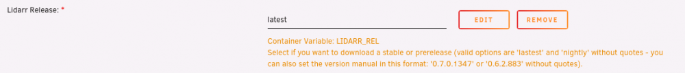

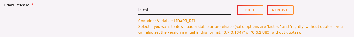

Please try to change the install tag to 'latest' instead of 'nightly':
I would recommend that you first delete the container and also the lidarr directory that was created in your appdata folder.
OK, I deleted the lot and started again.  It works with latest.  Thanks.

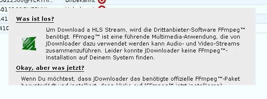

When a link from tvthek.orf.at is put into Jdownloader2, there shows up a Window about ffmpeg, which i can not close. 😛
(Sry, screenshot is in german)
HLS streams are segmented streams and cant be downloaded just like that ... specially if they use ABR and/or AR ...
so even if ffmpeg would be installed you would get a remuxed stream in "some" quality, depending on your startup bandwith ...
so i wouldnt recommend to download a HLS stream via a downloader app like this ...
Simply press "ENTER" when this message appears and it will install FFmpeg.
Btw. no problem since I'm from Austria I can read it. :D
