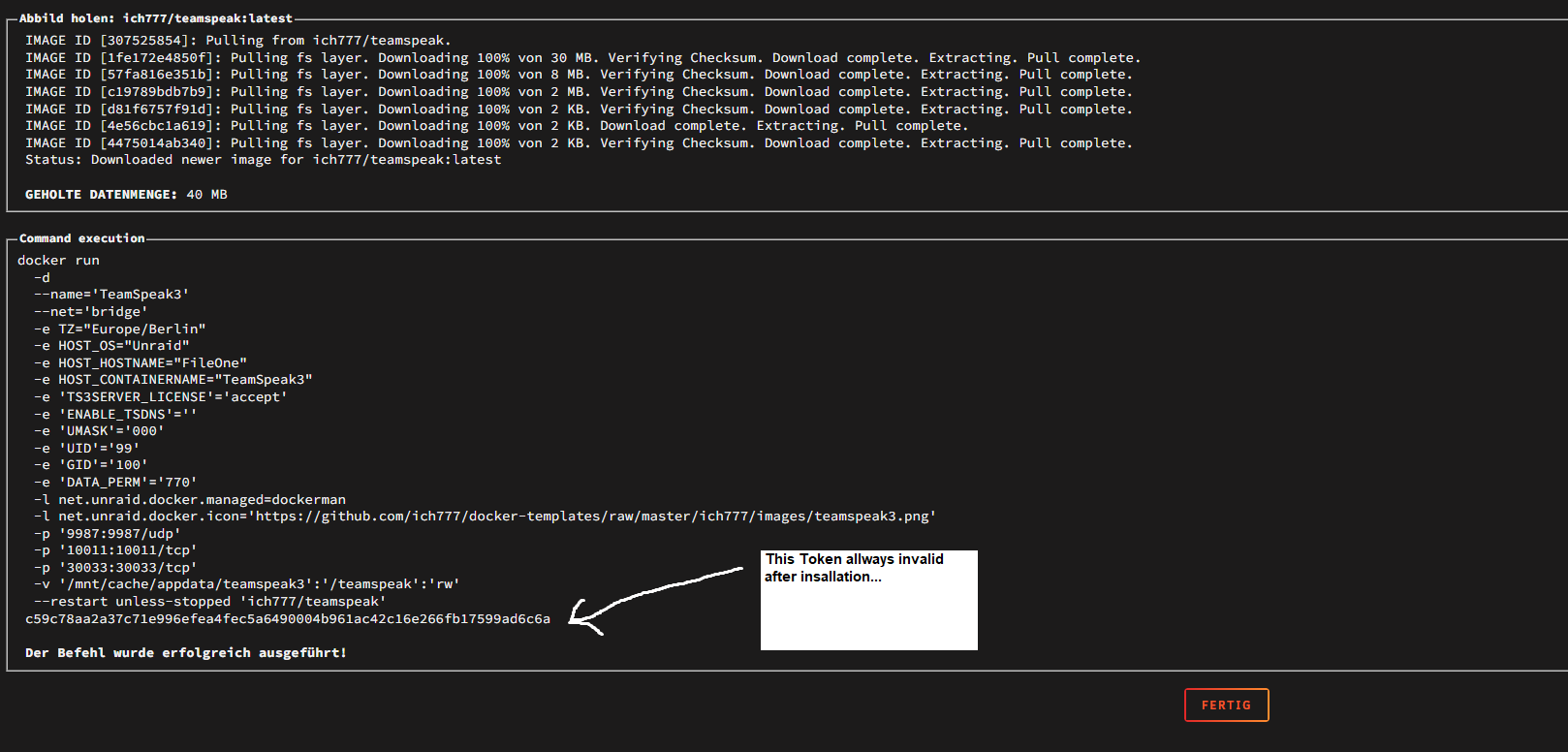

Hi
I have a problem with the Teamspeak3 docker.
After the installation i copy the token but always i login he says it is the wrong or invalid.
What do i wrong...
I try it 10 times :_(
Please help
Thanks !
41 minutes ago, Keeper666 said:
Please help
Because this is not the Log and this is therefore not the Token.
Please remove the container again and also the folder that got created for teamspeak that lives in your appdata directory, pull a fresh copy from the CA App and then, after the container started click on the icon and select Logs:
Ok now i understand thank you it works perfect !!! 🙂
