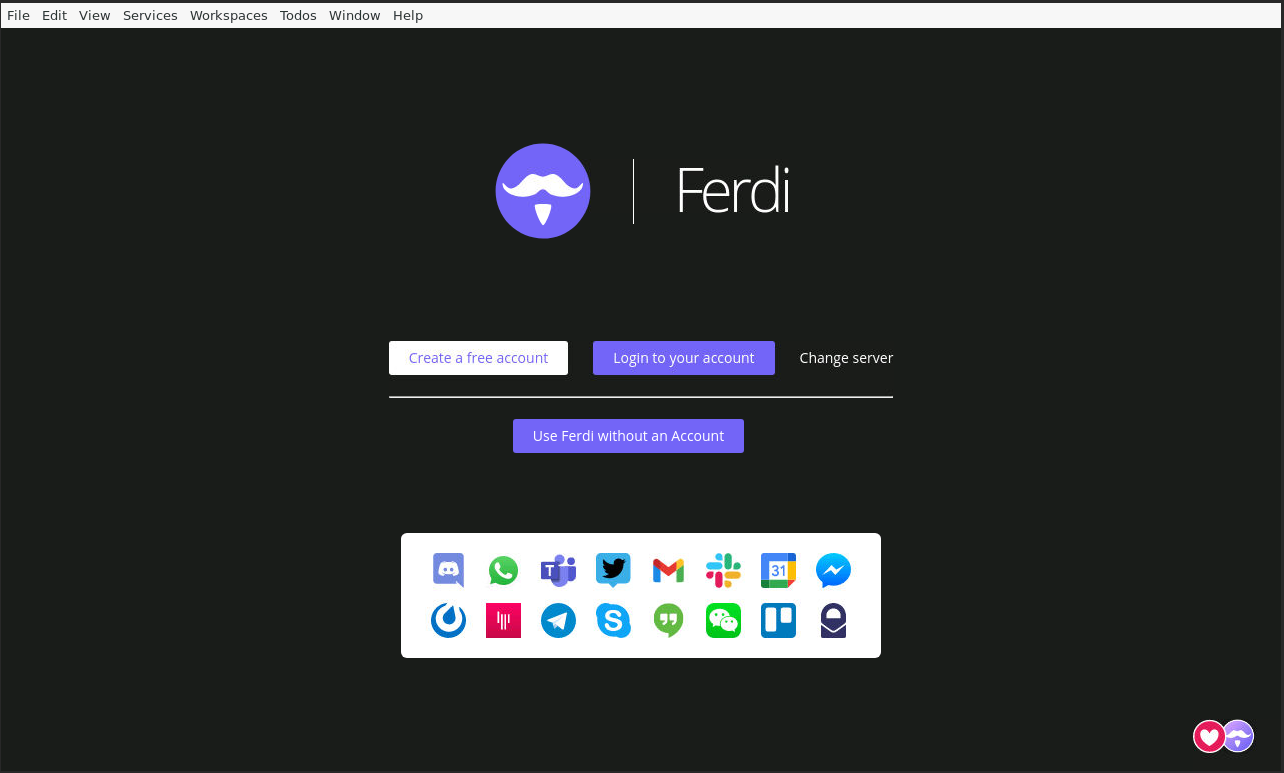

The Ferdi-client container does not start anymore after using latest image. Any news on this ?!
Gesendet von iPhone mit Tapatalk
I will take a look at this and report back.
EDIT: No issue over here, what does the log say? With what settings do you run Ferdi in the template?
just want to give the feedback, everything is now as expected.
may it was a DNS problem in my end. @ich777 ill apppiciate your effort and fast feedback!

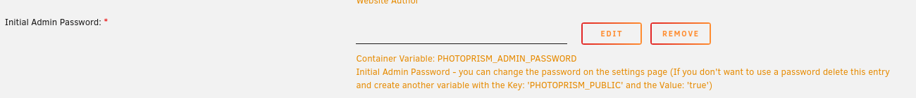

HI there, for PhotoPrism, what is the default user? I can't seem to initially login. I'm using the internal database in your image.
text  error  warn  system  array  login
time="2022-11-06T12:31:34-06:00" level=info msg="PhotoPrism® needs your support!"
time="2022-11-06T12:31:34-06:00" level=info msg="Visit https://photoprism.app/membership to learn more."
time="2022-11-06T12:31:34-06:00" level=info msg="migrate: executing pre migrations"
time="2022-11-06T12:31:34-06:00" level=info msg="migrate: executing main migrations"
time="2022-11-06T12:31:34-06:00" level=info msg="webdav: /originals/ enabled, waiting for requests"
time="2022-11-06T12:31:34-06:00" level=info msg="webdav: /import/ enabled, waiting for requests"
time="2022-11-06T12:31:34-06:00" level=info msg="server: tls disabled"
time="2022-11-06T12:31:34-06:00" level=info msg="server: listening on 0.0.0.0:<port> [4.706171ms]"
started 221105-jammy as root (amd64-prod)
init: updating filesystem permissions
PHOTOPRISM_DISABLE_CHOWN="true" disables permission updates
Problems? Our Troubleshooting Checklists help you quickly diagnose and solve them:
https://docs.photoprism.app/getting-started/troubleshooting/
file umask....: "0002" (u=rwx,g=rwx,o=rx)
home directory: /photoprism
assets path...: /opt/photoprism/assets
storage path..: /photoprism/storage
config path...: default
cache path....: default
backup path...: /photoprism/storage/backups
import path...: /photoprism/import
originals path: /photoprism/originals
switching to uid 99:100
/opt/photoprism/bin/photoprism start
I don't see any errors, I just don't know what username to use on the `<ip>/library/login` page.
Edited by paperblankets
You have to set it here in the template (I think it must be at least 8 characters long):
It was the username I could not figure out, but admin worked. 🙌
