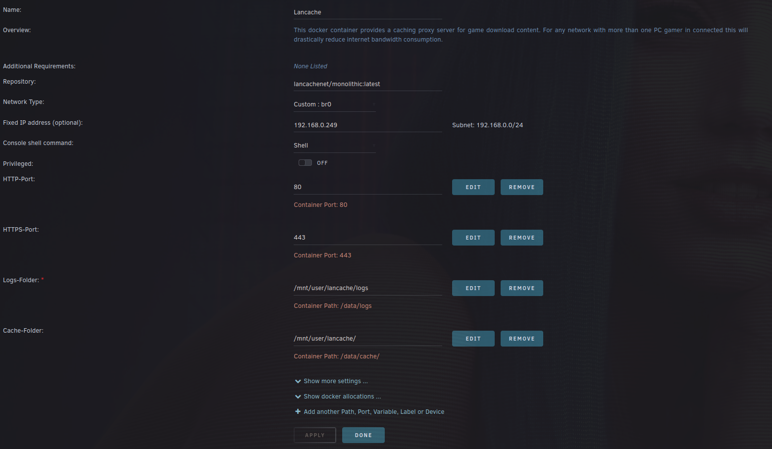

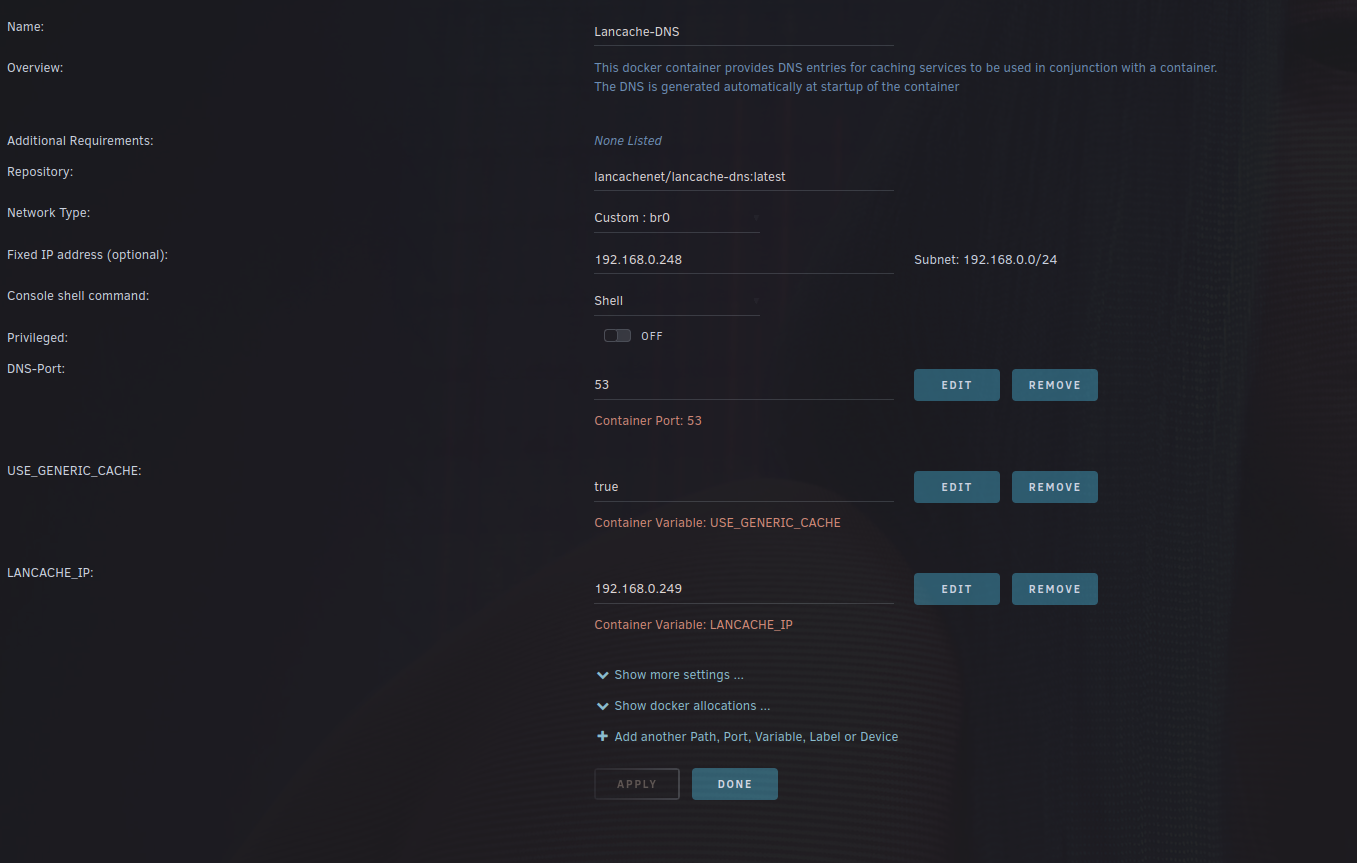

Please also post screenshots from your LANCache templates, to what is your appdata share set in terms of Use Cache in the Share settings?
Attached images, the lancache share is not set to use my cache drive, it writes straight to the array.
I would recommend that you set the cache to /mnt/user/lancache/cache since this is the default folder structure for lancache but it should not harm anything in your case.
I've set the pre-fill container to /mnt/user/lancache/cache/ which essentially does the same thing, I think! Docker directory mappings always trip me up.
