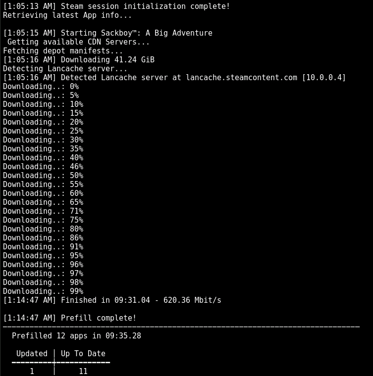

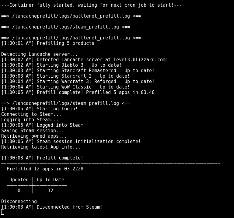

I checked my log and everything runs as expected:

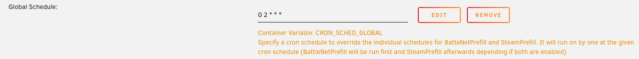

I don't know if you've already seen it but I've implemented another variable that makes it possible to define a global schedule and this will run BattleNetPrefill and afterwards SteamPrefill at a given schedule.
This schedule will override the other schedules if defined.

This morning I accessed the container via ssh in order to manually trigger the prefill. It downloaded 1 game but nothing of this is in the logfiles.
After this I just restarted the container to trigger the "prefill on start" and the log that I access via the unraid web UI shows this:

---Force update enabled!---
[2022-11-17] Starting SteamPrefill
[11:08:22 AM] Starting login!
Connecting to Steam...
Logging into Steam...
[11:08:24 AM] Logged into Steam
Saving Steam session...
Retrieving owned apps...
[11:08:24 AM] Steam session initialization complete!
Retrieving latest App info...
[11:08:26 AM] Starting Warhammer: Vermintide 2
 Getting available CDN Servers...
Fetching depot manifests...
[11:08:27 AM] Downloading 58.55 GiB
Detecting Lancache server...
[11:08:27 AM] Detected Lancache server at lancache.steamcontent.com [
192.168.188.5]

[11:43:33 AM] Finished in 35:06.10 - 238.81 Mbit/s
[11:43:33 AM] Prefill complete!
  Prefilled 6 apps in 35:11.50
   Updated │ Up To Date
      1    │     5
Disconnecting
[11:43:33 AM] Disconnected from Steam!

steam_prefill 20221117-1136.log
50 minutes ago, zAch523 said:
Like for example the container ran tonight until 1:05. This is the end of the content of the logfile
I see nothing that is cut off here, at least not in the file that you've posted.
Is maybe CA Backup running which is turning off your LANCache container while the LANCache-Prefill is running?
It seems that only the output of the container start and the cron jobs is logged to file. Whenever I open a terminal and connect to the docker container, nothing that happens is logged to the file.
Yes, but that is actually the same if you connect to any container and would do it like that because simply you are overriding how the logging function is working...
If you start for example a process in another container which is spiting out some log this won't be redirected to the container log and/or also maybe not to a log file but this is a fairly common behavior.
Yes, as explained above this is common behavior.
As you can see, I has some of the text from tonights run at the end of it...
Could this have to do with accessing the container via terminal? Could this break the logging somehow?
No, this is because tail displays the last few lines from the already made Prefill from the Force Prefill and only shows up in the log but not the log file, maybe I will change that too. <- I changed that already to avoid further confusion but this is only a cosmetic thing and won't affect the functionality from the container (please update the container, again...).
Again, your log file is totally fine, the only thing that you should really take a look is your log files in the "logs" directory...
