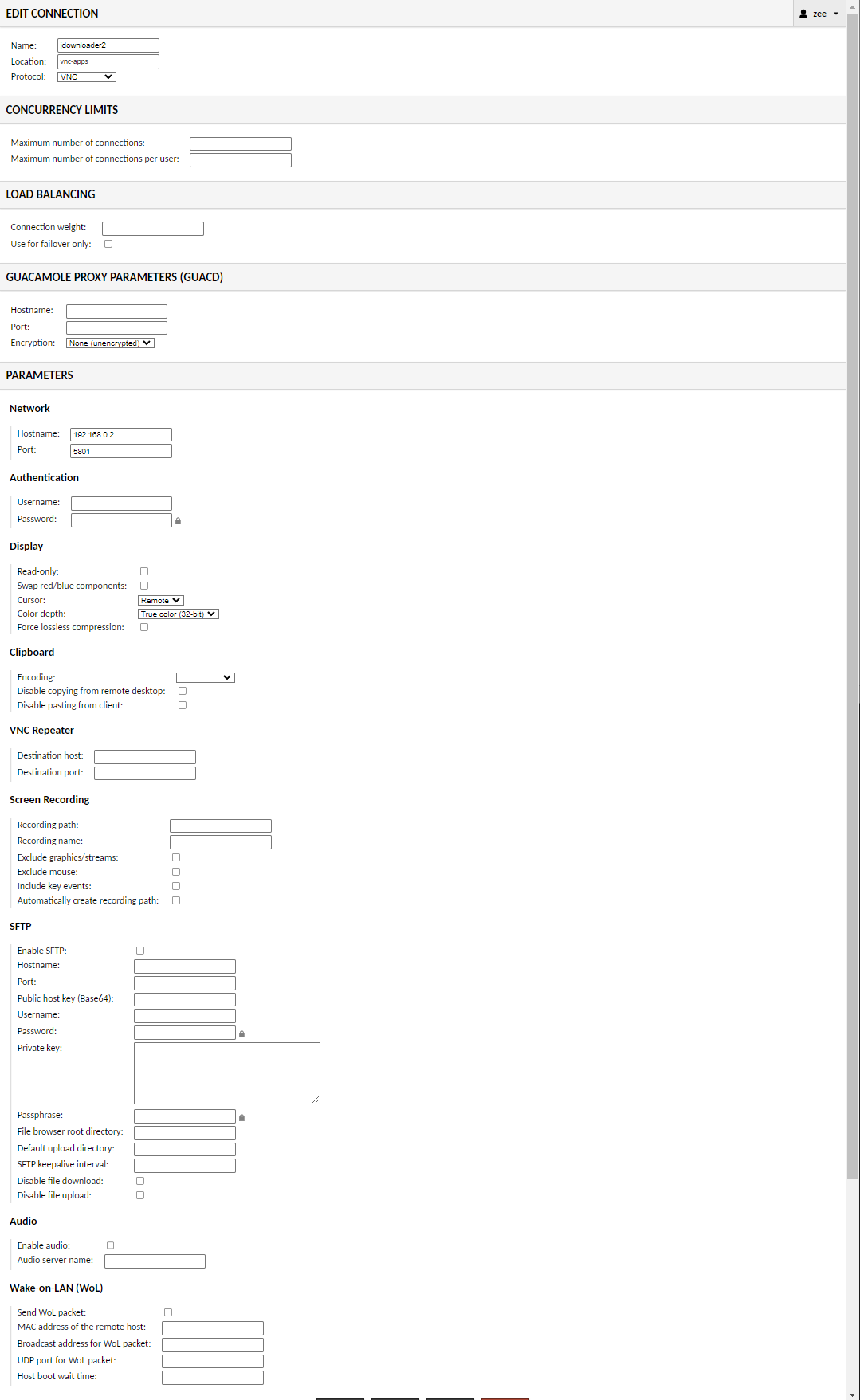

Is there any way i can remote into jdownloader2 from apacheguacamole? i set the correct ip and port in guac and that doesnt work.
guac should work fine, you are sure you use the right port ?
VNC native and not the VNC http port, also as its a http service anyway, you could just set this behind your RP itself too ;)
You have to create another port in the template with the container port set to: 5900 (this is the RFB port where you can directly connect to the VNC server) and as the host port whatever you want (I recommend setting it to something like different like 9991 or something like that <- this is then the port you want to connect to with Guacamole).
 this got me one step closer, thanks! i now only get a gray screen with the cursor visible. here are my guac settings. anything i should change here?
EDIT: worked after a refresh :)
Edited by mangojuus
I think Guacamole is not the best when it comes to resizing IIRC but I could be very wrong about that because I don‘t use it.
Anyways, glad to hear that it is working now.

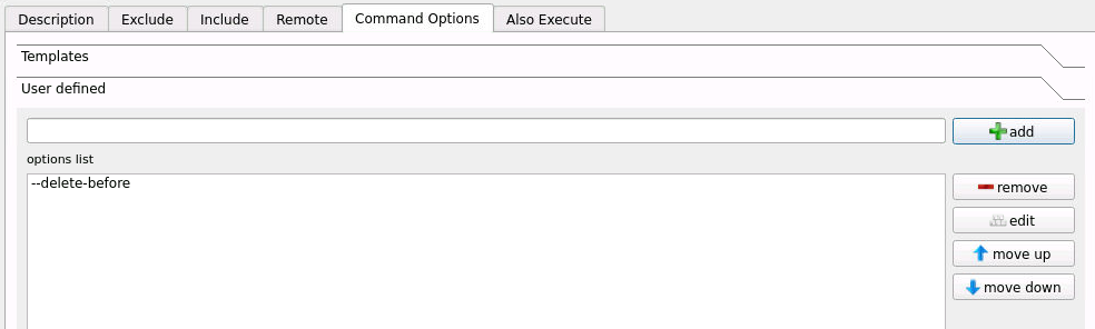

I don't know if I'm in the right place, but I have a question about luckybackup.
Is there a way to make it delete files first in a backup task instead of at the end of it? I keep running into the problem that my backup drive runs out of space. Both the backup drive and array are the same size, but it keeps overflowing because it only deletes files at the end of the task.
Yes, modify the task, click on Advanced, go to Command Options, click on User defined, type in: --delete-before and click on add
This should then look something like this:
Also make sure that in the Command Options at Templates the option: Delete files on destination is disabled because you override this with --delete-before.

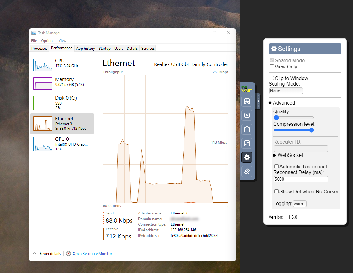

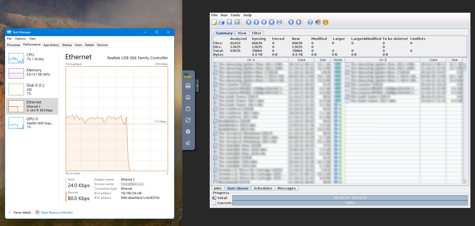

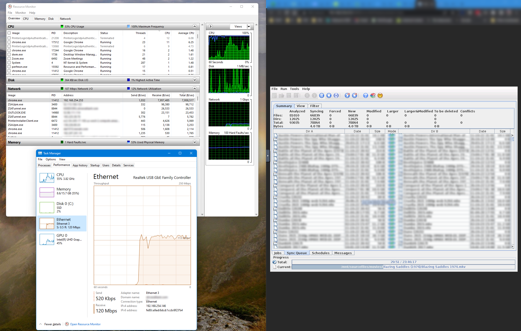

Hi everyone,
Sorry if this has already been covered. New to unRAID and this app.
I thought today i'd give DirSyncPro a try to backup all my media from unRAID to another NAS box. I setup my job and kicked off a sync. After a minute or so I noticed the fan on my laptop go into high gear. "Well that is strange, i'm not doing anything intensive." Popped open task manager and chrome is doing a ton of receiving traffic. I closed the tab that was watching DirSyncPro and usage dropped. Attached is a screenshot of it in action.
I'm a little baffled why this is happening. I get the impression the file transfers are going THRU my machine. Which makes no sense of course. Perhaps there is a setting to adjust? Or could it be a byproduct of vnc in the tab to DirSyncPro?
Yes, because if a lot is going on on the screen it has to render it in the web browser which is not really efficient, you should always close the noVNC window if it is copying something.
Oh, have you changed anything in terms of quality in the side menu from the noVNC window?
No, this is definitely not the case (and not possible) because otherwise your transfer speed would be painfully slow, the screenshot that you shared above with 120Mpb/s translates to about 12MB/s.
If you watch the sync, regardless of which application we are talking about, through noVNC it is always a bit more demanding because there is usually a lot going on on screen.
CPU usage seems a bit high but since you didn't include which Laptop or better speaking which CPU you are using I really can't tell if that's appropriate.
Don't forget, the more it has to render the more CPU and Network usage will be displayed.

Hey ich777,
Thanks for the super speedy reply. I'll go in reverse order of your quotes. 2nd reply, "Doh! sorry meant to say the CPU of my laptop watching DirSyncPro, not the unRAID CPU." No worries about the server cpu, its an E3-1270 v5 and 32GB of ram.
1st reply. Ah gotcha, that does make sense. I'm just surprised at how much the traffic drops on my laptop viewing DirSyncPro. From 120 Mbps to <100 Kbps. Dropped another screenshot of that. I have not adjusted any quality settings for noVNC. I wouldn't mind though tweaking it to a bit lower. It's a backup utility I don't care about visual quality. lol
Simply click on the side menu, then the gear icon and then you should have sliders where you can increase/decrease the Compression (more compression -> higher load on your server) and increase/decrease the Quality (better quality -> higher load on the server).
😮 idk why i didnt see those sliders before! This is fantastic. I tweaked them and boom! under <100 Kbps while its displaying a sync.
Actually different from the screenshot, now i have quality and compression left. I watched task manager go up and down as I moved them.
Thank you very much!
