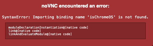

Suddenly I am getting this. Can it be because I run 6.12.0.rc2?
I see no errors in the docker log file.
Please see this comment:

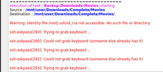

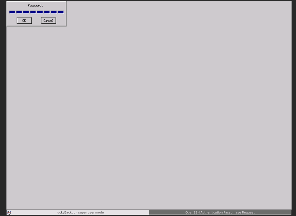

I'm having some really strange behavior this morning with LuckyBackup (still on 6.11.5).  A backup should have run this morning but didn't.  I tried to run it manually, but the ui is really slow and froze a couple time.  I had to restart the docker, and was able to get back to the main page, but when i try to run a manual backup, it goes to a password page
At one point i was able to click Super User Mode at the bottom and saw a bunch of red text, i tried to get a screenshot, but couldn't in time before switching back to the password page.
I believe it said something about ssh key in red, but not 100% sure.
Your source and destination is set to the same...?
Is this a local share or do you back up to a remote share?

You may disregard. I had the wrong DNS in place for the containers to communicate correctly.

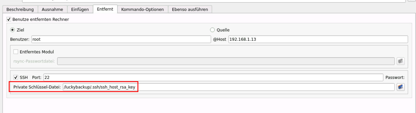

so, redo your ssh keys and place them in a persistent place like your appdata folder, then point to it from luckybackup pov, sample
/luckybackup/.ssh/id_rsa which would be located on unraid's pov /mnt/user/appdata/luckybackup/.ssh

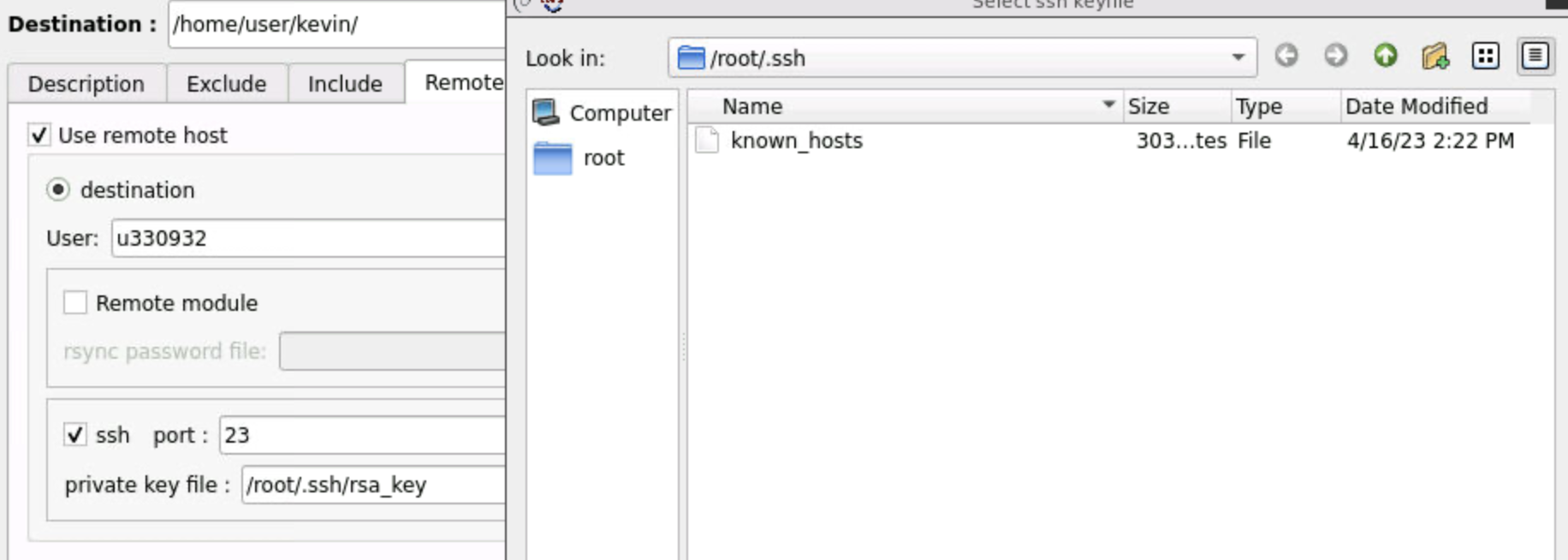

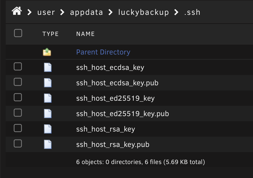

Same error for me. After the update the id.rsa is no longer present. Before everything ran without problems. It is definitely due to the update.

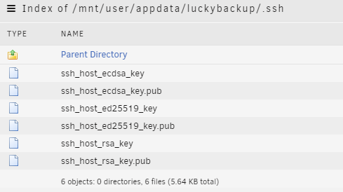

where is your id.rsa file located ?
/luckybackup is mounted to /mnt/disk1/appdata/luckybackup/
id_rsa should be in /mnt/disk1/appdata/luckybackup/.ssh, but is no longer there.
Edited by Kevin Hartmann
how does this looks like ?
my backups are still running fine (also since the update)
For unknown reasons, only the known_hosts is shown to me.
as you see you also dont use  the persistent path ...
Oh, I'm blind, thank you very much. I used the YouTube video from SPX Labs as a template for the setup. There the error is also present. Then I will create new SSH keys.

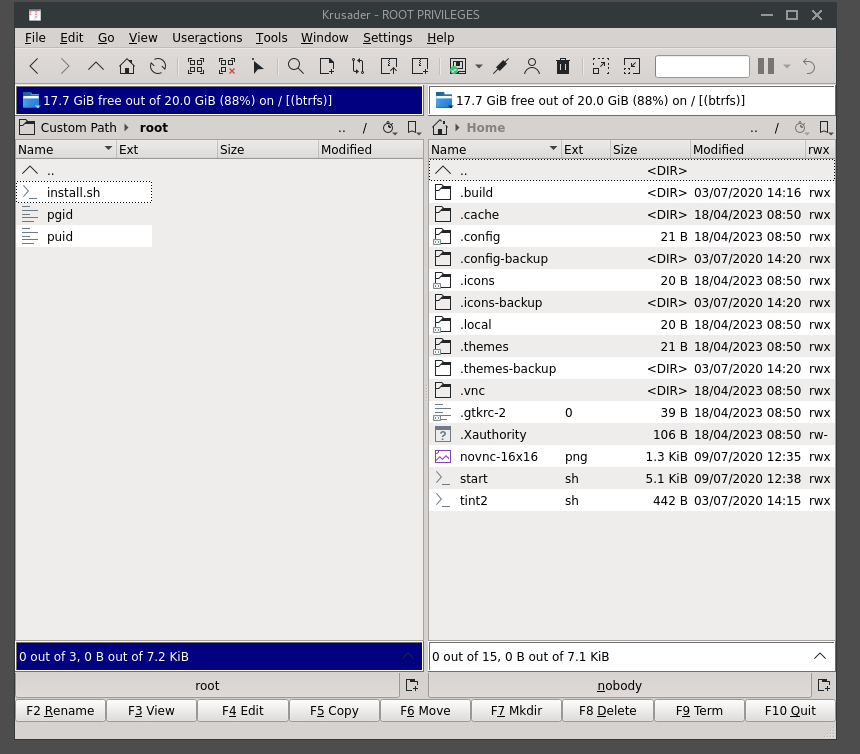

I let krusader run a search for the id_rsa and it couldn't find anything.  Would you happen to have any idea of where the file may have been moved to?
I cant get into the Root file with krusader (looks like a permission thing).
The file is gone now.
Please copy it over from the other machine again.
