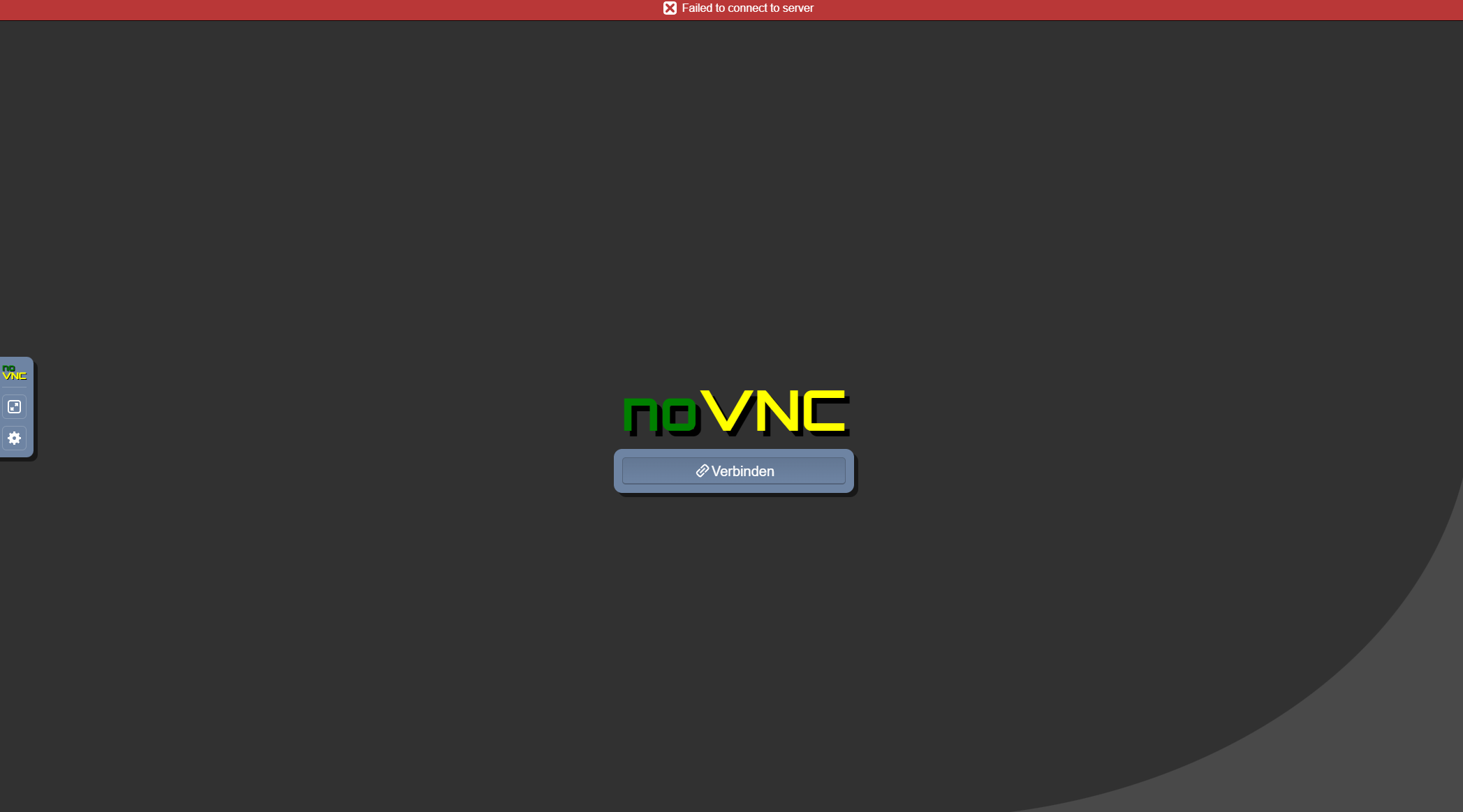

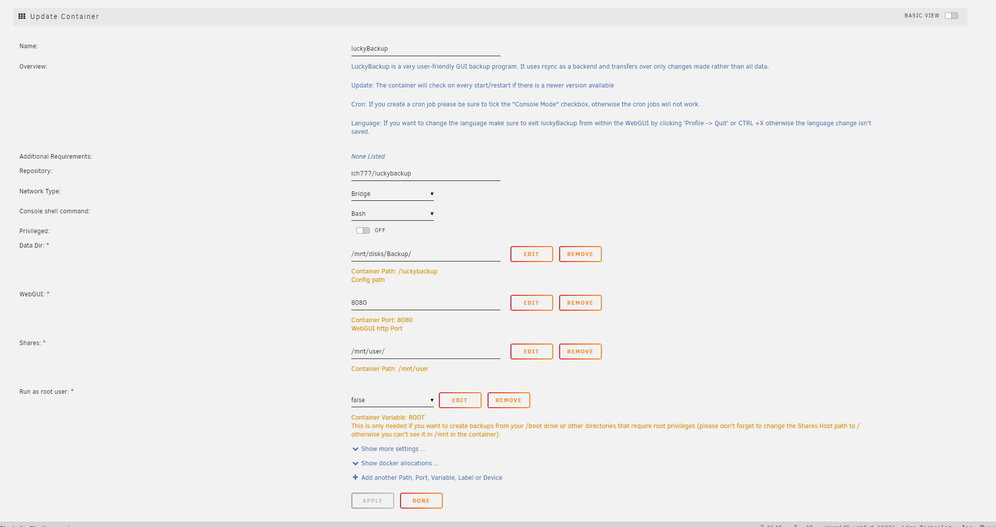

Hello
I have some problems with luckyBackup docker. The last time I used it I had no problems getting it to start properly but this time it wont even start.
I installed it with default port 8080 and when I open the WebUI I only see the noVNC page where it says: failed to connect to server.
I also noticed that luckyBackup hasn't created any files or folders in the appdata folder like I didnt installed anything.
I tried to reinstall several times but that didnt help.
I also attached screenshots of how it looks right now including the docker template.
Thank you and I appreciate any help to getting this to work
What does the logs say?
Without then I can‘t tell much.
Please stop the container, click on the container icon and then select logs.

24 minutes ago, Kraudi said:
Here is the log. Thanks for looking into it :)
Did you do a reset permissions from the tools menu on the Docker directory?
Are you using a Docker directory or a image?
If you did a reset permissions, you have to set up Docker again.
Reset permissions is only meant for user shares…
I didnt reset any permissions. I also did a complete "fresh" install of unraid and installed luckyBackup through the apps menu and it still doesnt work ...really strange. Every other "app" I installed works completely fine it's only luckyBackup which isn't working.
Edited by Kraudi

Is the disk Backup mounted? From the screenshot from above I see that you point the data directory (this would be usually the path to your appdata directory which defaults to: /mnt/cache/appdata/luckybackup) to a Unassigned Devices disk.
Are you sure that this is correct?
You are correct. The /mnt/disks/backup was an old wrong path I put in earlier and after uninstalling it somehow saved this path and it is now automatically in there on each new install. Changed it manually to the appdata cache folder and now it seems to work.
My bad sorry for that. I was sure the path is automatically reset to the correct appdata folder when reinstalling so I didnt even noticed.
