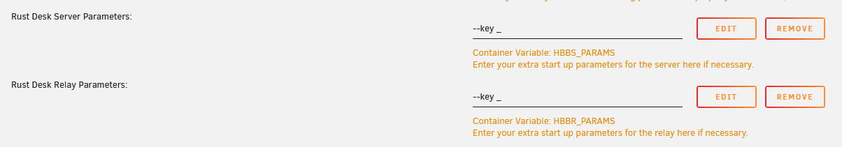

Just installed the "RustDesk-Server-AIO" Docker-Container on my UnRaid 6.11.5-Server.
Before opening Ports on my Router or using my Reverse Proxy to get connected via Internet I would like to tell the HBBR and HBBS to accept only requests with a key.
Well, in the template you can set extra parameters - can someone guide me through the process and post, what exactly to set as parameter.
Google tells me to use ' -k _' in Docker compose but that doesn't do the trick...
No matter if using network as host or bridged
Please don't do that, that won't work.
In my case that does work just fine:
If someone without my key tries to connect it fails and is rejected.
BTW, this is basically the same as:
-k _
(please note that the Rust client will most of the times fall back to the official key server and the connection won't be established through your hbbs <- Server or hbbr <- Relay)
EDIT: You can also easily see this in the container log because your key will be actually displayed with this option when hbbs and hbbr are starting.
-k _
Succeeded when running on "Host" network. Great work and thanx for the hints you gave!!
This is also working on bridge network.

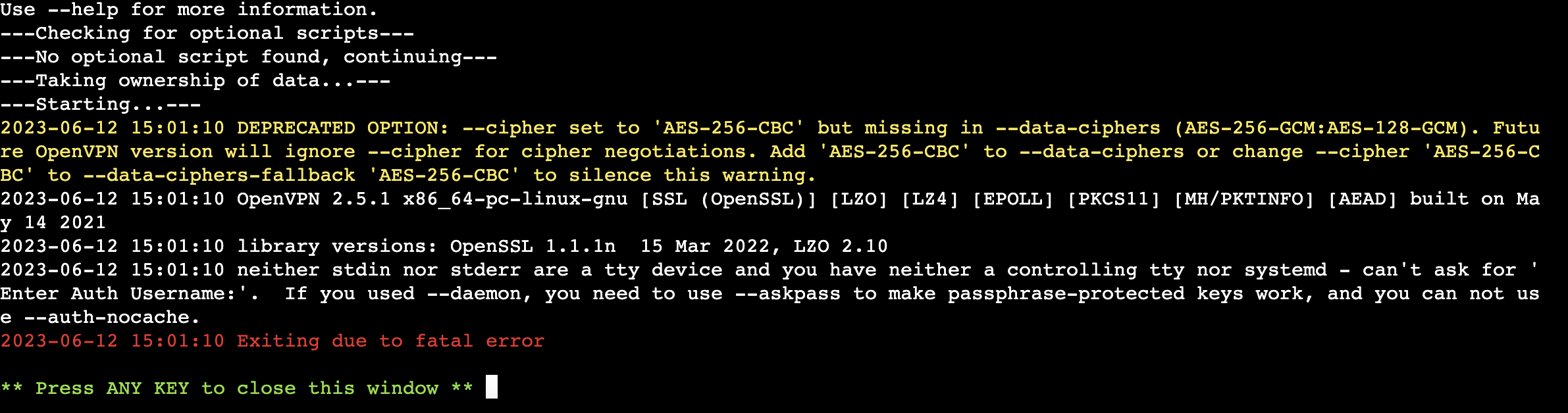

I keep running into this fatal error when try to start the container after I move the openvpn config files into the folder. I'm trying to use ProtonVPN as well.
Did you also create the file for the password?
I don‘t know how ProtonVPN works but you maybe have to edit the config file so that it doesn‘t ask for the password.

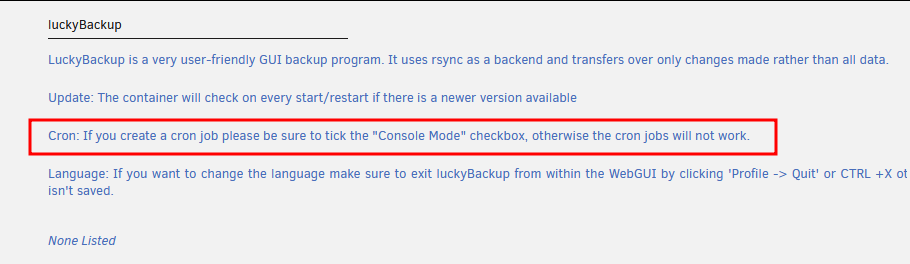

I'm running LuckyBackup, but it seems to totally ignore the folders I marked as excluded, and the backup doesn't auto-run when it's scheduled to. There don't seem to be any logs showing anything out of the ordinary - what could be the issue?
Please post scrennshots what you did exactly for more help.
Sure, here are the Excluded and Schedule screens:
The folders marked as excluded still get backed up, and a backup does not start at the specified time.
Please use exclude like that:
domains/*
steam/*
backup/*
Did you made sure that you've enabled console mode like mentioned here:
domains/*
steam/*
backup/*
Even when adding /* to the end of each path, it still tries to back them up. (i.e /mnt/user/domains/*) Did you mean that the "/mnt/user/" should be deleted, as well?
Yes, just like I've wrote it above, this was no mistake or laziness... ;)
