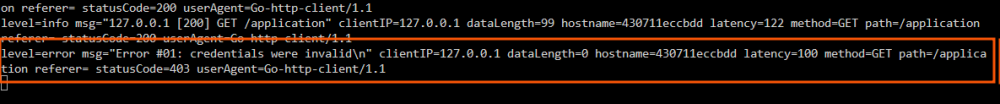

However if you get a 403 error this means that the password is wrong.

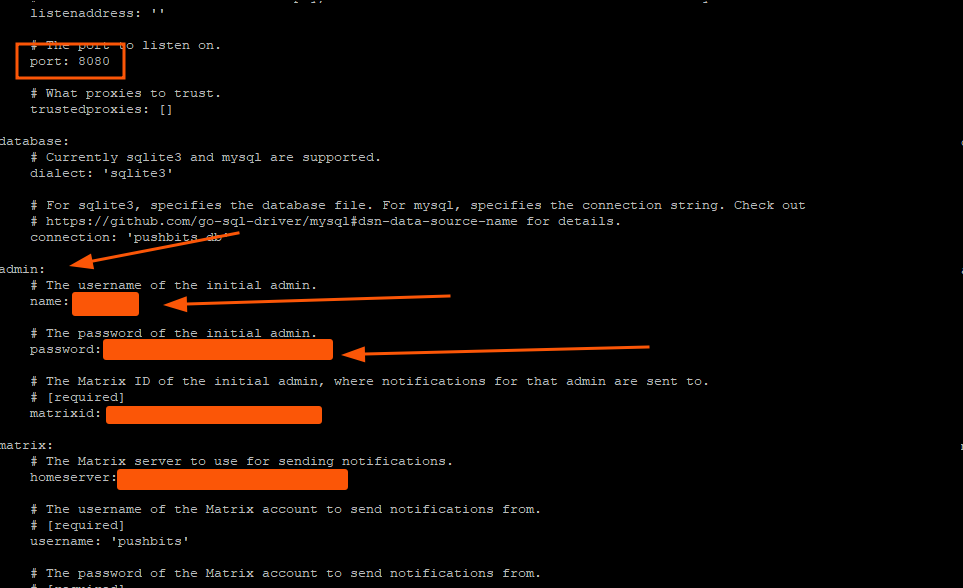

You have to use the admin user for Pushbits that you've specified in the config.yaml not the Matrix user to create an application for Pusbhits.

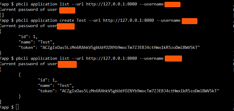

Then the password is wrong, I've tried it now on a fresh installed container and it works perfectly fine:
I even can reproduce this when I put in a wrong password:
This is the log:
You have to make sure that you use the admin credentials:
Please also make sure that you've use the port 8080 like in this example. Check also if your password have quotes or double quotes in it and remove them if so, maybe you have some characters in it which Pushbits isn't too happy about.
