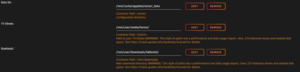

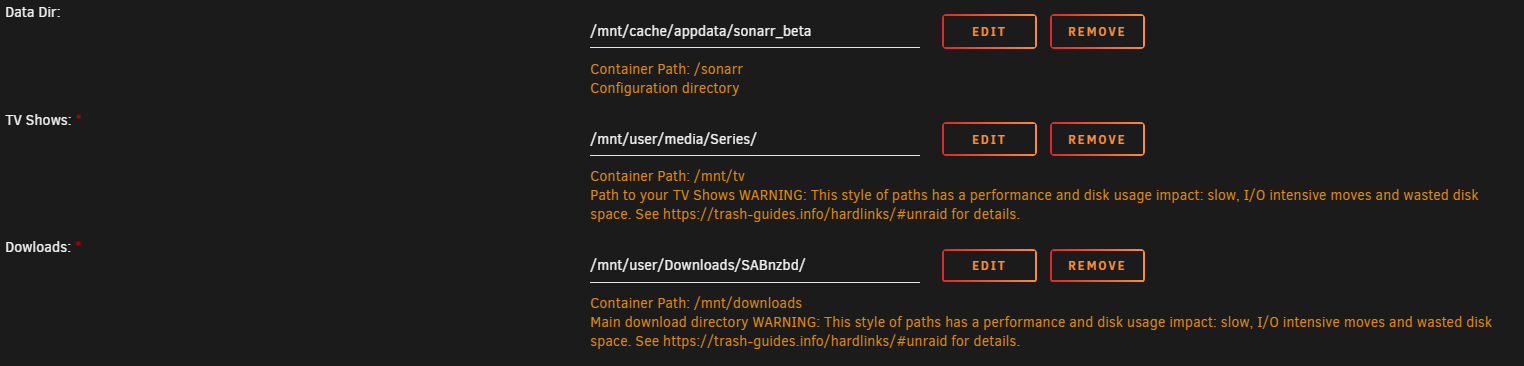

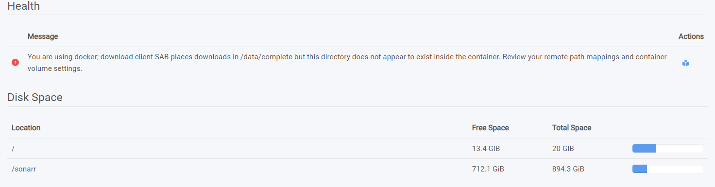

I am on the newset nightly of Sonarr, and it can't import downloaded series from the complete folder because it does not find it. I am not sure if this is a container problem or a Sonarr problem. But it searches in /data/complete/ but the sab folder gets mounted in /mnt/downloads/ . I guess I can fix it using remote path mappings but maybe I overlook something?

I guess the correct way would be to define a new path variable and set /mnt/user/downloads/Sabnzbd/ to /data/
Edited by kAUxPJ2sNt6i
The path mappings in the container have to be exactly the same so to speak if your download path in the container in SABnzbd is /mnt/downloads you also have to set it to the same path in the other containers.
The only thing that matters is that the path in the container is the same, so to speak, simply change the path in the container and also don't forget to change it in the configuration from the application itself.
