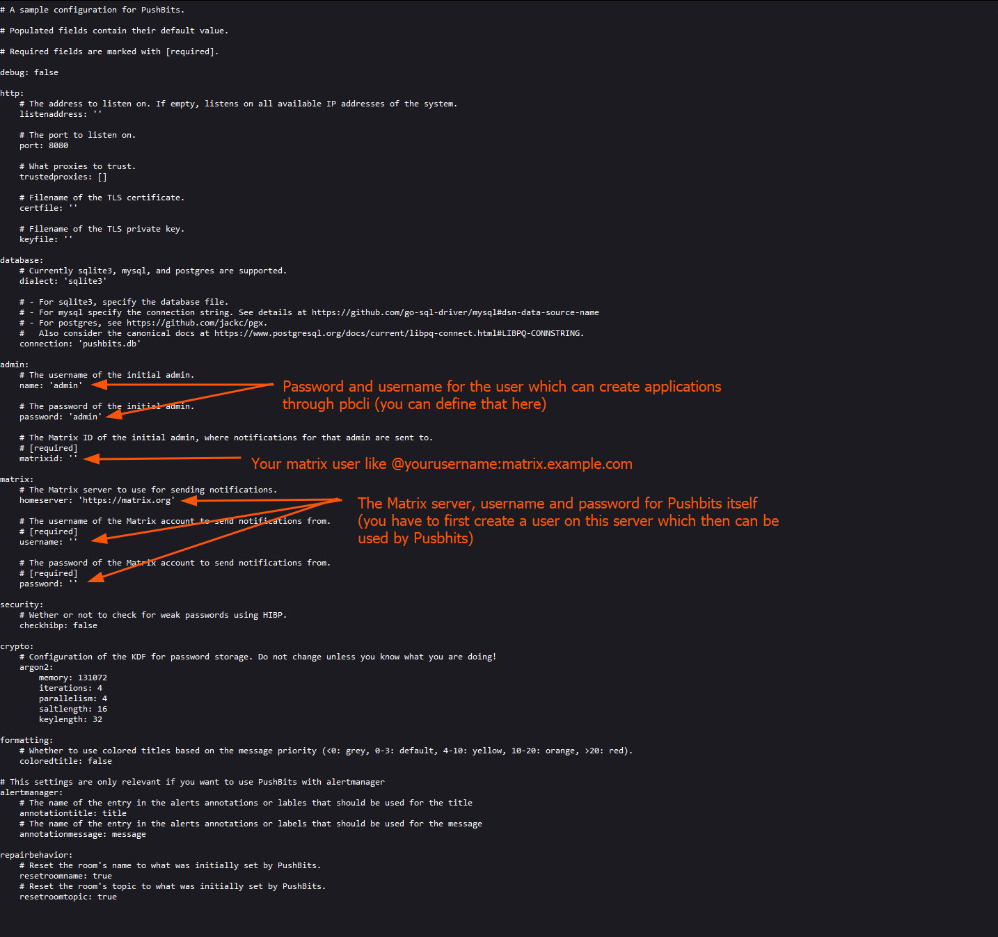

admin:
name: & password: <- this is the username and password (which you can specify) that is allowed to create/delete/list applications through pbcli
matrixid: <- this is usually your account in this format: @yourusername:matrix.example.com (if you create a application Pushbits will invite this user to the room)
matrix:
homeserver: <- This is where the Matrix server for Pushbits itself is hosted and you first have to create the user on this server
username: <- This is the Pushbits username on homeserver:
password: <- This is the Pusbhits password on homeserver:
So to speak it could look like this:
admin:
  password: 'mysupersecretpassword'
  matrixid: '@thewave:matrix.org'
matrix:
  homeserver: 'https://matrix.org'
  username: 'pb_thewave'
  password: 'superstrongpasswordhere'

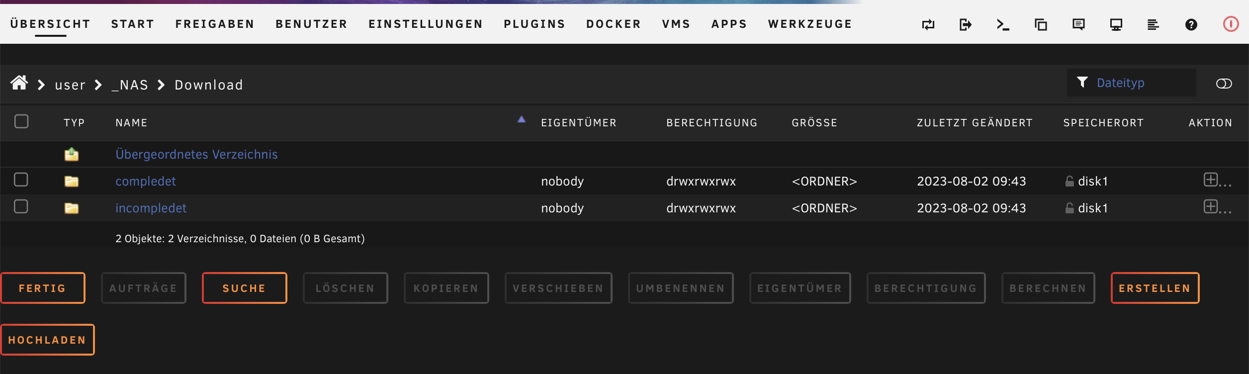

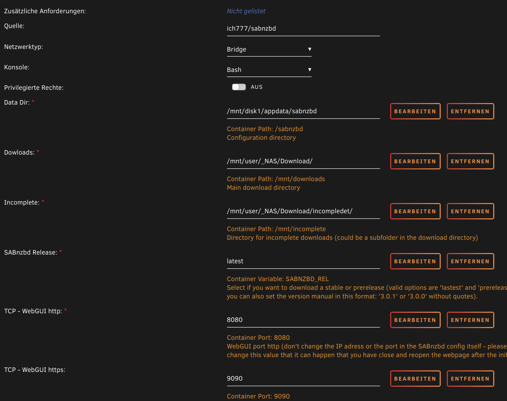

I have attached a photo of my setting.
I'm still a newbie and I set it like this. is it right?
In the 2nd picture I have attached my folder structure.
can you help me??
Many greetings from Lübeck
Where is the _NAS share located on a Cache pool or on the Array?
Hello,
I have that in the array .
Have sent pictures with it for safety.
Is that correct?
Greetings
IMG_7269.thumb.jpeg.b57e03a43784aca7b4ffdbf6b648170c.jpegIMG_7270.thumb.jpeg.baf18d5bf55015d9fed181cd060c63bd.jpeg
Was this always the case or did you change anything recently.
I would recommend that you put it on a spare SSD or single device since it can limit your download speeds significantly if it unpacks and downloads at the same time.
