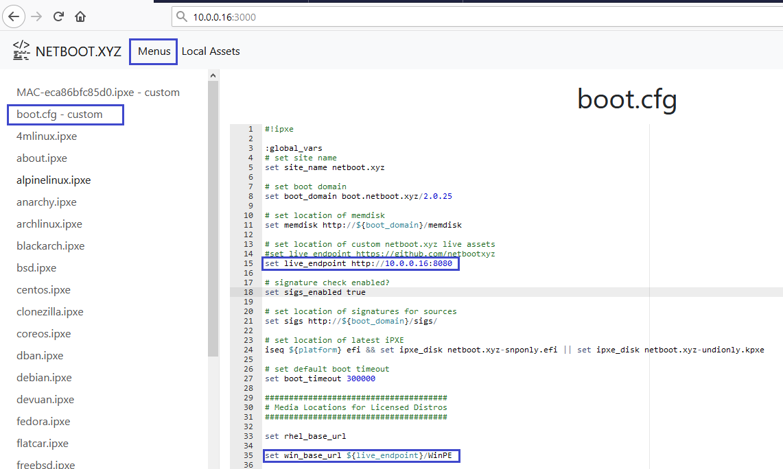

I just successfully booted win10 installation image. Few steps, but took me couple of hours to make it work. Here how i configured it:
- installed netbootxyz docker (used default settings + mapped "/asset" to my image folder "/mnt/cache/appdata/ISO")
- configured my pfsense FW/router via webinterface. Went to services/dhcp server and specified the following options :
    IP Address of TFTP server (my unraid server IP)
    Enable network booting yes
    Next Server (my unraid server IP)
    Default Bios file name (netboot.xyz.kpxe)
- configured NETBOOT.XYZ via webinterface (http://unraid_IP:3000/) - in the file "boot.cfg" located under "Menus" updated variables "live_endpoint" and "win_base_url" as follow:
    set live_endpoint http://unraid_IP:8080
    set win_base_url ${live_endpoint}/WinPE/
- downloaded official win10 x64 iso file and extracted it via 7zip to my image folder (/mnt/cache/appdata/ISO/Win10_1903_V2/x64/). Files had to be place to subfolder x64. note: with normal Win10 iso everything went fine except when I got to the actual install phase, I was getting "A required CD/DVD drive device is missing. If you have a driver floppy disk, CD,DVD, or USB flash drive, please insert it now" message. WinPE image had to be used instead and from WinPE then install any win iso you need.
- created Win PE with integrated PowerShell (PowerShell needed for mounting iso images) as per instructions:
https://docs.microsoft.com/en-us/windows-hardware/manufacture/desktop/winpe-adding-powershell-support-to-windows-pe
- uploaded the Win PE to my image folder (/mnt/cache/appdata/ISO/WinPE/x64/). Files had to be place to subfolder x64.
- powered on client PC and forced it to boot from LAN. It booted up to netboot menu where navigated to windows disro
- booted WinPE, mounted required win 10 iso file and started the installation:
    wpeinit   (initialize the network)
    net use z: \\10.0.0.16\appdata\ISO   (map z: drive to my samba image folder with official Win 10 image "Win10_1903_V2.iso")
    PowerShell   (run powershell)
    Mount-DiskImage   (mount the official iso win10 file located at z: drive z:\Win10_1903_V2.iso)
    d:\setup.exe   (run win10 installation from the mounted ISO)

It is really great. I've managed to create custom menu for specific client machine. Also succeeded to run Kodi/LibreELEC from network boot. Bolow my notes, might be handy for someone.

NETBOOT.XYZ part:
- connected via webinterface - under "Menus" created new ipxe file, name of the file has to be in this format "MAC-1c6f65d1b67e.ipxe". This boot file will be then used only for system with the mac address 1c:6f:65:d1:b6:7e.
- the customed menu has 4 options (run Kodi, run Win10 install, switch to standard Netboot.xyz menu and Reboot)

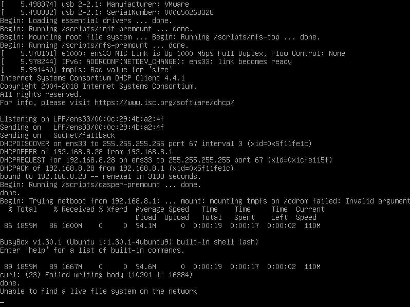

i spend my all day pulling some images to use locally.
I'm quite a bit disappointed as very few are working out of the box.
I modified live_endpoint in boot.cfg and that part is ok.
I installed a linuxmint vm with an iso as the image pulled (squashfs) couldn't boot with error message rootfs not detected despite the squashfs file was present.
My vm installed with lvm automatic partitioning (which is not convenient as /home is in the root partition). I needed to resize lvroot to make a lvhome.
So i thought with all utilities on the menu i  will find one to resize my lvroot. I was able to boot gparted but it can't resize lv.
Kaperski live booted load files from server but stopped with displaying no network connection which is strange as it downloaded files from the server.
Rescatux boot but stop at some point complaining about the lack of screen.
System rescue cd stopped on error failed to mount /dev/loop0
I can boot debian live but the keyboard is not responsive i have to hit 2 or 3 times the keys, not very convenient when locales are not set correctly. When i try to reconfigure locale the booting process shows up as soon as i try to move cursor.

So I had to bounce around quite a bit here to figure out how to get this to work *EASILY* with a Windows 10 install. I figure I'd post what worked for me. This is largely based off what zakna did with a few additional steps and a little clarification.
1. Follow his guide up to here:
That did not work for me. It gave me a double // in the command to find the WinPE files. I used this and it worked:
Hi.  Trying to follow the steps you laid out here.  Currently, under my Menu, there's no boot.cfg file.  Did you create a new one called boot.cfg and updated the variables you mentioned above?
boot.cfg should be there by default, didn't create a new one, just edited existing.
note: if you are going to update the win_base_url variable, do not put forward slash at the end of the path (see above the post from user total) as some machines might have issue with it
Mine doesn't come with one.  I thought I might have deleted it sometime ago.  I reinstalled the docker container from scratch.  Deleting the previous folder as well, to make sure everything new is put in place.  Still, there's no boot.cfg on the newly installed container.
Edited by jang430
Try to update the menus to latest version. Could be that the newly installed app doesn't have menus pre-installed.
Thanks @zakna, that did the trick!

I'm struggling to boot live media from the netboot docker and i have no idea what I'm doing wrong.
- I set up the live endpoint correctly (i had to reroute port 8080 to 8069 cause it was already used in another container but it works. i can navigate it fine)
- I downloaded the assets (in my case i tried popos 20.04 and ubuntu mate 20.10 and i can see them in  192.168.8.105:8069/.. etc )
- I set up a vmware vm that boot into pxe and i get this error (see attached image). I get the error whenever i boot popos or ubuntu mate live
I tried Ultimate boot cd and works ( i had to download it manually and change the name cause there is a version mismatch in netboot config files)
I tried ubuntu network install 20.10 and works, gparted works, clonezilla ubuntu stable works
VM has plenty of ram (8G) and disk (64G) and is in bridge mode so it has its own ip and mac
DHCP is provided by my pfsense and is configured correctly
2021-01-23 18_23_15-poptest - VMware Workstation 15 Player (Non-commercial use only).jpg
Based on the output it looks it start to download the image from netboot and then crash at 89%, might be VM related. Do you experience the same problem when you boot it on some different PC?
I just tested popos 20.04 (downloaded "pop-20.04-default-squash" (initrd+vmlinuz+filesystem.squashfs) files), works for me (apart that it boots with 2 screens enabled and installation wizard).
I used same boot script as in predefined "live-popos.ipxe" menu:
set squash_url ${live_endpoint}/ubuntu-squash/releases/download/5-42ebbb8e/filesystem.squashfs
set kernel_url ${live_endpoint}/ubuntu-squash/releases/download/5-42ebbb8e/
imgfree
kernel ${kernel_url}vmlinuz ip=dhcp boot=casper netboot=url url=${squash_url} initrd=initrd ${cmdline}
initrd ${kernel_url}initrd
boot

You are right, it's the stupid vmware player vm that is broken.
I tried with a vm in Unraid and it loads fine, i did not try with a physical machine yet because i use my desktop as work pc and my notebook has no ethernet.
I wonder why vmware player doesnt work
