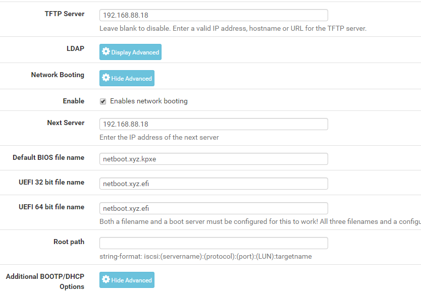

I also just installed the netboot.xyz CA and after making the router changes in my pfsense router as listed in the 'router setup examples' found at https://hub.docker.com/r/linuxserver/netbootxyz I was able to PXE Boot from a couple of machines (a thinclient and a couple of laptops) for testing (booted a live image and a couple utility images). @Evilfrog as Xannor advised you will need to make the equivalent changes for your specific router/DHCP Server before you can network boot.

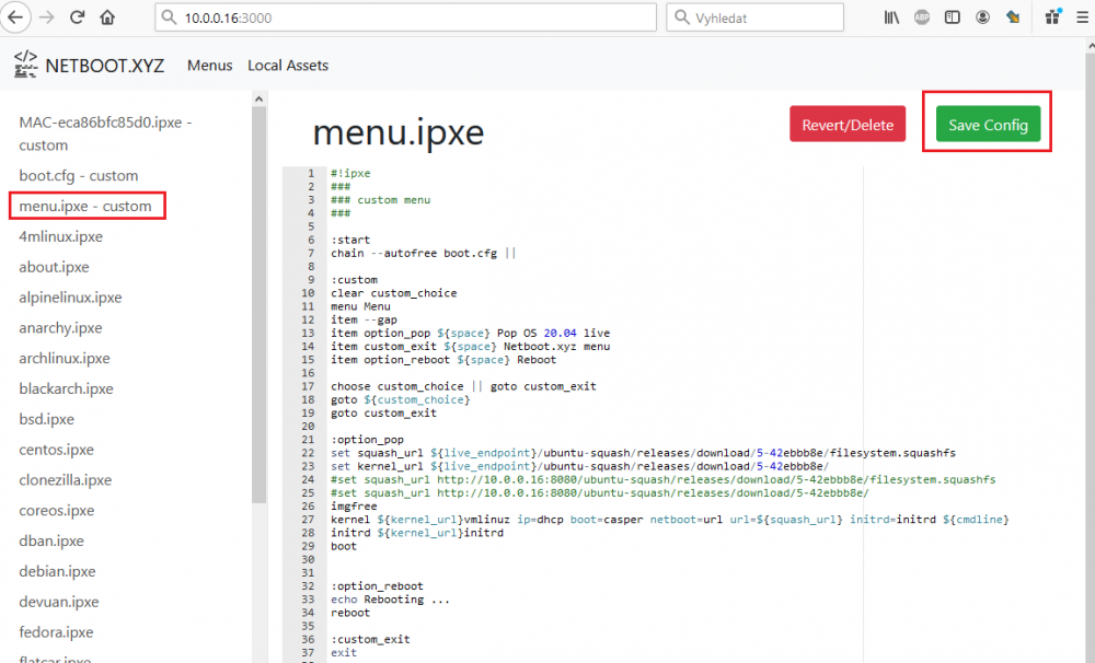

I'm having a problem getting it to load a custom ipxe file based on MAC address, I've named the file "MAC-00d861xxxxxx.ixpe" but it loads what seems to be the default menu, do I need to do something else to load custom files ?
Edit: I found the issue, typo in the filename :)

I have installed the netboot.xyz docker container on my unraid server and setup the my PFSense router as per instructions https://viclab.se/use-netboot-xyz-with-pfsense/
However when I attempt to net boot any machine the tftp transfer timesout.  I also get a time out when attempting to test tftp transfer using the macos tftp command line app.
Does anyone know of a way to monitor the tftp logs in the docker container to see why the file transfers are timing out?
