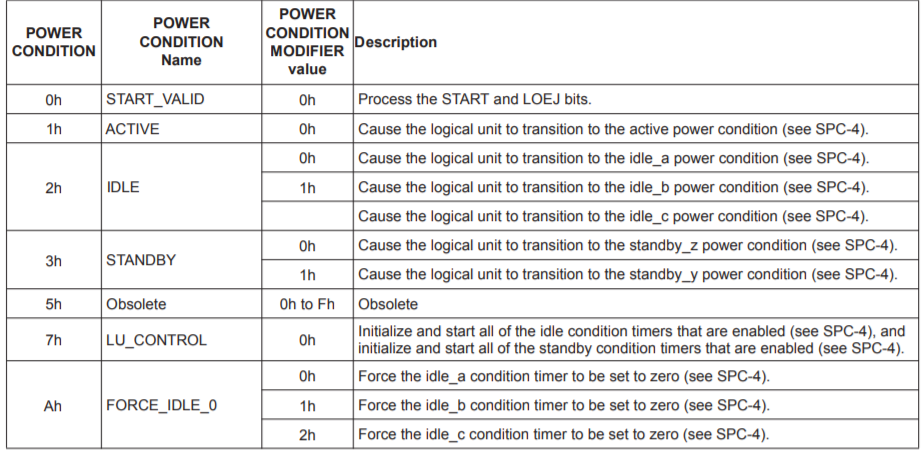

Drive spin up as required. Also drive polling spins them up as I am guessing that as unraid doesnt know they are spun down it does a smartctl for the drive.
SCSI Power Conditions

The sdparm shows the status, the disk spins up if the access is made to it, you can force spinup using pc=1 or just -s
-vvv is not required for the command to run just give more verbose info of the SCSI command.
Those commands only work on SAS you will get an error message for SATA

Okay, @SimonF, I think you nailed it!
I just tested this on my SAS drives.
My results:
1. The command does actually work on the /dev/sdX devices as well, but what happens is some kernel thing negates it immediately (with a message in syslog - see this post for details). For some obscure reason, issuing the command against /dev/sgN does not initiate this auto-negation, hence - success! Great find.
2. Indeed this is the STANDBY (rather than STOP) state, which means the next i/o does spin the drive up. Even tested with the array started (ain't I so brave). No damage, no red x. This is the state we've been looking for.
3. Issuing this against SATA drives (per @sota) - well, mixed blessing. On one hand it does send the drive to spin down. However the next spin up of the drive spews some funny i/o error messages on syslog. It does spin up, and the i/o does complete successfully (I do my testing with dd) but this is not something we want. So I guess program logic will need to make the distinction between SAS and SATA.
That is very cool. @limetech, I think this might be ready for you.
sg_start --pc=3 /dev/sgN
@limetech --pc=1 can be used for spinup drives

Obviously @limetech has to agree, but I think at least the groundwork is there to do some integrated testing.
The base is there though; a command that puts an SAS disk into standby such that it'll spin back up when it gets touched, and code to be able to figure out which command to run for SAS vs. SATA.
This is awesome!
The command:
sg_start -vvv  --pc=3 /dev/sgX
works perfectly with my SAS-only array.
