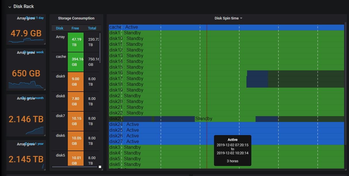

51 minutes ago, doron said:
Interesting. When you say the disk did not spin down - how did you test that hasn't actually spun down?
Because the disk server LED does not go out, I also see the active disk in grafana.
SYSLOG:
