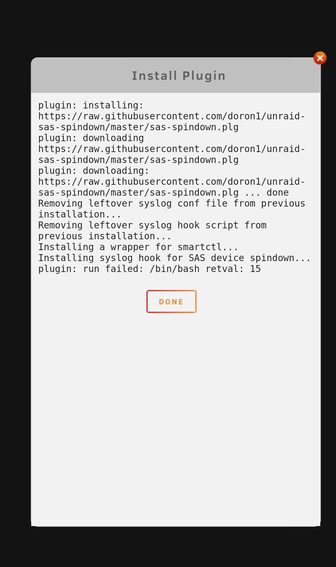

I removed my SAS drives because of the spin down issue. I was going to try to install this plug-in before putting them back in my server. It says run failed. Am I doing something wrong?
Please use the existing plugin support thread:
