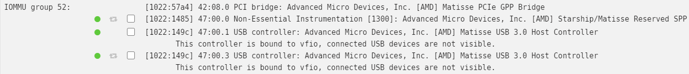

16 hours ago, Vaggeto said:
That makes sense on the audio. Do you mind sharing the code to prevent unRAID to use the audio controller that you are checking as a USB audio device? (or is it the xen-pciback.hide= code?)
The PCI IDs in my syslinux.config is for the audio controller itself, not for the USB audio device.
1022:1487 = onboard audio controller
1b21:2142 = onboard USB 3.1 controller
For whatever reason when I try to pass my controllers, the VM won't load. They are in their own IOMMU groups and everything. I posted here about it.
I do have one additional controller on my motherboard, but it is the only controller with USB2 ports so I don't want to pass it through even if I could since I'd prefer for my unRAID USB flash drive to be on a USB2 port.

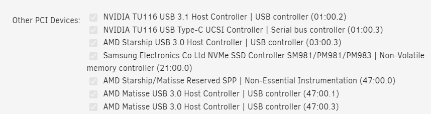

Apologies for jumping in on this topic. I'm slowly losing my mind with my TRX40 board (AS Rock TRX40 Creator) and 3960x combo.
I want to be able to pass through a GPU (The only one in the system), a USB Controller, NVME, and the onboard sound. Every time I tried to start the VM it killed unRaid to the point of a hard reboot. It's also killed the flash drive twice, requiring a rebuild.
Things I've worked out so far by trial and error and lots of VM config tests:
1) The original GPU (Vega 56) just wasn't having it. Swapping to a RX580 works.
2) Passing through the NVME controller using the VFIO plugin works fine
3) As soon as I try pass through either the sound or the USB controller it kills everything. With the USB I've tired isolating the group with the USB and also the non-essential instrumentation and then passing through (with no sound). Kills unRaid.
4) I tried passing through just the sound, both under soundcard without using the plugin, and also using the plugin. Kills unRaid.
Where am I going wrong?!
Iommu Groups below and diagnostics attached.
As I said earlier, I also have issues similiar to yours, trying to passthrough the onboard audio controller. Unraid will kinda freeze and I have to reset the server. That was the first issue i stumbled across when I got my TRX40. Issues with the sound card are fixed for me since I noticed the sound card itself is split into 2 USB audio devices which I'am able to passthrough to different VMs and can run them both at the same time.
GPU passthrough never was an issue for me. 2 GPUs for 2 VMs, rock stable from day one.
Onboard USB Controller passthrough showed similiar issues with Unraid becoming unresponsible. But not all controllers on my board. I think one of the two Starship ones caused the issues for me. The 3.1 controller passes through fine and is the only one I use and need. The FLR warning/error produced by the other controller will be fixed with newer linux kernels. Maybe check the Unraid 6.9 beta and test it or use a FLR patched Kernel. I think there is a custom kernel in one of the unraid forums which include the FLR patch and the vega patch.

I pass both Matisse Controllers to my VM. I'm using multifunction to pass the whole IOMMU group.

Looks to me very much like ALL TRx40 boards have 2 Starship and 2 Matisse (same group but can be separated) controllers, plus some ALSO have Asmedia controllers. So min 4, poss 5 passable controllers. So one for unRAID, and 3 or 4 for VMs. I can work out how to get 3 diff GPUs ;-)
