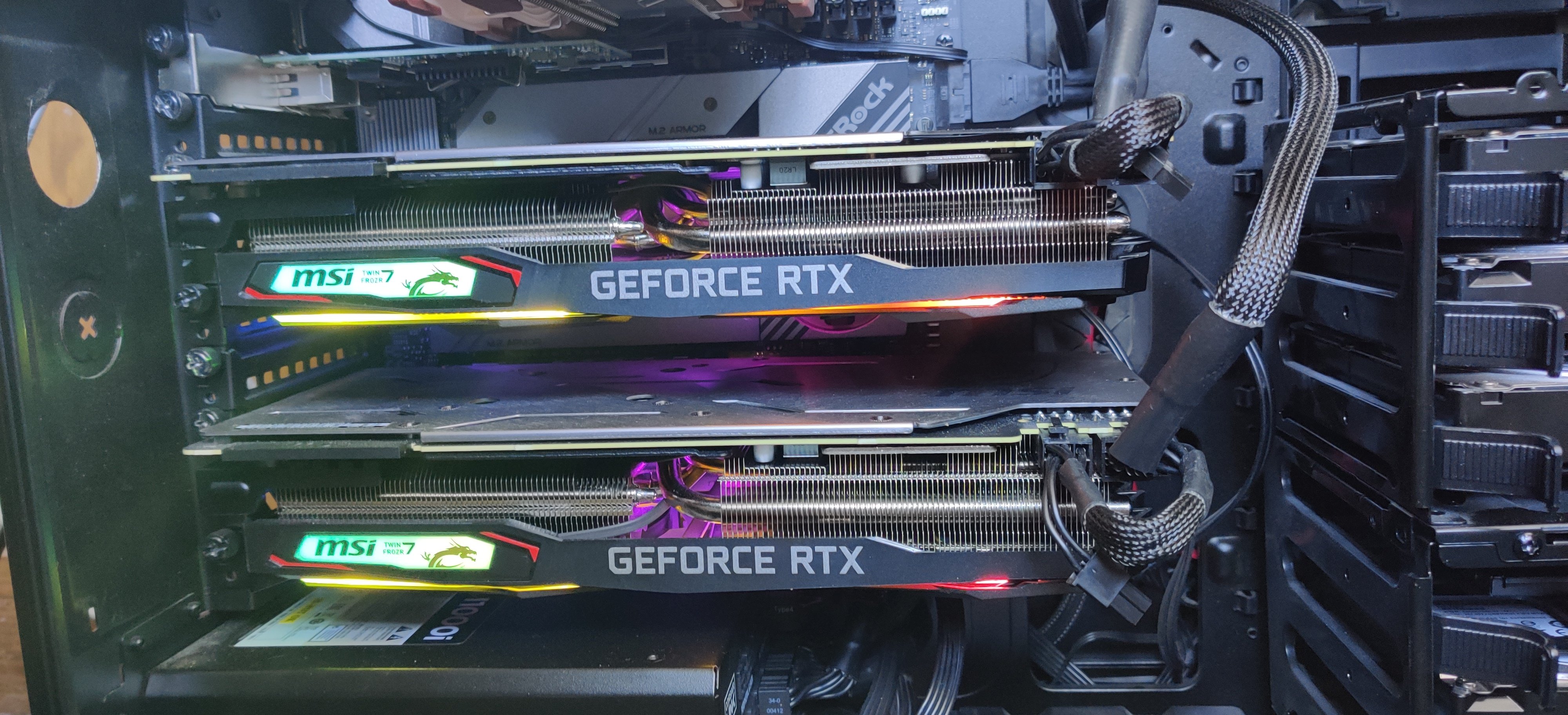

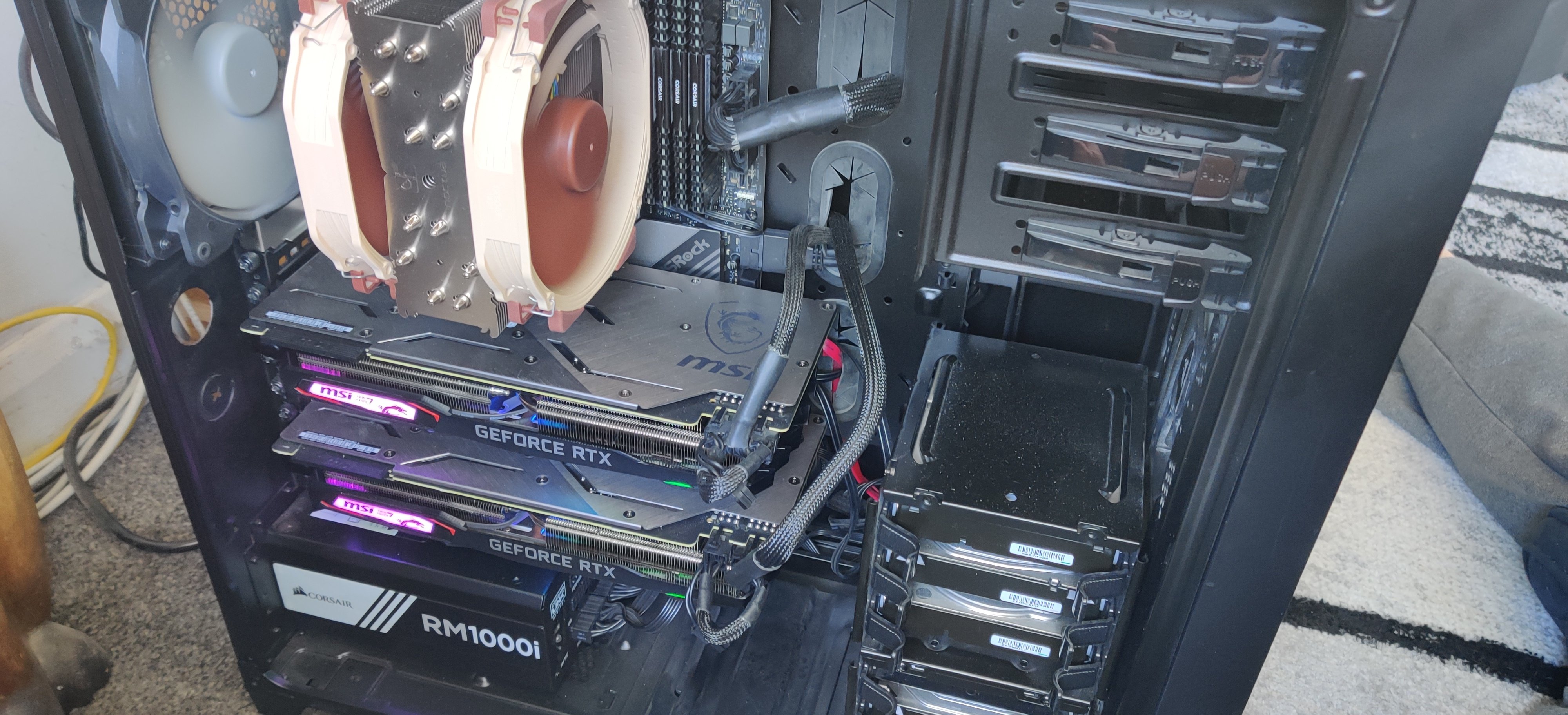

Just setup a Asrock trx40 creator with 3970x. Plan was 2 x 2070 supers for vm's and a rtx 980 for bit of plex lol, No chance of getting them all in the system see photo's.
Passed through 1 x usb 3 controller fine to first vm but i had the FLR issue if tried to pass another one. Got round it by passing the usb c pcie to the other vm. The 2070 gpu's passed to vm's with no issues and i am using the gpu's audio as well. I don't need to use the onboard audio as gpu's are going to monitors via 20m fibre diplayports and 20m usb 3 active cables.
Also got 128gb of Corsair lpx ddr4 c16 no chance of getting it to run at 3200 crashes vm's and all sorts, but rock solid on 2666! what is everyone else running their memory at?
IMG_20200625_122601.thumb.jpg.89beceb5c95010939d76d828c222641a.jpgIMG_20200625_122532.thumb.jpg.c4b543206896f2c0116fec7521d4885b.jpg

I would like to know, how you configured your two gpus and your two vms. I am planing to buy a new system, a beefy one. What were the needed steps to get the two GPUs work? Thanks in advance.
I ditched the 980 in the end it seems to cause issues whenever i put in a unraid system! But yes, i didn't think of pcie extension lol.
The vm's just have the 2070's passed through. Works no problems it was the usb pass through from the MB that was a pain! there is a few threads about this on here.
