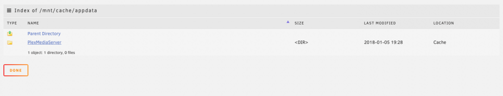

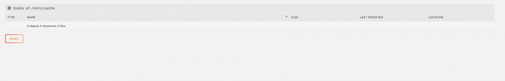

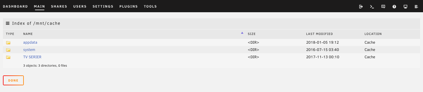

Just to make sure we don't miss anything, go to Main - Cache Devices and click on the folder icon at the far right then post a screenshot.
I have only followed the instructions here on the forum, except for this I have done no other work.
Here is the Cache devices screenshot.

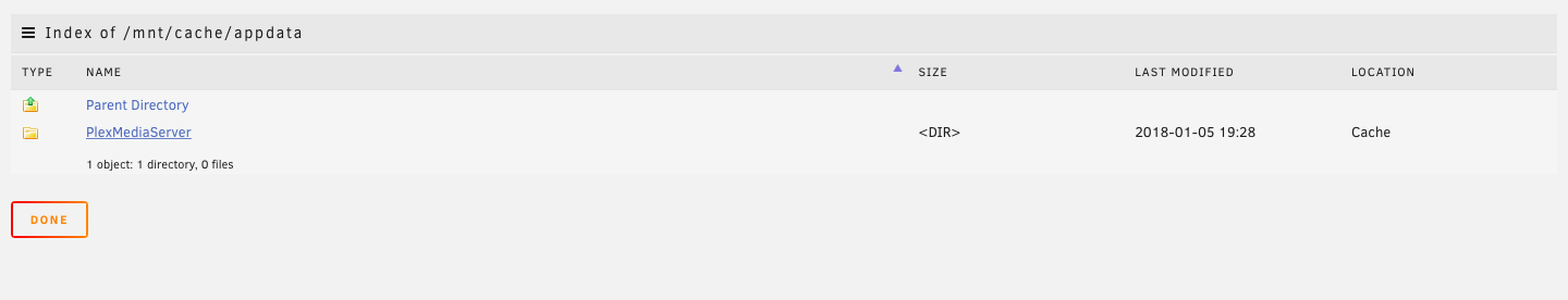

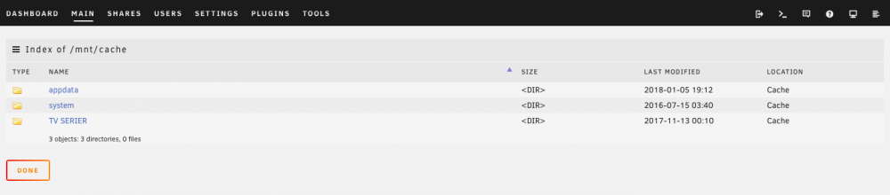

Could the missing Plex info be on the cache ?
OK that agrees with what I had seen from looking at all of your shares cfg in diagnostics. Let me address your other question before continuing.
Nothing on cache is "missing". Cache is part of the user shares, and your appdata share is on cache (where it ultimately belongs). Probably what is wrong with your plex is a corrupt database, which is in the appdata, but not missing in any way. As mentioned you might have to start over with that. We will get there.

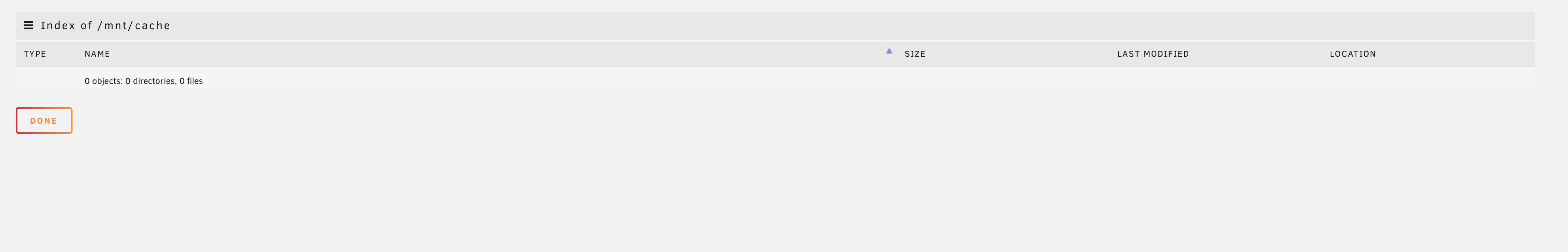

The next thing you need to do is set those 3 shares that appeared in your latest screenshot (those that have files on cache) to cache-yes and run mover so we can get them moved off cache. After mover finishes post another screenshot just like that one so we can make sure nothing is still on cache before we reformat.
Ok, understand. I am prepared to setup Plex again.
Ok, so if I understand correct I go to "Shares" then choose each share and set "Use cache (for new files/directories):" to Yes ?
And then how do I start the mover ?
Yes.
Go to Main - Array Operation and click Move Now.
Ok, mover is working. Not sure how long this 42GB will take to move...
Its ready for the next step :)
OK. The whole point of course was to get everything moved off cache so it could be reformatted, so we are ready for that now.

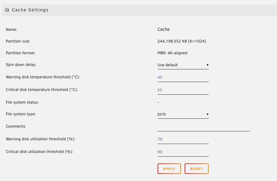

Then, go to Main - Cache Devices and click on the disk to get to its Settings page. Change the File system type to btrfs.
Then go to Main - Array Operation and post a screenshot just to refresh my memory.
Ask questions if this is unclear or there is something missing in my description.
btrfs or btrfs encrypted ?
brtfs, then choose apply ?
