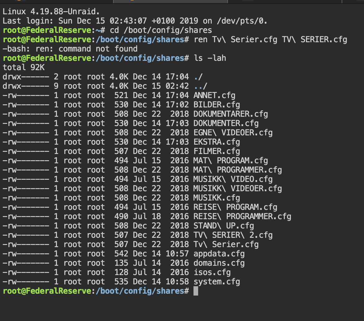

The cfg file is actually for a share named Tv Serier (which does not exist). The share you have is actually named TV SERIER, and it doesn't have a cfg file. Linux is case sensitive, so these are not the same thing.
Try this from the command line:
cd /boot/config/shares
ren Tv\ Serier.cfg TV\ SERIER.cfg
ls -lah
and post a screenshot of those results.

Is that one commant, or 3 separate commands ?
3 commands
Thanks. This is the result. See photo enclosed.

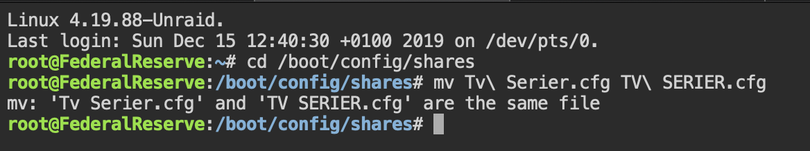

Try this:
mv Tv\ Serier.cfg TV\ SERIER.cfg

My mistake.  (I forgot you are a total novice at comand line)
Sadly I am yes. Used to use Synology which have worked well without any knowledge of command line.
Here is the new result.
I googled the error message/problem and it appears to be an issue with how the mounting is handled.  You are going to have to shut the server down, pull the flash drive, plug it into a PC and change the name there.  Watch the Capitalization when you do this!!!   (At the OS kernel  level, Linux recognizes 'case' and Windows does not!!!  So the names of 1.Txt and 1.txt are two different files to Linux and one file to Windows!)  You have to end up with that file being named  TV SERIER.cfg

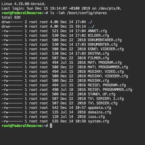

Lets do this command again to see where we are:
ls -lah /boot/config/shares
This is what's show up now.
OK, that looks good. Post a new diagnostic so we will have the latest to work from.
