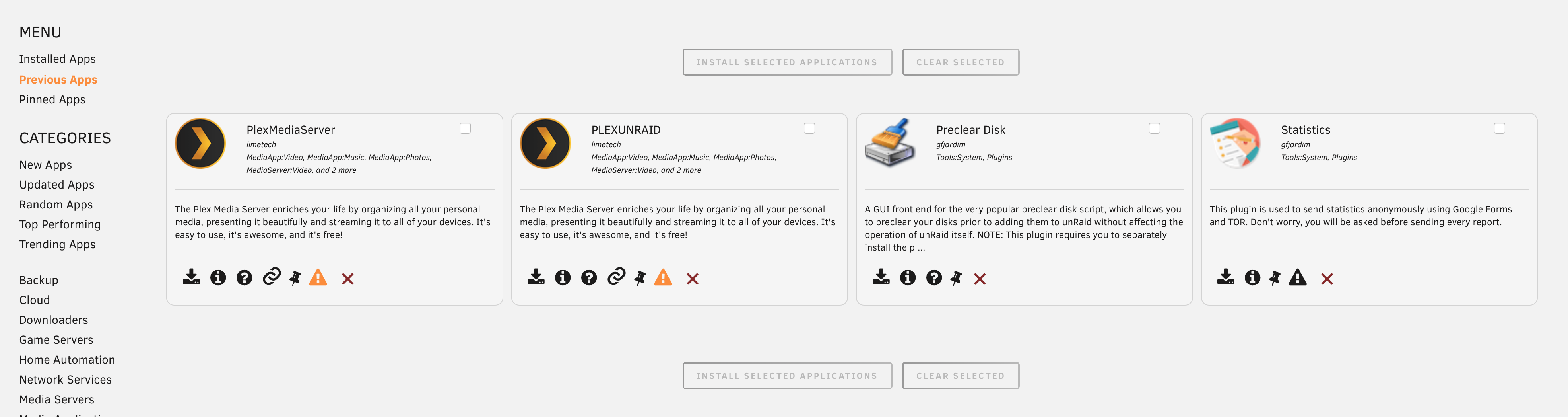

Ok, good. Docker disabled, docker image deleted and docker restarted again. CA downloaded, and I took a screenshot of previous applications.

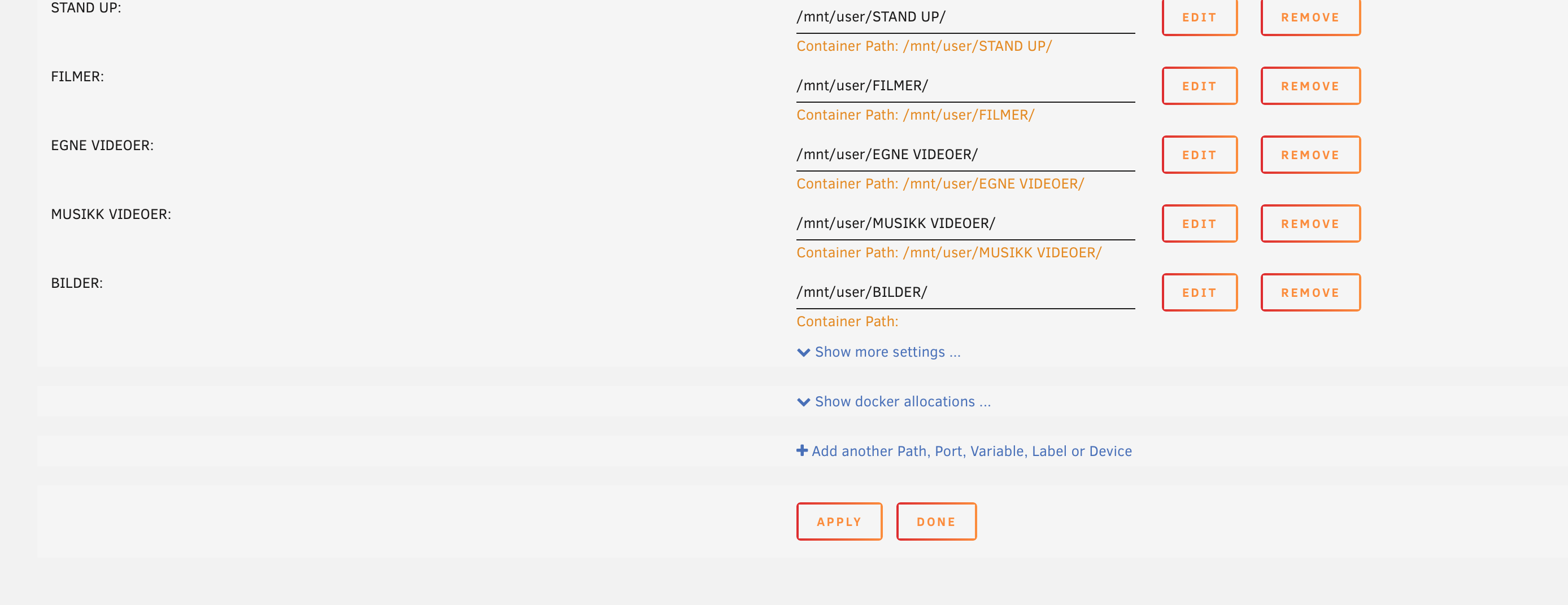

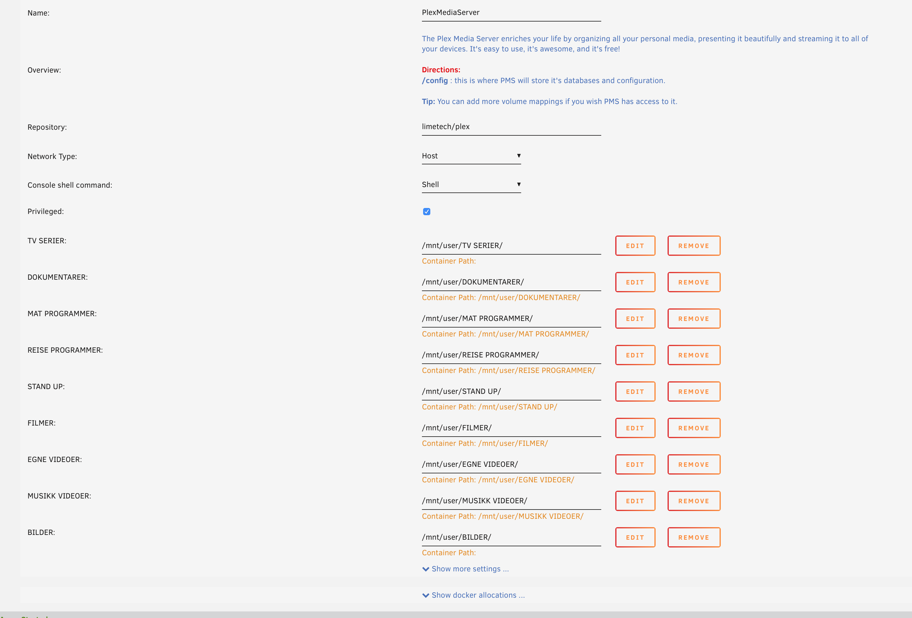

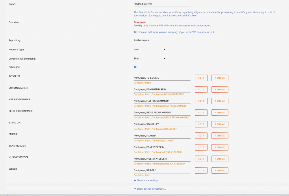

Looks like you had 2 previous templates for plex, but they are both for the deprecated limetech plex docker. We can try them anyway though just to see what happens.
The one named PlexMediaServer is the one you had installed. Click on the "download" button, the downward arrow in the box for that one and that will launch the Add Container page I was talking about. Then, there will be a slider in the upper right of that page, move it from Basic to Advanced.
Then post a screenshot.
Screenshot as requested :)

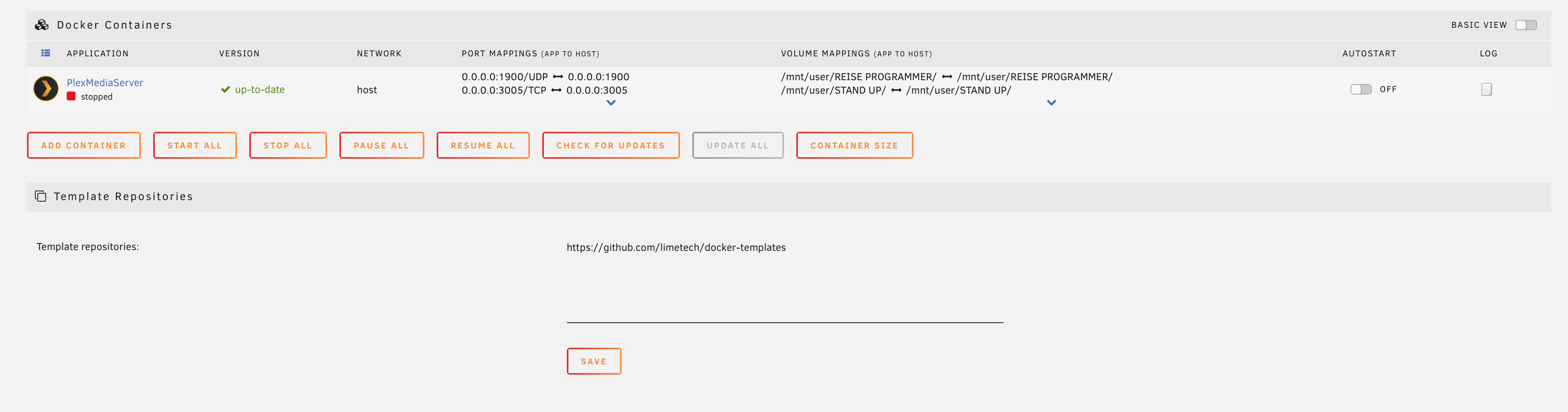

Should I apply and test it ?

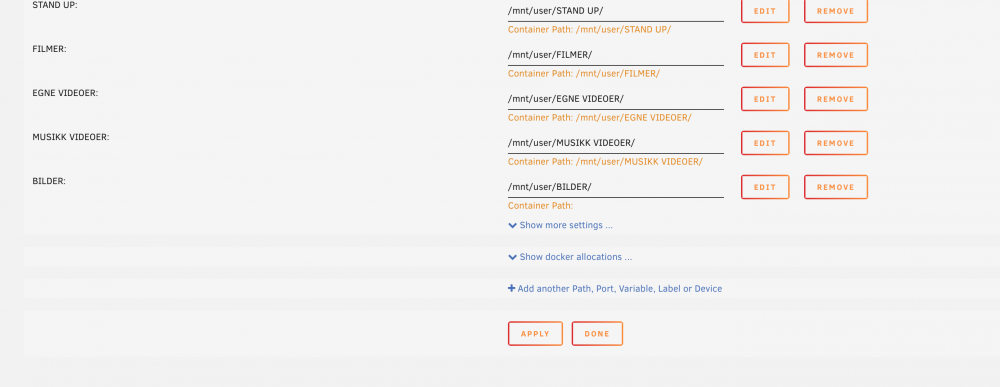

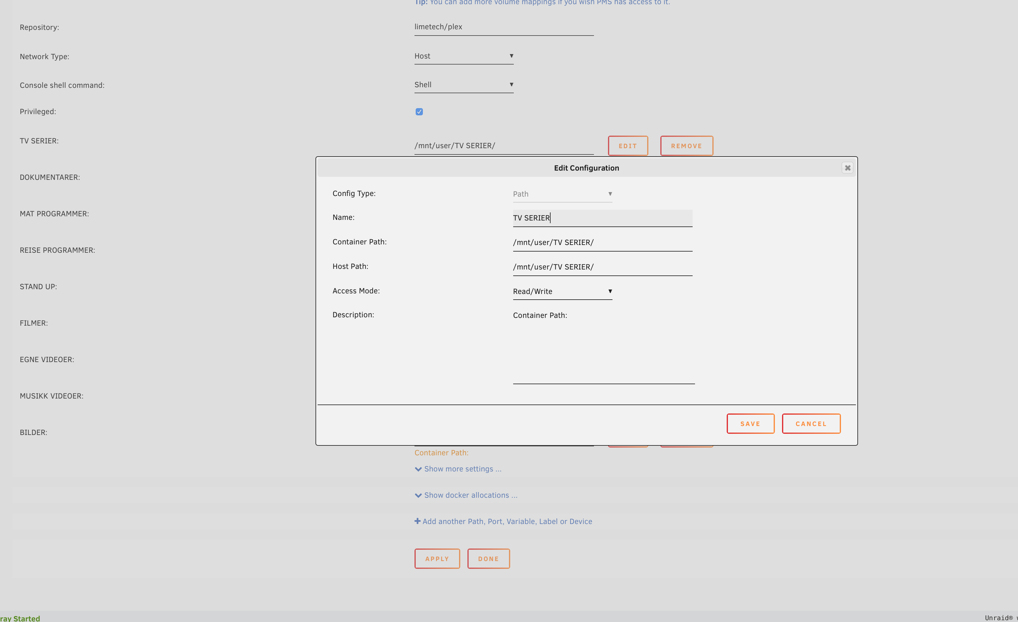

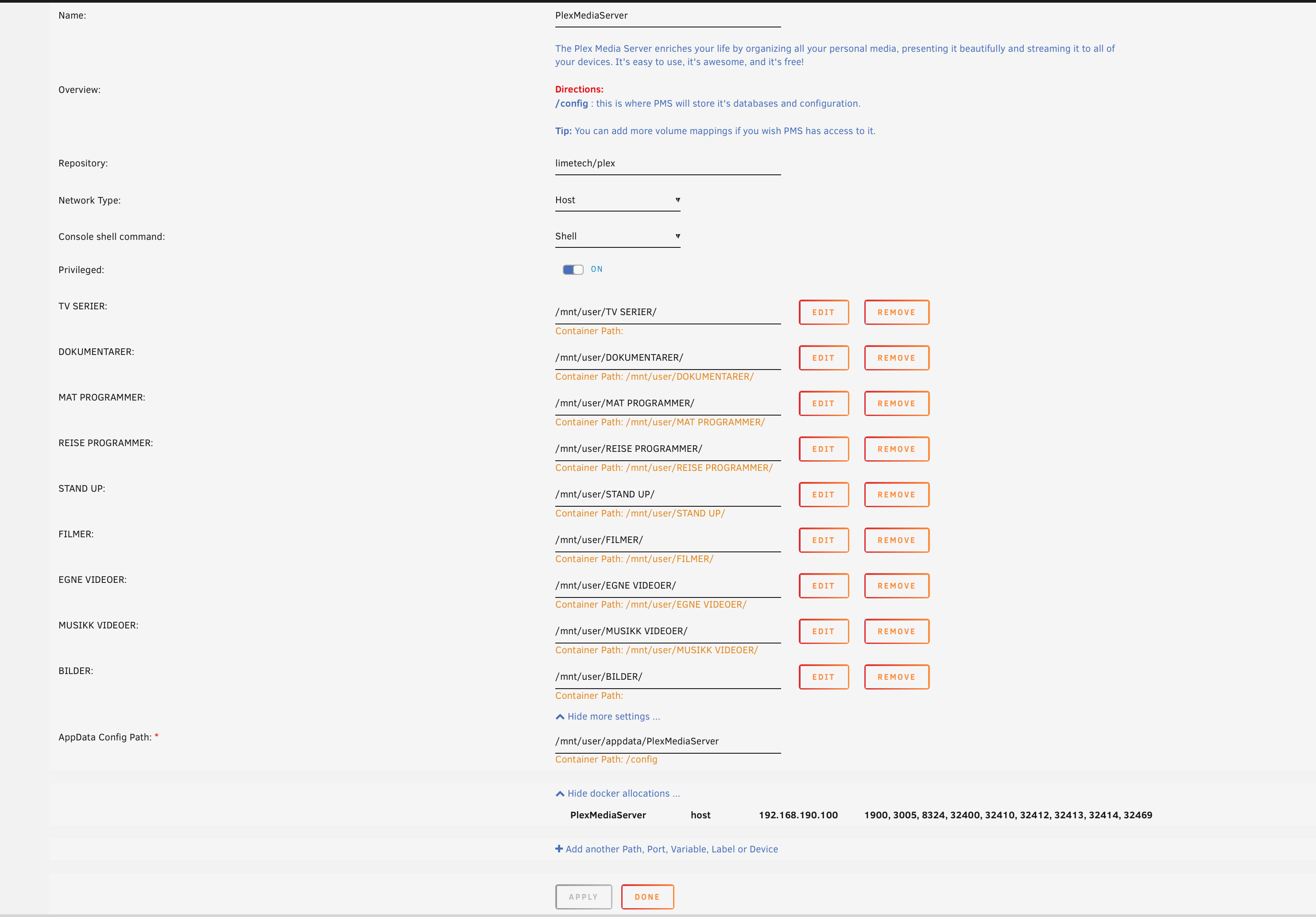

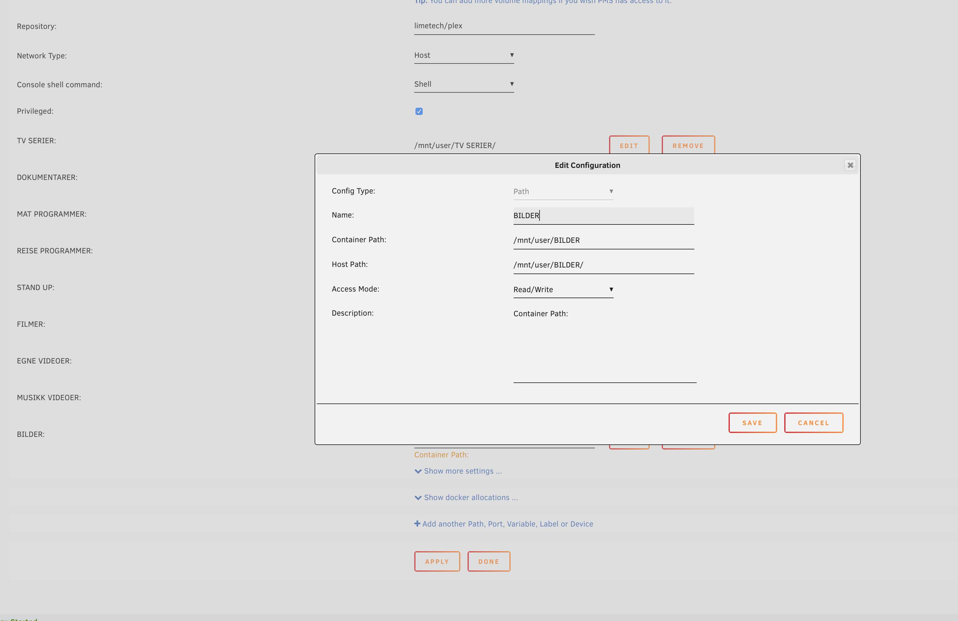

Looks like the first and the last don't have a container path. Click EDIT on the one for TV SERIER and post a screenshot.
Here are screenshots.
Is this sufficient, or is more info needed ?

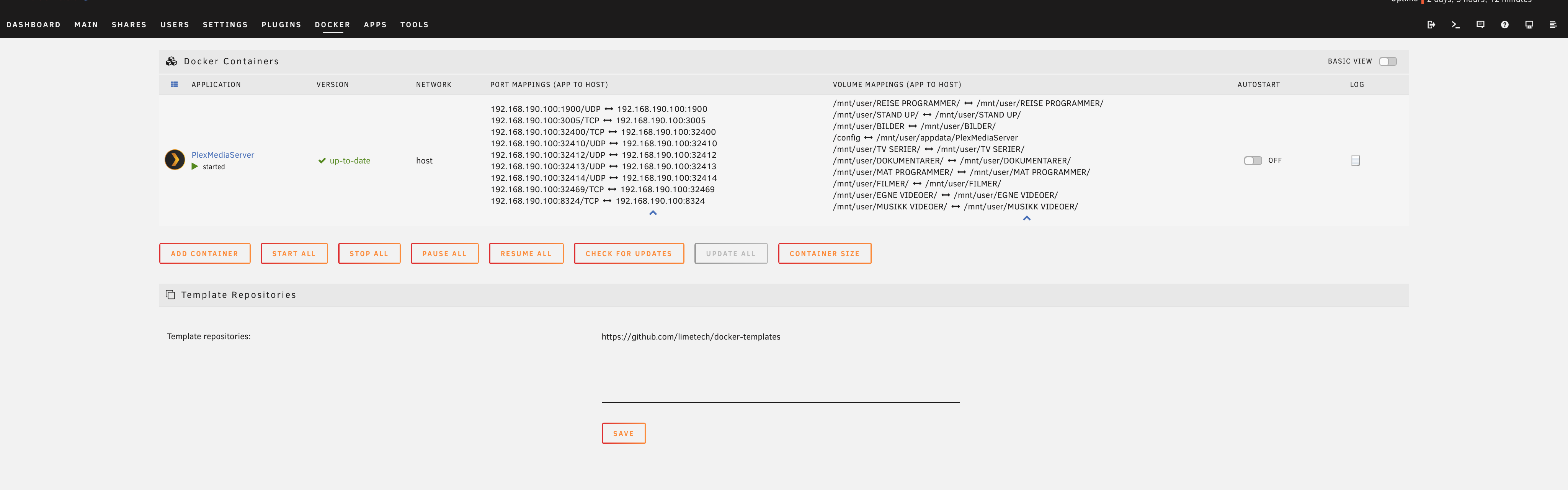

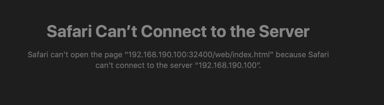

Just tried, and Plex WebUI is not avaliable (:32400).
That IP is the one for your Unraid server according to your diagnostics, but I am confused about the safari message. It seems to be saying it can't connect to that IP, instead of it can't connect to the 32400 port at that IP.
Just to make sure, can safari connect to your Unraid server at that IP?
192.168.190.100:32400 is Plex, but Safari says it cant connect to that server (ending with :32400). But Safari can (and do) connect to 192.168.190.100 which is where I do all my work on the Unraid.

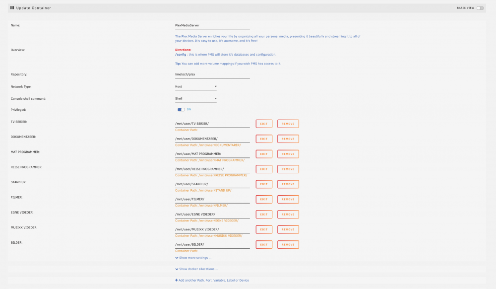

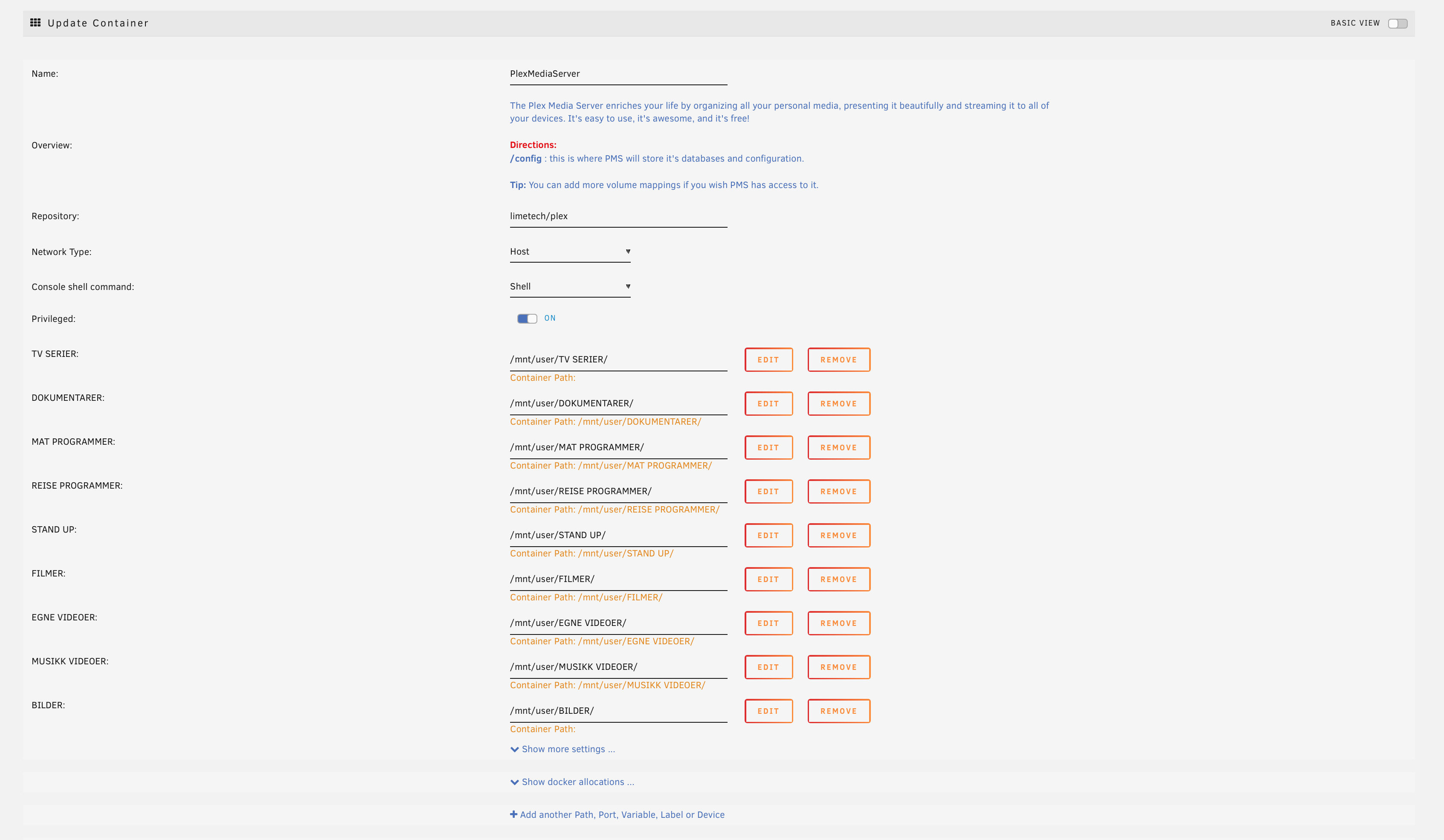

That was the problem, could not find a remove botton when I did this. Please see screenshot enclosed. I can only see remove shares for Plex.
No, that is the screenshot for the Update Container page. You were supposed to select "Remove" from the dropdown. You must have selected "Edit" instead of "Remove".
I don't know what you mean by this. I guess you mean Remove mappings on that page, but that is the wrong page.

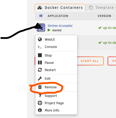

IT should look like this:
Click where the black arrow points.  Red circle should remove the docker
Edited by Frank1940
add 'art work'
You need to click on the icon (not the name) to get the drop-down menu.

In my browser (Firefox and WIN10), you get the dropdown with a 'left-click' of the mouse button.  (Just double-checked!)

And another way you can get that same dropdown is by clicking on the icon for your plex in the Docker Container section on the Dashboard page. That is where I usually work with my dockers that are already installed.
