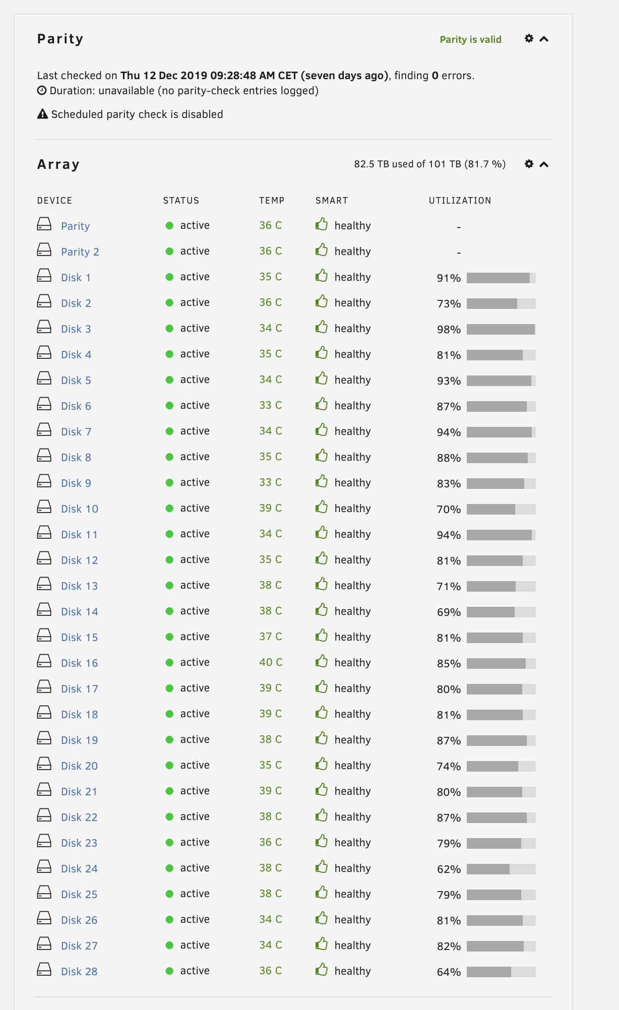

20 hours ago, trurl said:
This thread has gotten a little long now, and you have a lot of disks. I don't remember now so I will ask again. Do any of your disks have SMART warnings on the Dashboard?
Since we are talking about rebuilding to a new larger disk, it is worth noting that all bits of all disks must be reliably read to reliably rebuild a disk. So if you have any disks with problems they need to be considered before attempting to replace a disk.
Also, have you setup Notifications to alert you immediately by email or other agent as soon as a problem is detected? (Sorry if I am repeating myself, I write so much on so many threads and can't always remember what has already been discussed on any particular thread.)

22 minutes ago, trurl said:
I'm going to do some explanation here but first I want to say that your use of the word "add" in this context is somewhat ambiguous, and it often pays to be precise when talking about your data.
The only time Unraid requires a clear disk is when ADDING it to a NEW slot in an array that already has valid parity. This is because a clear disk is all zeros, and  has no effect on parity. So adding a clear disk maintains parity. If you add a disk that has not been cleared, Unraid will clear it so parity is maintained. Old versions of Unraid would take the array offline while it cleared a disk, so pre-clear was invented to clear a disk before (pre) adding it. Current version of Unraid will clear a disk without taking the array offline, so it is OK to let Unraid do the clearing and preclear is not needed for this.
In your case, you will not be adding a disk, you will be replacing a disk. Unraid does not require a clear disk in that case, since the entire disk is going to be overwritten from the parity calculation anyway.
Some people still use preclear as a way to test disks and perhaps "burn-in" a new disk to get it past some of the "infant mortality". The disk will get some testing and burn-in anyway just as the result of the rebuild, and a non-correcting parity check is often recommended after to confirm the rebuild went well, so that would be even more testing and burn-in. As long as you keep the original disk with its data intact you shouldn't have any data loss even if there is a problem.
Yes, you are right. Replacing is the correct word. My english is not that good all the time. :)
No warnings as I can see on the dashboard.

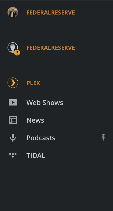

Notifications was setup, I saw. Just was not checked off to send emails. So now that is done. I have added the new Plex, but I still can not find my shares in Plex. First time I installed Plex it was easy, now I can not even find the shares or media folders when I try to add movies, tv shows etc.
Also Plex shows my server name twice, not sure why. Some old library or archive ?

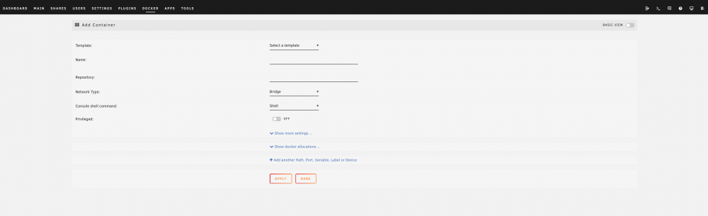

This page (from docker) ?
I wanted you to go to Apps and choose one of the Plex dockers, then click its Download button (the down arrow). That would have taken you to that Add Container page, but with a lot of things already filled in.
Then we could consider what needed to be changed or added to that page before you actually pushed Apply.
Remove your plex docker and try again, starting from the Apps page. Don't Apply but instead post a screenshot.

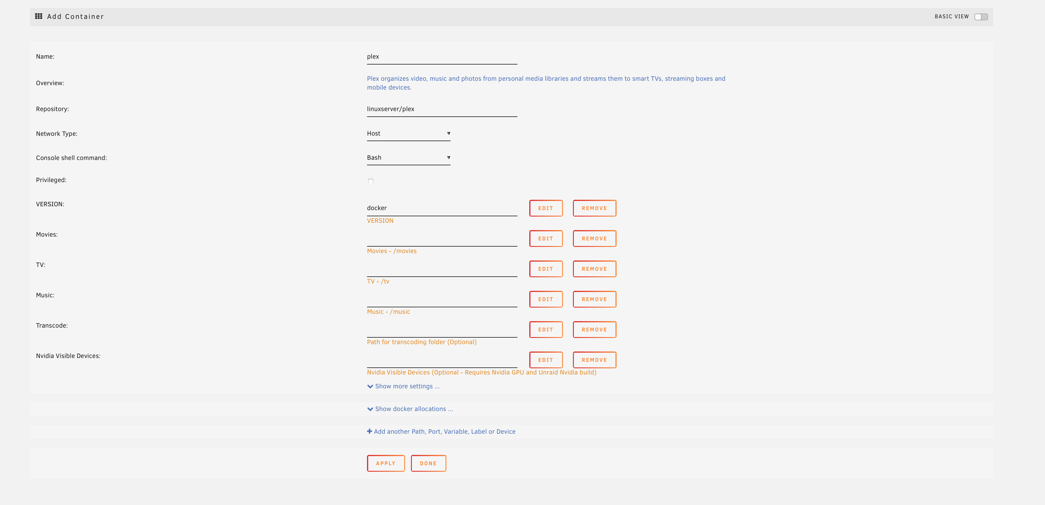

Ok, done. This is what I get when I download (linuxserver) Plex again, before hitting "apply".
OK that screenshot has a few things hidden (some defaults) but I just checked with mine and all of the hidden things look like they should be fine.
That template has places for you to fill in the path to your Movies, TV, and Music. You can also add more if you need to.
An even simpler way is to just ignore those and add a path to all of your user shares. That is how I have it even though you could argue it is less secure that way. I don't think plex is going to do anything with those shares I don't tell it to use and I don't have anything to hide anyway that isn't already encrypted.
So how would you like to do it, separate paths or all shares?

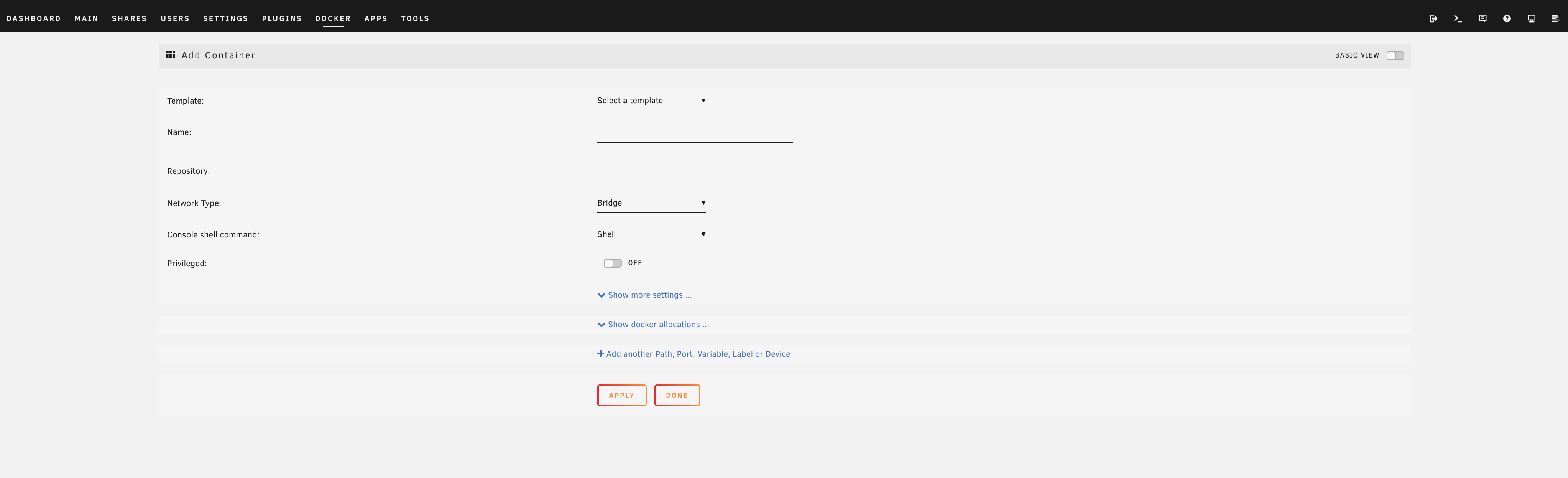

OK, click on the blue text with the + at the bottom of that Add Container page, where it says Add another Path....

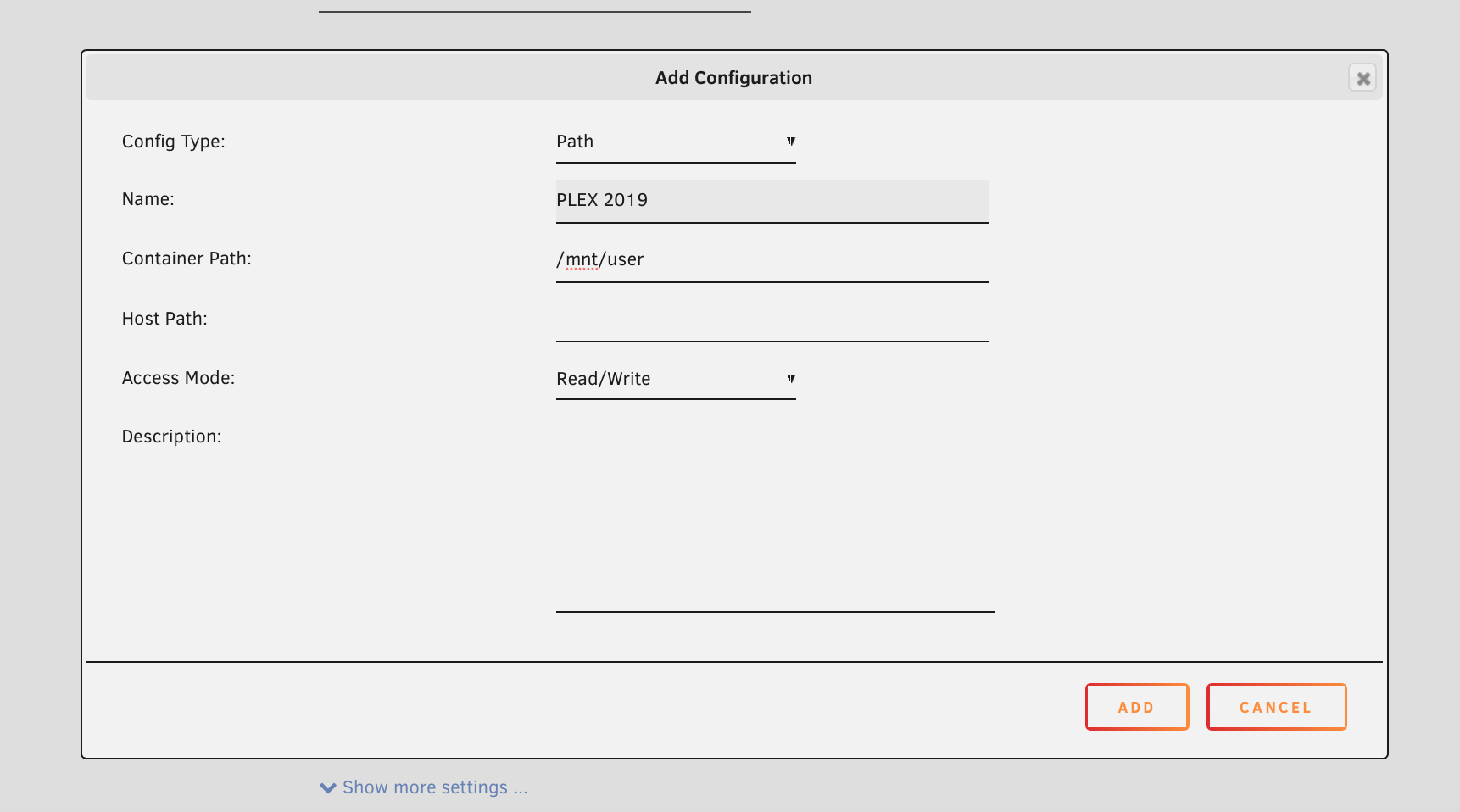

Ok, so then I will enter  /mnt/user in the "Container path" ? What about in Host Path ? And Name - can I just enter any name for my Plex server (should I avoid using the same name as the server, which is FederalReserve on my network) - I just entered PLEX 2019 in this example ?
Also, should it be "Read" only for Access Mode ? Or does PLEX need to have write access ?
What you put for the Name isn't important, it is just a label for that particular volume mapping which will serve as a reminder to you if you edit the container later. For example, you could put Media.
That Container Path is NOT correct. That is what you need to put in the Host Path. Unraid is the Host, and that is how you specify the path on the Host.
For Container Path, you can put anything you want, but it must begin with / so it will be an absolute path. For example, you could put /Media.
I have Read/Write. It is possible to use plex to delete things, such as a Movie you don't want to keep, so if you want to be able to do that from within plex it needs to be Read/Write.

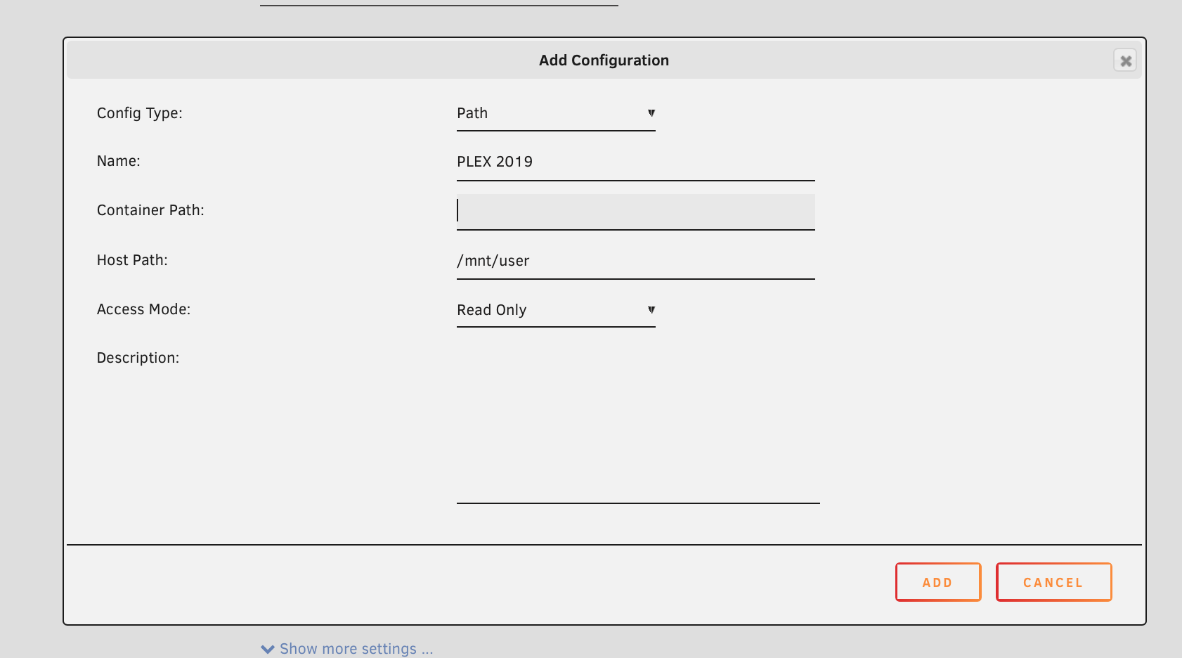

OK, here is something that may have you confused.
When you try to specify the Host path, it is going to give you a dropdown folder tree to allow you to select the path. That folder tree shows you each of your user shares separately. To get a path that includes all of the shares, you need to go up one level by clicking on the .. folder at the top, and then select the folder that says user.
Post a screenshot of that Add Configuration box when you think you have it like you want, or if you have more questions about it.
So like this ? Or I am just confused...about this share, map and so on...  I guess it should not say "advanced member" under my name ;)
That is OK as far as it goes. You need to set the Container Path.
You need to fill in the Container Path with whatever you want to use as your access point inside the container, whether that is /media or /Media, or something.
Whatever you put in that box is where you will navigate to inside of plex to pick up your content.
