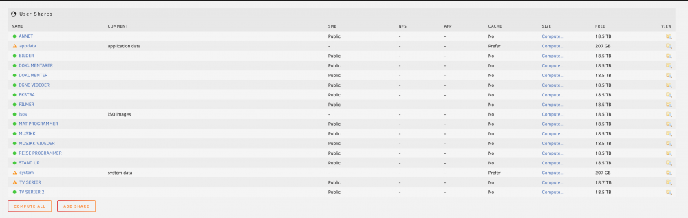

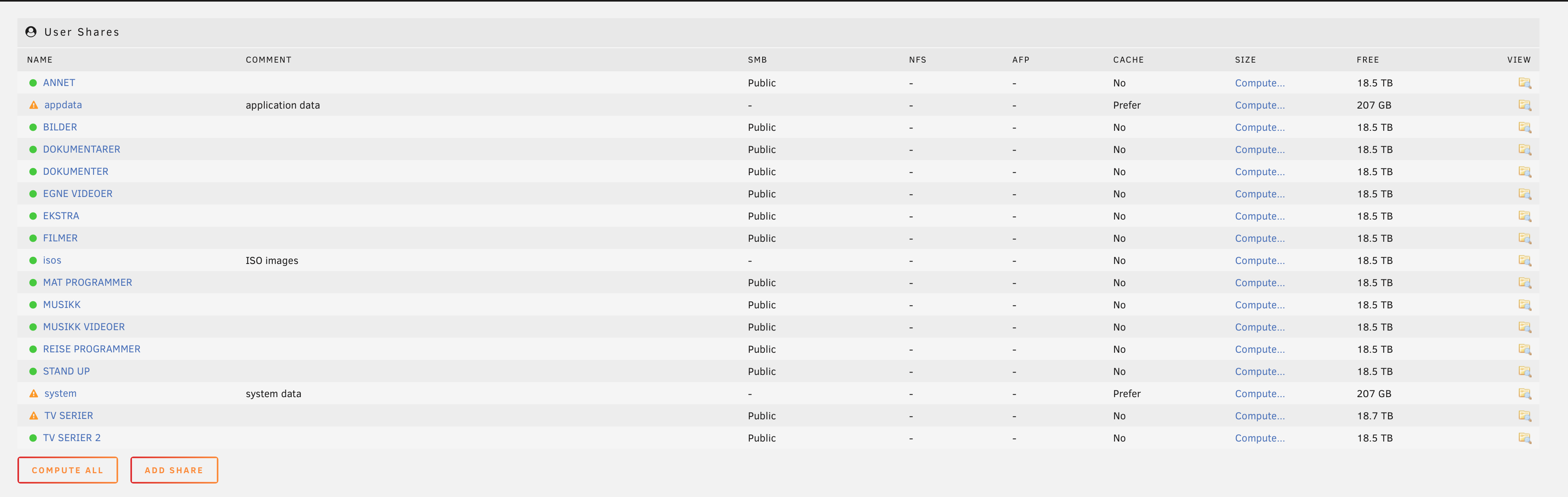

Thanks guys. So I have changed all user shares to Include: All and Exclude: None. Here is a photo screen shot of the shares. So whats the next step ?Also I got a message that I did not really understand - is it about using cache?

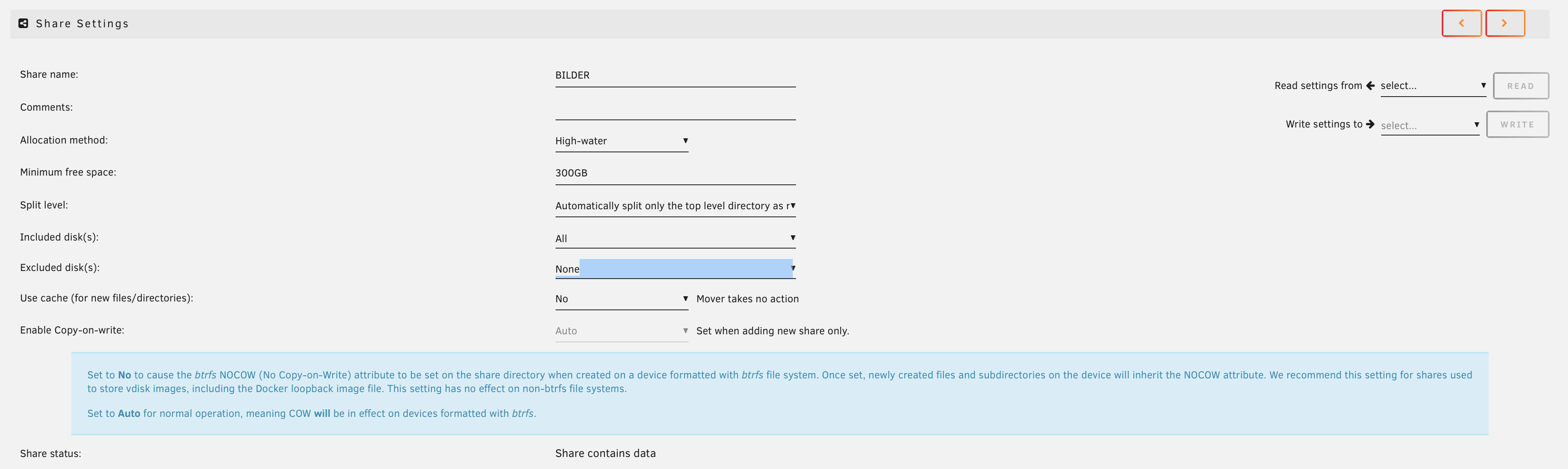

What message? If you are talking about that text in the blue background on your first screenshot, that is just the Help text for the Copy-on-write setting. Don't worry about that.

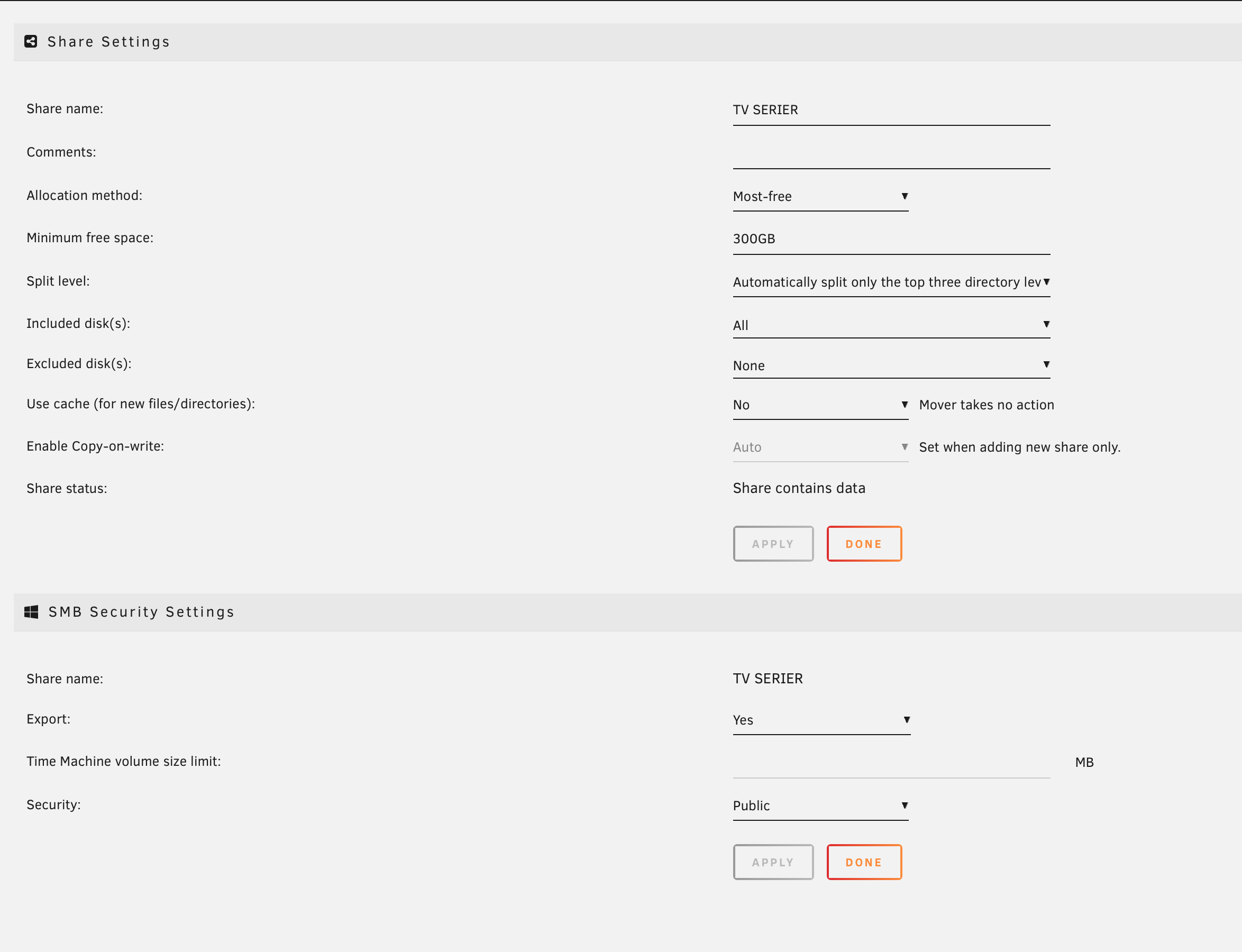

You can follow along with this next part by looking at your diagnostics yourself. They are just text files, and the share settings are .cfg files in the shares folder. Many of the files in the diagnostics are the actual configuration files where your webUI settings are stored.
The reason I wanted to see your actual share names is because some of them happen to begin and end in the same letter and they have the same number of letters. The diagnostics anonymizes your share names by replacing all but the first and last letter with -. Since this can make some of them have the same anonymized name, one of them gets (1) appended to the end in the diagnostics. So I wanted to be able to talk about them using their real names.
Your shares that begin with M and end with R are like that, and their settings look OK for now.
You have 2 shares appearing in your diagnostics that begin with T and end with R, and I am not referring to the one that actually has the number 2 at the end.
One of these shares doesn't really exist on the array (and so is not in your screenshot), but it has settings for it. The other does exist on the array, and has no settings, so it gets the default settings.
Post a screenshot of the Settings for the user share named TV SERIER.
When I was doing the Include/Exclude adjustments to the shares, I also renamed one that has had a wrong name for a long time. Thinking of it now, I should have waited because it is confusing (different name in diagnostics vs in user shares). I have added a new diagnostic now with the updated share names. Also I add a photo of the share TV SERIER - as requested. How do we continue ?
federalreserve-diagnostics-20191214-1910.zip

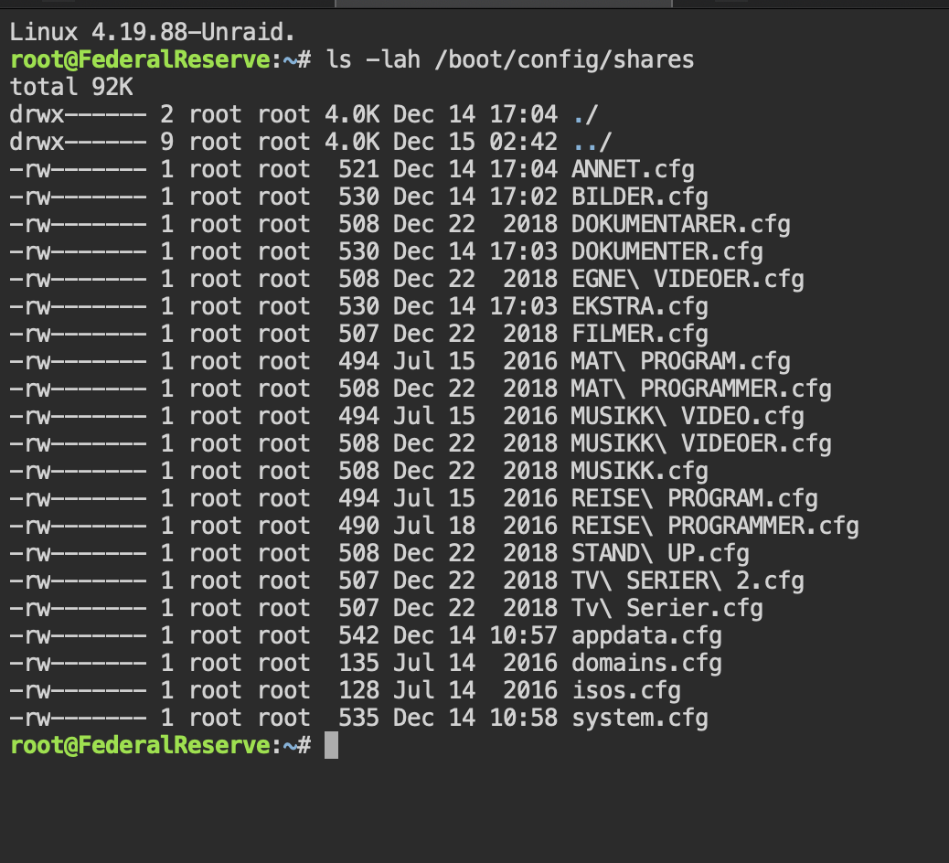

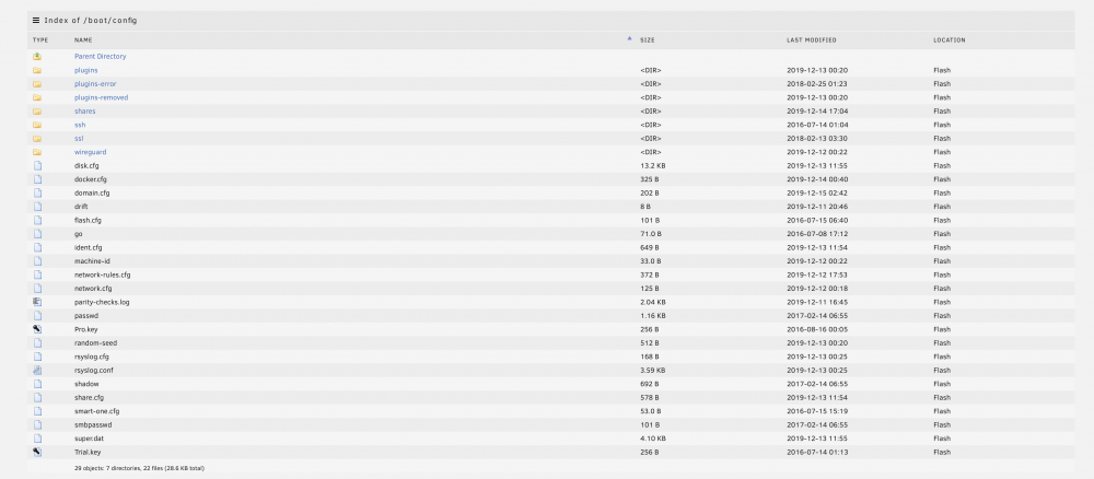

That is the puzzle. According to your diagnostics, the share with those settings doesn't exist on the array, and another share with a similar name does exist but has no settings.
What do you get from the command line with this?
ls -lah /boot/config/shares
Where do I find the command line ? Sorry for being such a rookie about Unraid...
On the menu bar the button that looks like this: >_
I'm just trying to see which files are in config/shares on the flash drive.

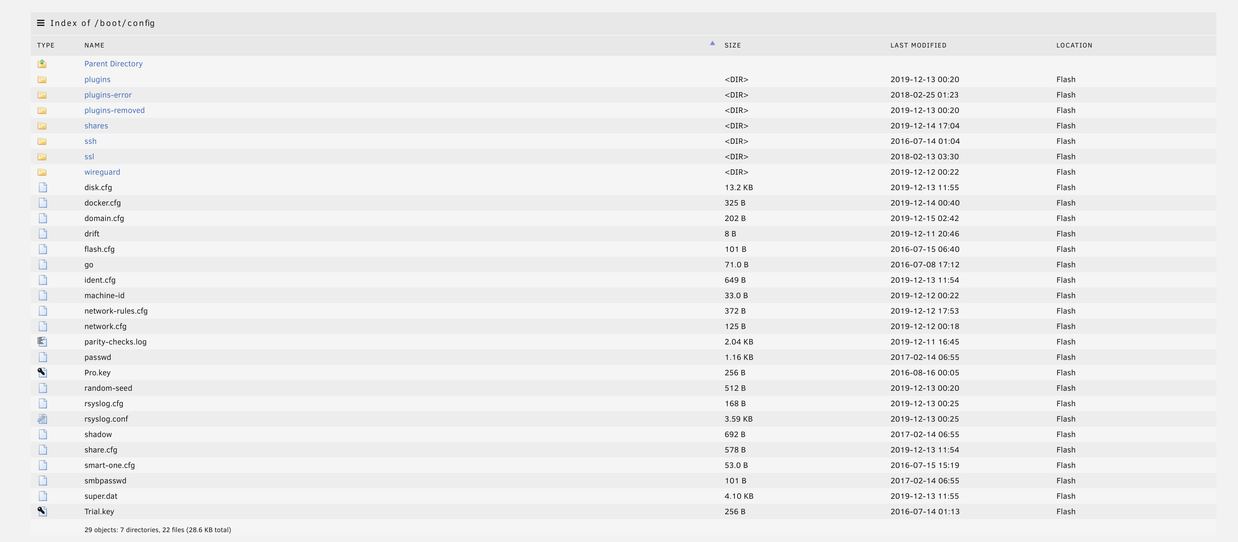

Here is another way to get what I'm after.
Go to Main - Boot Device and click on the folder icon at the far right of the line for Flash. Then click on config. Then click on shares. Then post a screenshot.
Here are both
