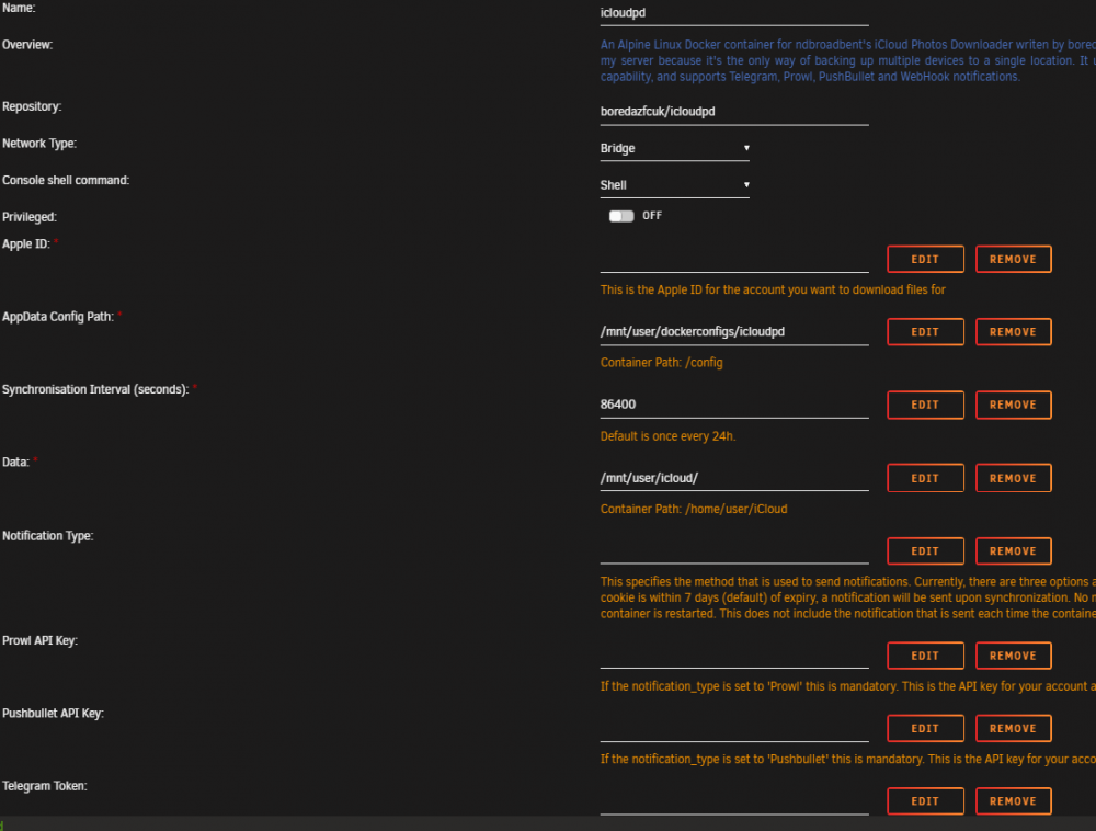

I would like to install icloudpd as docker on my unraid server. That worked great. But since we are several people in the house, I need a 2 instance. However, the program always asks for the .mounted file in the iCloudpd folder, even though I renamed everything to iCloudpd_test. Is it possible to change the path of the failsafe file, .mounted? Original: /home/user/iCloud/.mounted Modified: /home/user/iCloud_test/.mounted. Thanks very much!

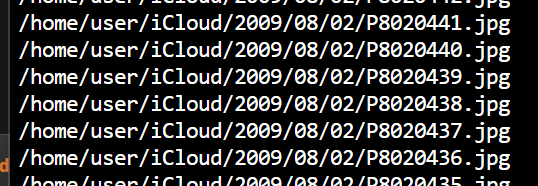

How long (in general) would you expect photos to start showing up in the share I created? I checked the log for icloudpd and am seeing stuff like this
but I'm not actually sure where these are being created. I have created a bind mount for /home/user/iCloud to /mnt/user/iCloud/ but there isn't any data actually showing up there. Is that normal? The docker has been running for about 20 minutes now -- is is actually downloading files at this point, or is it indexing everything prior to downloading?
Update: I guess it was just indexing! About an hour after it started, files started showing up in the share

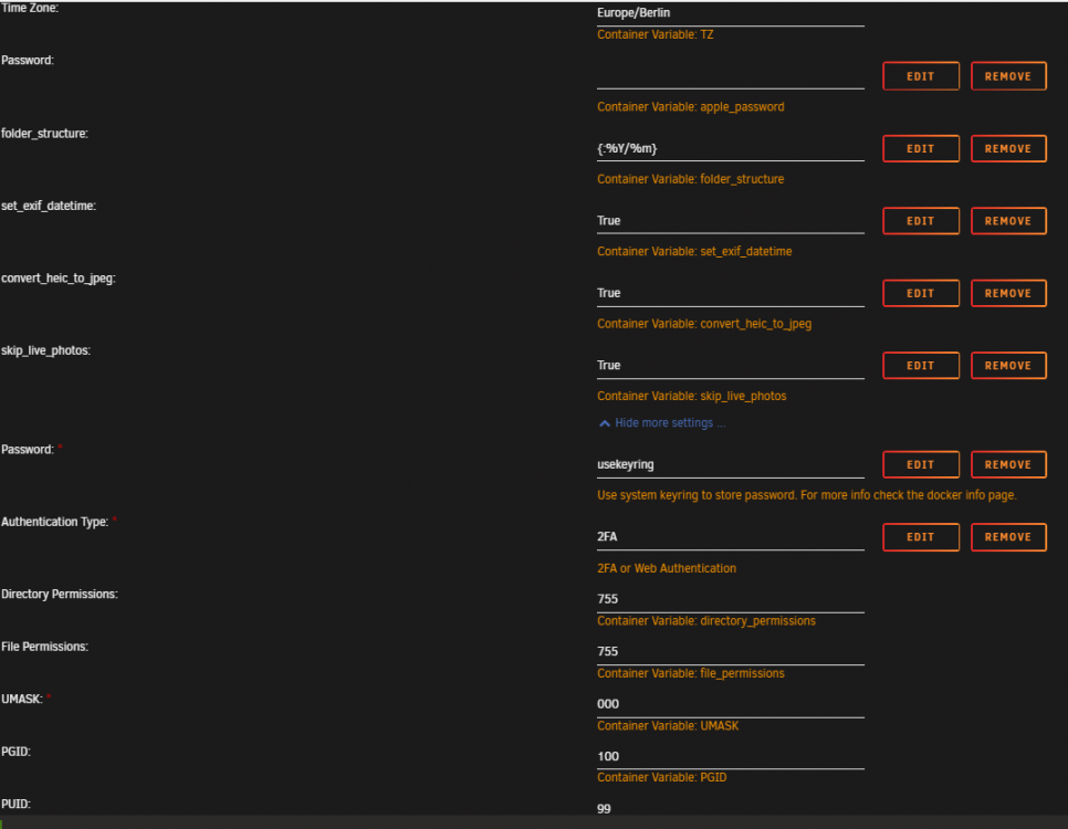

I’m using this template, but it seems to not be configured properly? It creates the file but with a different user. I had to add user_id: as a variable and then set it to 99. Now it shows as the right owner.
I think the variables already defined don't match what is needed according to this. File permission and directory permission do not seem to work also...
Am I alone in this?
Thank you!
  • 2 months later...
Am I alone in this?
Thank you!
I had to run a chown on the directory to get it to work, but now works fine.

Is it possible that the Unraid CA template isn't passing the information for telegram correctly? The token is entered in the CA template, but it doesn't appear in the log.
See issue #913 at boredazfcuk docker-icloudpd
