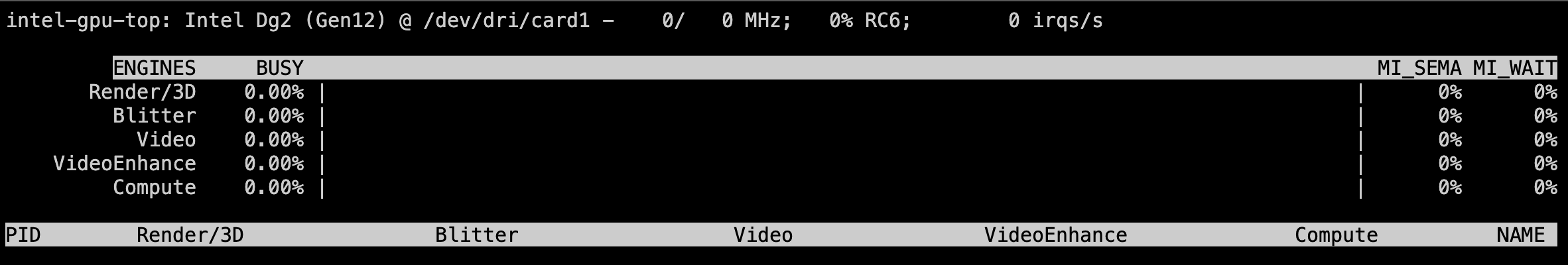

7 minutes ago, Masterwishx said:
Used ```.7 1.9``` + 2000 (or 4000) Fixed issue of error , but cant see any load ....
Does intel_gpu_top show anything
Only 0.00/24.25W changed.
Not sure how to make load, using mostly Immich for igpu, also have a lot of containers like nextcloud, jellyfin (not started)

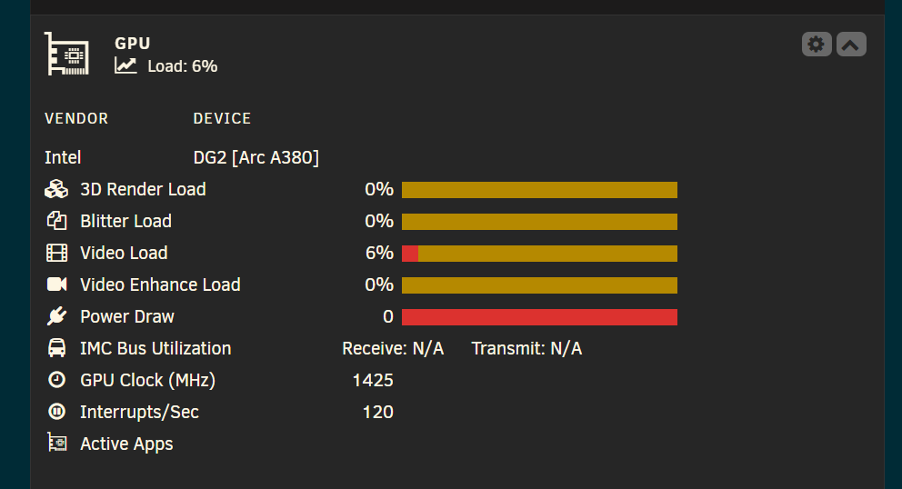

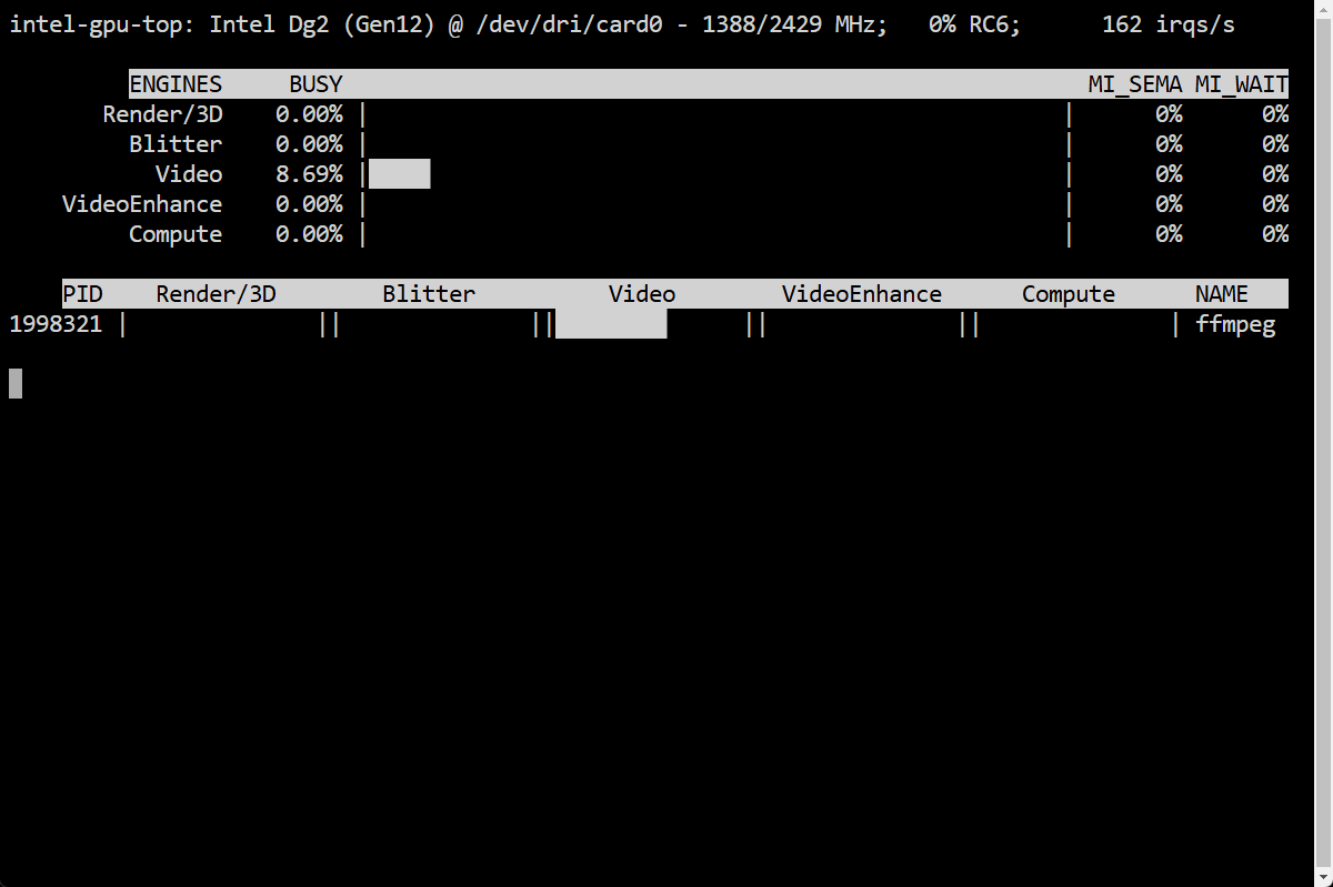

using arc A380 on AM4 with 5900x
Stats showing little to no video load, while intel_gpu_top  shows 50% load on video. As well as unable to read power draw, IMC bus receive and transmit. Other stats also inaccurate as i'm transcoding videos to av1 via a docker a friend is working on to automate transcoding of all media to av1.
Edited by Duckers
From what I can see gpu top is showing 8% for video also DG cards do not show power usage and other stats. RC6 is used for power.
XE driver and later kernels will be required for DG improved reporting.

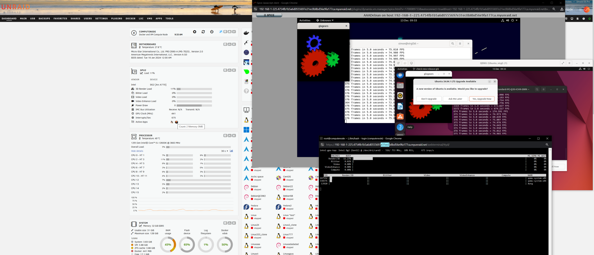

image.pngThis is how my A770 shows.
This is showing testing for virgl for a future release.
