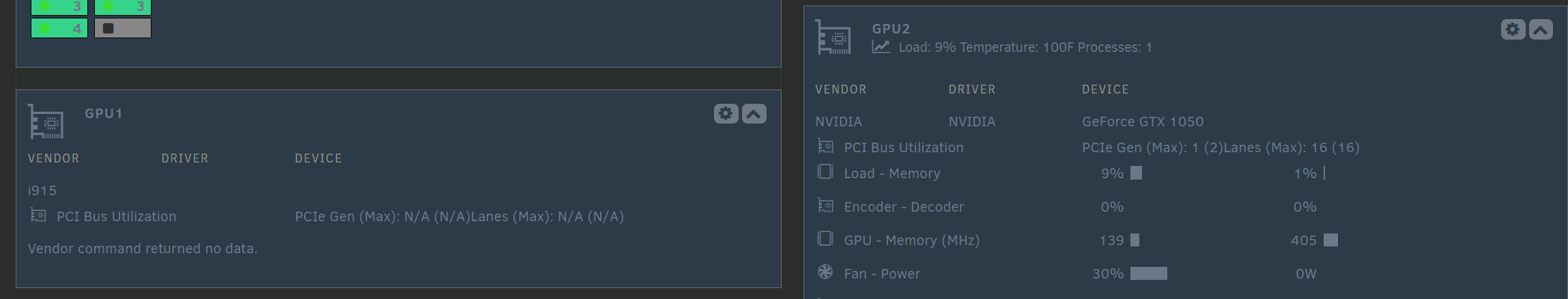

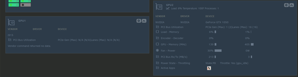

32 minutes ago, 5STAR said:
Hey Gang,
I downloaded today's update the GPU Statistics and it says "Vendor command returned no data".  All GPU stats are non existent.  I have a nvideo P2200 and it's always worked.. any thoughts
Fix will be available in 11a
OK all fixed with the released 2nd patch today.
I need to go back to the previous release as this release show no data whatsoever.
2nd patch still can't find vendor utility
Edited by Murderhobo
Are you on 11a?
Try ctrl + F5 Which os Vers?
Does nvidia-smi provide output?
I am on 11. Last WORKING version was 0301
Done and appears to be working.  I shall test with a movie and popcorn ;=)
Thank you.

On unraid 7.0.1 ofc and 11a
added pic

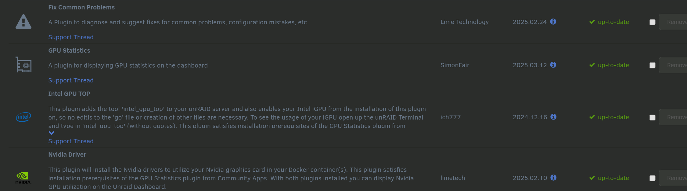

Update to 2025.03.12

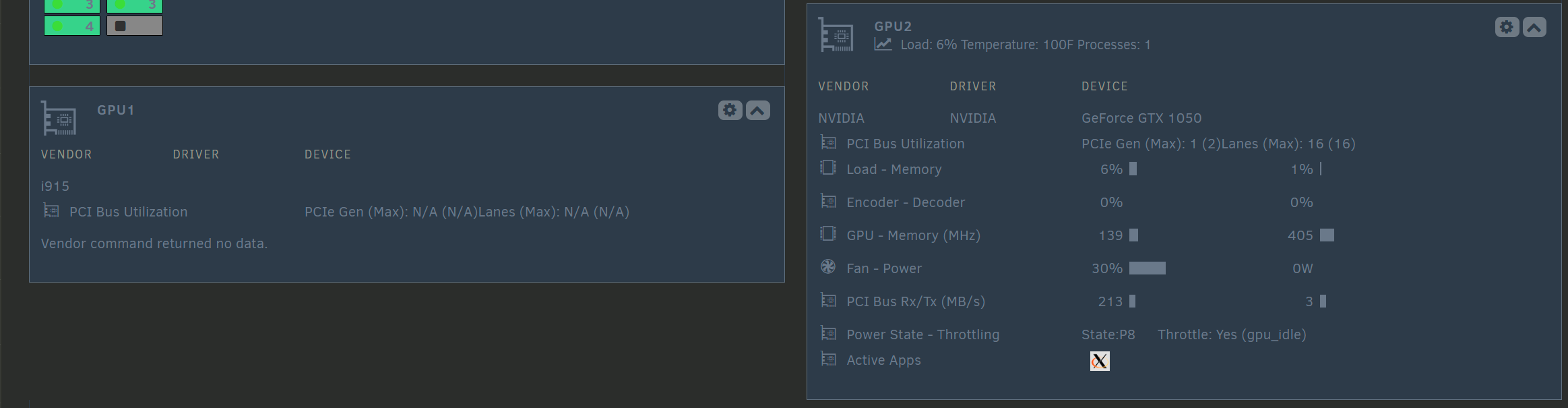

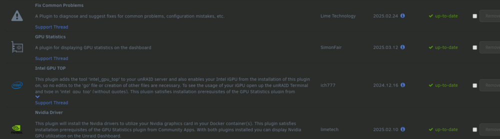

I just bought an Intel B580 Battlemage and am trying to get it recognized by Plex and Unraid as well. This is the cards I have in my server now. The GTX 1050 is just for GUI on a monitor purposes. However it is the only one Plex shows. image.thumb.png.c3355189baff8dac9fe2a43147cc06ca.pngimage.thumb.png.0ced5f326f130120200fc1f97e200c93.png
I followed the rabbit hole and I am on Unraid 7.1 and I installed the 2025.03.12 version of the GPU Statistics
But nothing is working for the Arc B580.image.thumb.png.04b099423bb5cb84d54b3a3ac328f52a.png
I saw previously a call for volunteers. Reporting for duty as I need help.
