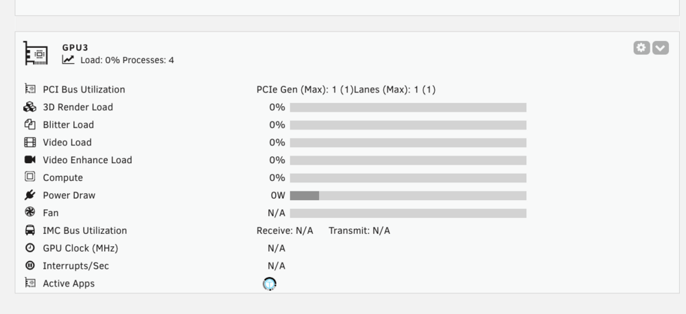

2 hours ago, Domokun said:
interesting, SMI shows 1w usage for the data i sent over w/ max of 70 but just reinstalled the app and now its working fine on my system too
Power in xml is 23w will look to see why the bar is not working correctly.
dg1 gpu doesn't show correctly

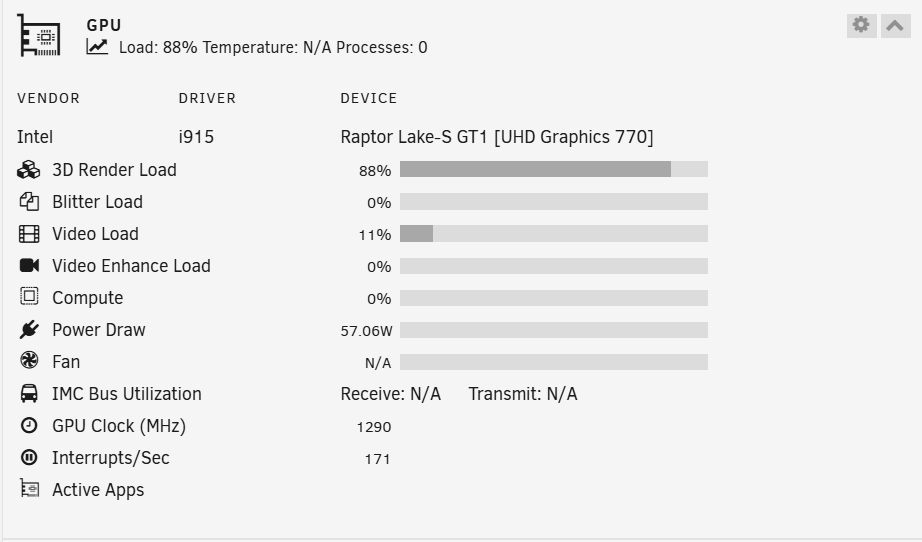

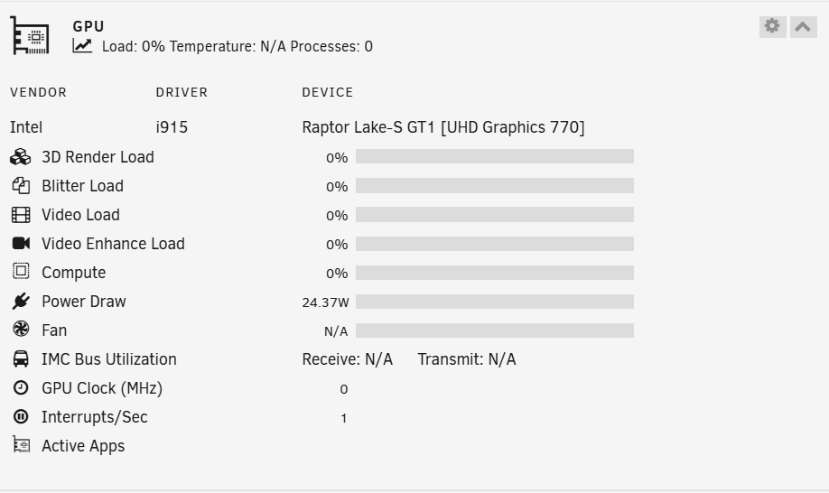

@SimonF I have a 14900K and the black bar for power draw is not seen, it is just white. All options enabled on the plugin settings and on the latest plugin version. Unraid version is 6.12.15.
Active apps icon is also missing. Its actually jellyfin. Prior to the update, it was working properly.
Edited by mans_
The power is problem matic as stop does not always report rc6. App I think you need to be on 7 as needed changes to the driver in newer kernel.

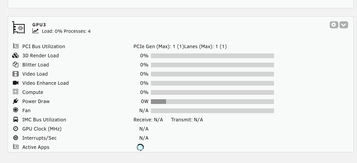

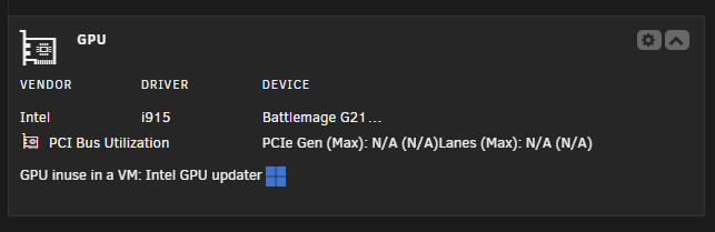

Want to say that the combo of the latest GPU stat/Intel_gpu_top plugins have broken the baseline detection I had with my Arc B580. Unless its always been "broken" and the latest updates simply exposed that.
The GPU works via passthrough to a Windows 11 VM (installed the latest Intel GPU Drivers through this VM as part of troubleshooting this situation), the GPU is shown as an option to be selected in the gpu stat options, see below.
Although the widget still reports the following.
This used to function. I also updated the kernel to 6.14.1, updated to Unraid 7.0.1 as well as removed/reinstalled both plugins. No change. Same output of lspci -k in the comment below.
Edited by jaybird2203
Intel_gpu_top does not work for BM so I have to pull info from other locations.
Mainly from  $basePath = "/sys/bus/pci/devices/$pciId";
Support is limited on kernel 6.12. Can you provide diagnostics
And tree /sys/bus/PCI/devices/0000\:0a\:00.0
10 hours ago, jaybird2203 said:
does a file called /tmp/inteljson exist on your system?
if not can you create this file with nano /tmp/inteltest.php with the content below
then run as with php -f /tmp/inteltest.php and provide the return data. I have tested the latest with arc770 on 6.14.1 and works on my system.

inteljson did exist in my tmp folder, here's the contents before i deleted the file then the command was ran.
tmpinteljson.txt
output of inteltest as copied, also wasn't sure if the buildXEJSON id was supposed to match my details or the 04 that was written but there was no difference in the output between 0000:04:00.0 or 0000:0a:00.0
04 php test.txt
Thanks, yes sorry forgot to say will need to change to match your Pciid.

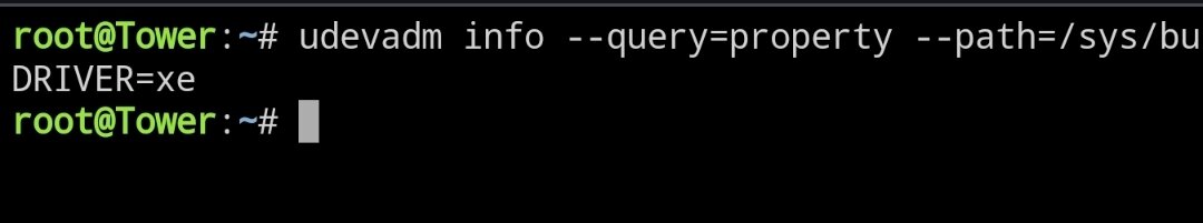

can you confirm this reports XE?
udevadm info --query=property --path=/sys/bus/pci/devices/0000:0a:00.0 | grep 'DRIVER='
Confirmed, it's lower case xe though if that makes a difference or not

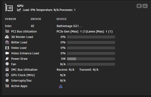

Just to throw some more details at this. When i have the GPU passing through to my VM and actively transcoding within the VM the details "change". See below. Prior images/data were pulled when the GPU was not being passed through to the VM.
Yet while I have another docker actually using the xe driver and also transcoding content the client portion of the plugin does update but the rest appears to be empty (which is expected due to null responses).
At present I have to create a json for XE cards as there is not a version of intel_gpu_top that works for XE.
There are not many exposed sysfs areas. needs kernel 6.16 for fans. I will chase my request for documentation from intel.

Hello,
Wanted to report that it's doesn't seems to work with the Intel B580 arc gpu.
Saw that someone else reported it.
Thank you
