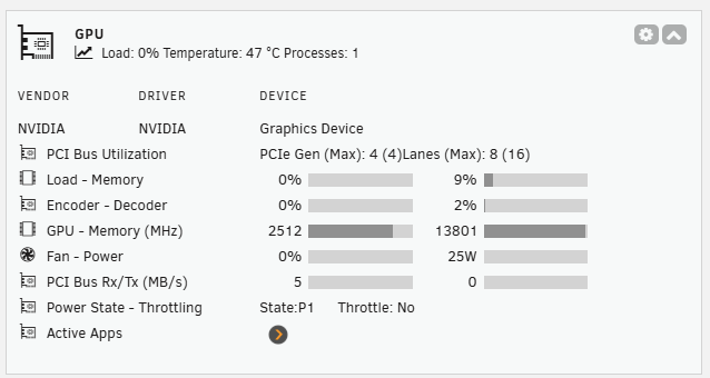

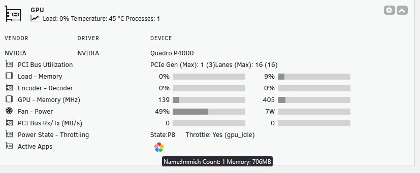

21 hours ago, Maximo101 said:
Is the Fan Power (watts) the total draw of power from my gpu, or is there more power used over the fan?
They are two settings fan is one bar rpm and power is the other for the GPU. So it is the total power used by the GPU.
12 minutes ago, bmrowe said:
I do notice the compute bar seems inverted. Like higher compute makes the bar shrink and less compute makes it grow
Thanks will look into that.
Will be fixed in next release.

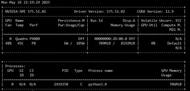

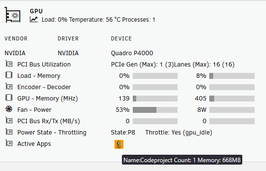

On 5/26/2025 at 9:36 PM, Akagami said:
CodeProject.AI docker (codeproject/ai-server:cuda12_2) with Object Detection (YOLOv5 6.2) is incorrectly reporting in the nvidia gpu plugin (Nvidia Driver Version: 575.51.02 - plugin up to date 2025.03.25) dashboard as beeing in use by "immich (python 3.8)" as i do not have immich installed i had to trial and error restaring all dockers with gpu to find it. I just recently noticed this as before i had never seen the codeproject docker reported in the plugin
Can you run php /usr/local/emhttp/plugins/gpustat/lib/Pidcheck 3459075 where the number is the PID from nvida-smi and post the results.
PID is:2590993
PID Info
python3.8/app/preinstalled-modules/ObjectDetectionYOLOv5-6.2/detect_adapter.py
Parent for PID Info
ps j 2590993 | awk '{ $1=$1 };NR>1' | cut -d ' ' -f 1
Parent PID:2590593
./CodeProject.AI.Server

###2025.06.02
- Fix AMD Power readings for different card types.
- Fix Compute Bar
- Fix CodeProject detection
On 6/2/2025 at 7:33 PM, SimonF said:
###2025.06.02
- Fix Compute Bar
works like a charm
Thank you, so my gpu is using 180w in this image (ollama running a local ai model responding to a complex task, as it idles at 10watts)
Yes that is correct.

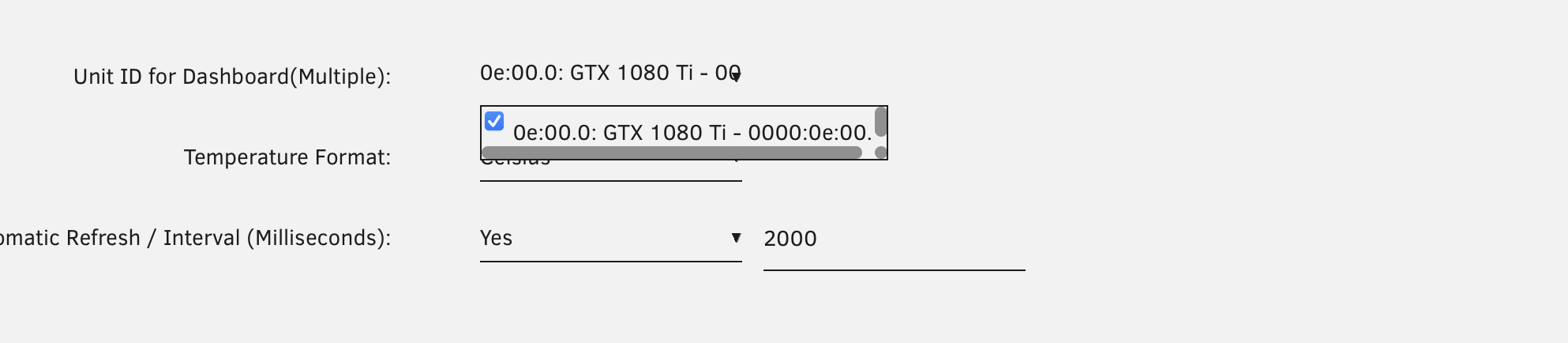

Hi I just got my nvidia 5060 gpu working with opensource nvidia plugin driver. However, now the GPU Statistics plugin is not working on my dashboard. Is this GPU supported? Is there anything I can do to get it to work?
I forgot to select the GPU ID in the plugin settings. But its not reporting the GPU device model. For the record device model is not shown in the opensource nvidia driver plugin either. I have seen other screen shots with 5070 ti's posted above. Any advice is appreciated.

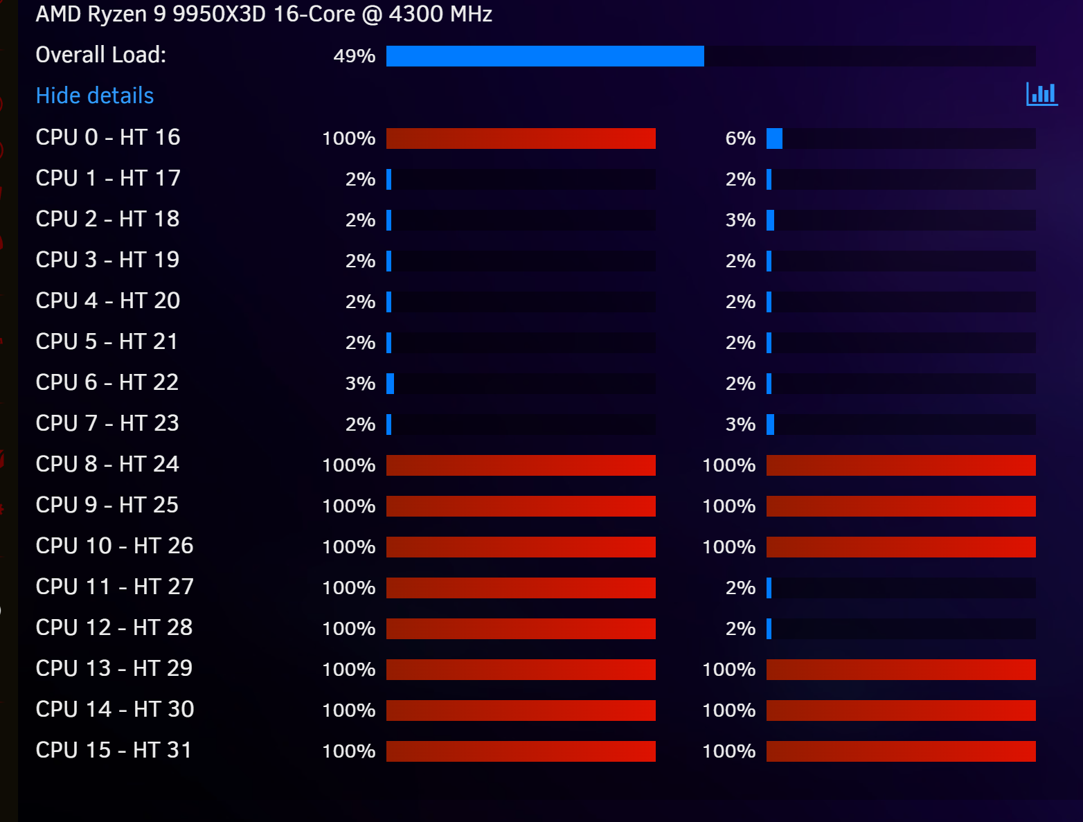

Title: Severe CPU spike and system instability after installing GPU Statistics plugin
Description:
After installing the GPU Statistics plugin on my system, everything becomes unstable. CPU usage spikes, the system becomes sluggish or freezes intermittently, and GPU passthrough behavior becomes unpredictable.
These issues occur even though:
  • Both GPUs are in separate IOMMU groups,
  • Proper drivers (including open-source NVIDIA drivers) are installed,
  • No VM is using both GPUs simultaneously,
  • PCIe slots and device assignments are configured correctly.
No changes to drivers, device bindings, or PCIe ports fix the issue.
The problem immediately disappears after uninstalling the GPU Statistics plugin.
Setup:
  • Gigabyte X870E AORUS ELITE WIFI7
  • AMD Ryzen 9 9950X3D
  • GPU 1: RTX 5080 (passed through to VM)
  • GPU 2: RTX A2000 (idle or used by host)
  • Unraid 6.x (7.1.4)
Please investigate this – it’s 100% reproducible and tied directly to the plugin being installed, regardless of active GPU usage.

Do you get the same effect running nvidia-smi? Is 5080 bound to vfio?
