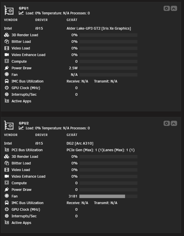

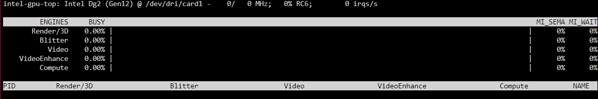

Hey,
what can i do to see the "Power Draw" for my Arc310 Card?
Intel_GPU_Top do not show the Power Draw but NVTop shows it...
Thanks for Help on this!

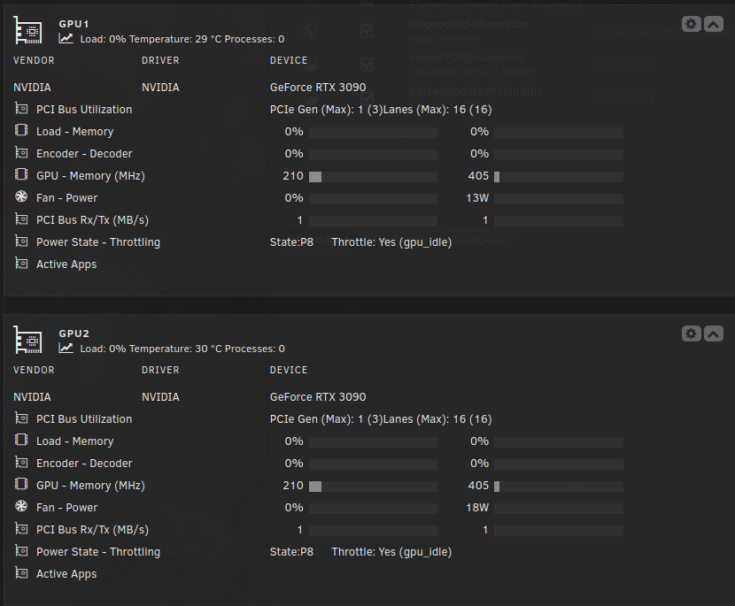

  • I did some more work to get it to look like the CPU sidebar that comes with unraid
  • I have created a PR for b3rs3rk's plugin to add MultiGPU support for 6.12 as Dashboard panels are different in 6.12. The PR works on pre realeases but does not provide Multi support. There are some ot
22 minutes ago, Brudertac said:
Hey,
Will look a source code from nvtop to see how they calculate.

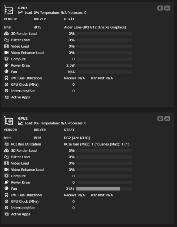

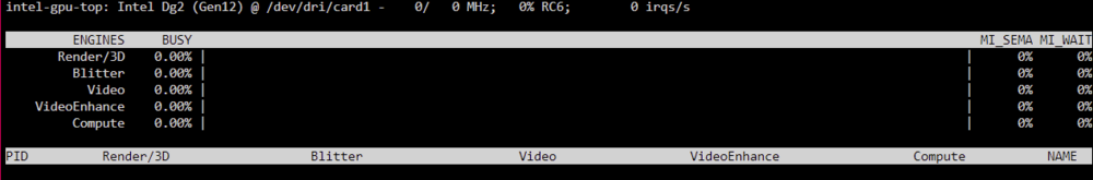

Hello - thank you for this excellent plugin - I'm wondering if this is only a cosmetic issue or how I could confirm for sure this detail:
PCI Bus UtilizationPCIe Gen (Max): 1 (1)Lanes (Max): 1 (1)
My system is Gen 3, and its an Intel x8 card in an x16 slot.
I believe this might be related to the previous couple of posts as its an Arc310 as well.
Edited by shwa87
It is because the way the card reports itself in sysfs, it is a cosmestic issue, the card will be running at faster than indicated, when looking at the nvtop code they look upstream to get a more realistic value I will see if I can do that.

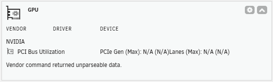

Had an issue where dashboard was not loading, tracked it down to gpustatistics plugin. Remove and Reinstall got dashboard showing again although it is very sluggish. Other tabs work fine.
/boot/config/plugins/gpustat/gpustat.cfg
MULTIGPU = "21:00.0"

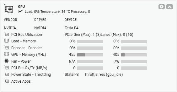

I've just replaced my GPU and I seem to not be able to get any stats for a Nvidia Tesla P4. Took a look at this conversation, but it seems like it was fixed in an earlier version. Any ideas on how to get the GPU stats back? I'm currently running v2025.08.05
Edited by 0weavern
Can you provide output from nvidia-smi -q -x
Sure - see below!

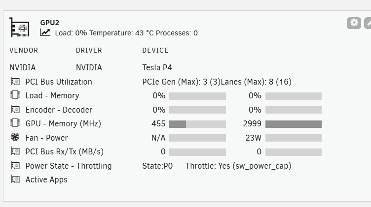

                        <pci_bus_id>00000000:03:00.0</pci_bus_id>
                        <pci_sub_system_id>11D810DE</pci_sub_system_id>
                        <pci_gpu_link_info>
                                <pcie_gen>
                                        <max_link_gen>3</max_link_gen>
                                        <current_link_gen>3</current_link_gen>
                                        <device_current_link_gen>3</device_current_link_gen>
                                        <max_device_link_gen>3</max_device_link_gen>
                                        <max_host_link_gen>3</max_host_link_gen>
                                </pcie_gen>
                                <link_widths>
                                        <max_link_width>16x</max_link_width>
                                        <current_link_width>8x</current_link_width>
                                </link_widths>
                        </pci_gpu_link_info>

                <gpu_power_readings>
                        <power_state>P0</power_state>
                        <average_power_draw>N/A</average_power_draw>
                        <instant_power_draw>23.00 W</instant_power_draw>
                        <current_power_limit>75.00 W</current_power_limit>
                        <requested_power_limit>75.00 W</requested_power_limit>
                        <default_power_limit>75.00 W</default_power_limit>
                        <min_power_limit>60.00 W</min_power_limit>
                        <max_power_limit>75.00 W</max_power_limit>
                </gpu_power_readings>

20 hours ago, 0weavern said:
Sure - see below!
<?xml version="1.0" ?>
<!DOCTYPE nvidia_smi_log SYSTEM "nvsmi_device_v13.dtd">
<nvidia_smi_log>
        <timestamp>Mon Nov 10 21:37:44 2025</timestamp>
        <driver_version>580.105.08</driver_version>
        <cuda_version>13.0</cuda_version>
        <attached_gpus>1</attached_gpus>
        <gpu id="00000000:03:00.0">
                <product_name>Tesla P4</product_name>
                <product_brand>Tesla</product_brand>
                <product_architecture>Pascal</product_architecture>
                <display_mode>Requested functionality has been deprecated</display_mode>
                <display_attached>No</display_attached>
                <display_active>Disabled</display_active>
                <persistence_mode>Disabled</persistence_mode>
                <addressing_mode>N/A</addressing_mode>
                <mig_mode>
                        <current_mig>N/A</current_mig>
                        <pending_mig>N/A</pending_mig>
                </mig_mode>
                <mig_devices>
                        None
                </mig_devices>
                <accounting_mode>Disabled</accounting_mode>
                <accounting_mode_buffer_size>4000</accounting_mode_buffer_size>
                <driver_model>
                        <current_dm>N/A</current_dm>
                        <pending_dm>N/A</pending_dm>
                </driver_model>
                <serial>0322617061688</serial>
                <uuid>GPU-a66494d7-be26-4c74-055c-92fa662b19ec</uuid>
                <pdi>0x33a1ed62f90a</pdi>
                <minor_number>0</minor_number>
                <vbios_version>86.04.55.00.01</vbios_version>
                <multigpu_board>No</multigpu_board>
                <board_id>0x300</board_id>
                <board_part_number>900-2G414-0000-000</board_part_number>
                <gpu_part_number>1BB3-895-A1</gpu_part_number>
                <gpu_fru_part_number>N/A</gpu_fru_part_number>
                <platformInfo>
                        <chassis_serial_number>N/A</chassis_serial_number>
                        <slot_number>N/A</slot_number>
                        <tray_index>N/A</tray_index>
                        <host_id>N/A</host_id>
                        <peer_type>N/A</peer_type>
                        <module_id>1</module_id>
                        <gpu_fabric_guid>N/A</gpu_fabric_guid>
                </platformInfo>
                <inforom_version>
                        <img_version>G414.0200.00.03</img_version>
                        <oem_object>1.1</oem_object>
                        <ecc_object>4.1</ecc_object>
                        <pwr_object>N/A</pwr_object>
                </inforom_version>
                <inforom_bbx_flush>
                        <latest_timestamp>N/A</latest_timestamp>
                        <latest_duration>N/A</latest_duration>
                </inforom_bbx_flush>
                <gpu_operation_mode>
                        <current_gom>N/A</current_gom>
                        <pending_gom>N/A</pending_gom>
                </gpu_operation_mode>
                <c2c_mode>N/A</c2c_mode>
                <gpu_virtualization_mode>
                        <virtualization_mode>None</virtualization_mode>
                        <host_vgpu_mode>N/A</host_vgpu_mode>
                        <vgpu_heterogeneous_mode>N/A</vgpu_heterogeneous_mode>
                </gpu_virtualization_mode>
                <gpu_recovery_action>None</gpu_recovery_action>
                <gsp_firmware_version>N/A</gsp_firmware_version>
                <ibmnpu>
                        <relaxed_ordering_mode>N/A</relaxed_ordering_mode>
                </ibmnpu>
                <pci>
                        <pci_bus>03</pci_bus>
                        <pci_device>00</pci_device>
                        <pci_domain>0000</pci_domain>
                        <pci_base_class>3</pci_base_class>
                        <pci_sub_class>2</pci_sub_class>
                        <pci_device_id>1BB310DE</pci_device_id>
                        <pci_gpu_link_info>
                                <pcie_gen>
                                </pcie_gen>
                                <link_widths>
                                </link_widths>
                        <pci_bridge_chip>
                                <bridge_chip_type>N/A</bridge_chip_type>
                                <bridge_chip_fw>N/A</bridge_chip_fw>
                        </pci_bridge_chip>
                        <replay_counter>0</replay_counter>
                        <replay_rollover_counter>0</replay_rollover_counter>
                        <tx_util>0 KB/s</tx_util>
                        <rx_util>0 KB/s</rx_util>
                        <atomic_caps_outbound>N/A</atomic_caps_outbound>
                        <atomic_caps_inbound>N/A</atomic_caps_inbound>
                </pci>
                <fan_speed>N/A</fan_speed>
                <performance_state>P0</performance_state>
                <clocks_event_reasons>
                        <clocks_event_reason_gpu_idle>Not Active</clocks_event_reason_gpu_idle>
                        <clocks_event_reason_applications_clocks_setting>Not Active</clocks_event_reason_applications_clocks_setting>
                        <clocks_event_reason_sw_power_cap>Active</clocks_event_reason_sw_power_cap>
                        <clocks_event_reason_hw_slowdown>Not Active</clocks_event_reason_hw_slowdown>
                        <clocks_event_reason_hw_thermal_slowdown>Not Active</clocks_event_reason_hw_thermal_slowdown>
                        <clocks_event_reason_hw_power_brake_slowdown>Not Active</clocks_event_reason_hw_power_brake_slowdown>
                        <clocks_event_reason_sync_boost>Not Active</clocks_event_reason_sync_boost>
                        <clocks_event_reason_sw_thermal_slowdown>Not Active</clocks_event_reason_sw_thermal_slowdown>
                        <clocks_event_reason_display_clocks_setting>Not Active</clocks_event_reason_display_clocks_setting>
                </clocks_event_reasons>
                <clocks_event_reasons_counters>
                        <clocks_event_reasons_counters_sw_power_cap>14921122745355099 us</clocks_event_reasons_counters_sw_power_cap>
                        <clocks_event_reasons_counters_sync_boost>0 us</clocks_event_reasons_counters_sync_boost>
                        <clocks_event_reasons_counters_sw_therm_slowdown>N/A</clocks_event_reasons_counters_sw_therm_slowdown>
                        <clocks_event_reasons_counters_hw_therm_slowdown>0 us</clocks_event_reasons_counters_hw_therm_slowdown>
                        <clocks_event_reasons_counters_hw_power_brake>0 us</clocks_event_reasons_counters_hw_power_brake>
                </clocks_event_reasons_counters>
                <sparse_operation_mode>N/A</sparse_operation_mode>
                <fb_memory_usage>
                        <total>8192 MiB</total>
                        <reserved>83 MiB</reserved>
                        <used>0 MiB</used>
                        <free>8110 MiB</free>
                </fb_memory_usage>
                <bar1_memory_usage>
                        <total>256 MiB</total>
                        <used>2 MiB</used>
                        <free>254 MiB</free>
                </bar1_memory_usage>
                <cc_protected_memory_usage>
                        <total>0 MiB</total>
                        <used>0 MiB</used>
                        <free>0 MiB</free>
                </cc_protected_memory_usage>
                <compute_mode>Default</compute_mode>
                <utilization>
                        <gpu_util>0 %</gpu_util>
                        <memory_util>0 %</memory_util>
                        <encoder_util>0 %</encoder_util>
                        <decoder_util>0 %</decoder_util>
                        <jpeg_util>N/A</jpeg_util>
                        <ofa_util>N/A</ofa_util>
                </utilization>
                <encoder_stats>
                        <session_count>0</session_count>
                        <average_fps>0</average_fps>
                        <average_latency>0</average_latency>
                </encoder_stats>
                <fbc_stats>
                </fbc_stats>
                <dram_encryption_mode>
                        <current_dram_encryption>N/A</current_dram_encryption>
                        <pending_dram_encryption>N/A</pending_dram_encryption>
                </dram_encryption_mode>
                <ecc_mode>
                        <current_ecc>Disabled</current_ecc>
                        <pending_ecc>Disabled</pending_ecc>
                </ecc_mode>
                <ecc_errors>
                        <volatile>
                                <single_bit>
                                        <device_memory>N/A</device_memory>
                                        <register_file>N/A</register_file>
                                        <l1_cache>N/A</l1_cache>
                                        <l2_cache>N/A</l2_cache>
                                        <texture_memory>N/A</texture_memory>
                                        <texture_shm>N/A</texture_shm>
                                        <cbu>N/A</cbu>
                                        <total>N/A</total>
                                </single_bit>
                                <double_bit>
                                        <cbu>N/A</cbu>
                                        <total>N/A</total>
                                </double_bit>
                        </volatile>
                        <aggregate>
                                <single_bit>
                                        <cbu>N/A</cbu>
                                        <total>N/A</total>
                                </single_bit>
                                <double_bit>
                                        <cbu>N/A</cbu>
                                        <total>N/A</total>
                                </double_bit>
                        </aggregate>
                </ecc_errors>
                <retired_pages>
                        <multiple_single_bit_retirement>
                                <retired_count>0</retired_count>
                                <retired_pagelist>
                                </retired_pagelist>
                        </multiple_single_bit_retirement>
                        <double_bit_retirement>
                                <retired_pagelist>
                                </retired_pagelist>
                        </double_bit_retirement>
                        <pending_blacklist>No</pending_blacklist>
                        <pending_retirement>No</pending_retirement>
                </retired_pages>
                <remapped_rows>N/A</remapped_rows>
                <temperature>
                        <gpu_temp>43 C</gpu_temp>
                        <gpu_temp_tlimit>N/A</gpu_temp_tlimit>
                        <gpu_temp_max_threshold>94 C</gpu_temp_max_threshold>
                        <gpu_temp_slow_threshold>91 C</gpu_temp_slow_threshold>
                        <gpu_temp_max_gpu_threshold>N/A</gpu_temp_max_gpu_threshold>
                        <gpu_target_temperature>N/A</gpu_target_temperature>
                        <memory_temp>N/A</memory_temp>
                        <gpu_temp_max_mem_threshold>N/A</gpu_temp_max_mem_threshold>
                </temperature>
                <supported_gpu_target_temp>
                        <gpu_target_temp_min>N/A</gpu_target_temp_min>
                        <gpu_target_temp_max>N/A</gpu_target_temp_max>
                </supported_gpu_target_temp>
                <gpu_memory_power_readings>
                        <instant_power_draw>N/A</instant_power_draw>
                </gpu_memory_power_readings>
                <module_power_readings>
                        <current_power_limit>N/A</current_power_limit>
                        <requested_power_limit>N/A</requested_power_limit>
                        <default_power_limit>N/A</default_power_limit>
                        <min_power_limit>N/A</min_power_limit>
                        <max_power_limit>N/A</max_power_limit>
                </module_power_readings>
                <power_smoothing>N/A</power_smoothing>
                <power_profiles>
                        <power_profile_requested_profiles>N/A</power_profile_requested_profiles>
                        <power_profile_enforced_profiles>N/A</power_profile_enforced_profiles>
                </power_profiles>
                <clocks>
                        <graphics_clock>455 MHz</graphics_clock>
                        <sm_clock>455 MHz</sm_clock>
                        <mem_clock>2999 MHz</mem_clock>
                        <video_clock>455 MHz</video_clock>
                </clocks>
                <applications_clocks>
                        <graphics_clock>885 MHz</graphics_clock>
                        <mem_clock>3003 MHz</mem_clock>
                </applications_clocks>
                <default_applications_clocks>
                </default_applications_clocks>
                <deferred_clocks>
                        <mem_clock>N/A</mem_clock>
                </deferred_clocks>
                <max_clocks>
                        <graphics_clock>1531 MHz</graphics_clock>
                        <sm_clock>1531 MHz</sm_clock>
                        <video_clock>1379 MHz</video_clock>
                </max_clocks>
                <max_customer_boost_clocks>
                        <graphics_clock>1113 MHz</graphics_clock>
                </max_customer_boost_clocks>
                <clock_policy>
                        <auto_boost>N/A</auto_boost>
                        <auto_boost_default>N/A</auto_boost_default>
                </clock_policy>
                <fabric>
                        <state>N/A</state>
                        <status>N/A</status>
                        <cliqueId>N/A</cliqueId>
                        <clusterUuid>N/A</clusterUuid>
                        <health>
                                <summary>N/A</summary>
                                <bandwidth>N/A</bandwidth>
                                <route_recovery_in_progress>N/A</route_recovery_in_progress>
                                <route_unhealthy>N/A</route_unhealthy>
                                <access_timeout_recovery>N/A</access_timeout_recovery>
                                <incorrect_configuration>N/A</incorrect_configuration>
                        </health>
                </fabric>
                <supported_clocks>
                        <supported_mem_clock>
                                <value>3003 MHz</value>
                                <supported_graphics_clock>1531 MHz</supported_graphics_clock>
                                <supported_graphics_clock>1518 MHz</supported_graphics_clock>
                                <supported_graphics_clock>1506 MHz</supported_graphics_clock>
                                <supported_graphics_clock>1493 MHz</supported_graphics_clock>
                                <supported_graphics_clock>1480 MHz</supported_graphics_clock>
                                <supported_graphics_clock>1468 MHz</supported_graphics_clock>
                                <supported_graphics_clock>1455 MHz</supported_graphics_clock>
                                <supported_graphics_clock>1442 MHz</supported_graphics_clock>
                                <supported_graphics_clock>1430 MHz</supported_graphics_clock>
                                <supported_graphics_clock>1417 MHz</supported_graphics_clock>
                                <supported_graphics_clock>1404 MHz</supported_graphics_clock>
                                <supported_graphics_clock>1392 MHz</supported_graphics_clock>
                                <supported_graphics_clock>1379 MHz</supported_graphics_clock>
                                <supported_graphics_clock>1366 MHz</supported_graphics_clock>
                                <supported_graphics_clock>1354 MHz</supported_graphics_clock>
                                <supported_graphics_clock>1341 MHz</supported_graphics_clock>

Data shows currently with you XML on my system.
Try ctrl-F5 when on the dash board or in settings deselect all gpus, save and try to add again.
Got it. Refresh didn't do anything, but the deselection and re-selection worked. I now have stats. Thanks!

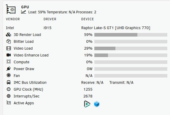

I'm using Intel i915 QSV and VAAPI
1 hour ago, Griz said:
Do we need to request apps to be reported under "Active Apps"? If so, I'd like to request Dispatcharr and NextPVR dockers.
Try loading this dev version it should pickup icons from the dockers. Install this dev release, https://raw.githubusercontent.com/SimonFair/gpustat-unraid/refs/heads/Dynamic-App-Support/gpustat.plg
I am looking to update the plugin to this new version within the next few weeks.
That worked, thanks! I guess I should find a real icon for NextPVR. I never noticed until just now that it has a default docker icon )

Hello! I have just installed a GPU into my Unraid server for the first time and this is what the GPU statistics shows. I have not configured the GPU to be used by anything yet.
Is it normal for it to show a throttled state of: Yes (sw_power_cap)? (I have only installed the nvidia drivers and the gpu statistics plugin)
GPU stat just uses values from Nvidia smi value does change most of the time it shows p8 when not in use. Not sure why p5 is shown.
It may be. From what I understand, Nvidia cards typically boot in a high power state, and only drop to low power (p8) after they have been used for the first time. You don't currently have the card tasked to do anything, so this likely is why you see this.
Try entering this in a terminal window: nvidia-persistenced
This allows the GPU to go to low power when not in use. I have it in a small script file, set to run At Start of Array (via User Scripts)
