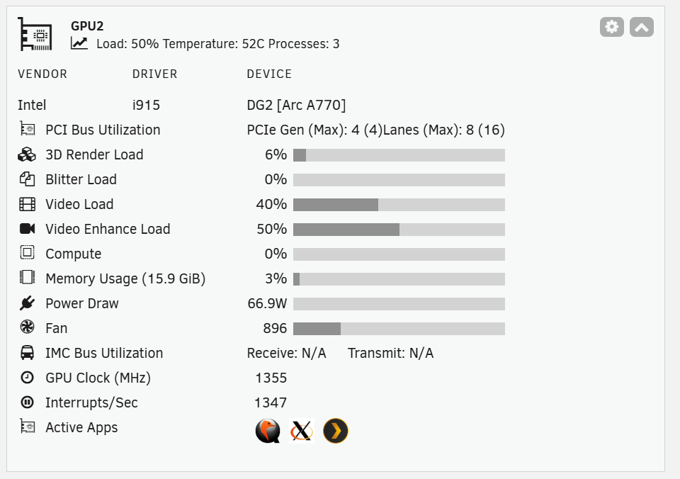

This is is how my A770 looks with top + qmassa. Plex is tanscoding and VM is using virtio3d and running glxgears. Please give it a go an let me know any feedback when you can.

Looking good! PCI bus utilization shows more (not stuck on 1 as usual with Linux and Arc).
Fan show N/A when qmassa show 0. When it spins, it shows up but then back to N/A when it stops.
Provoked the fan to turn on with some local ollama ai work. The ?-active app is qmassa.
GPU Clock (MHz) show 0 when not under load but that's normal maybe?
Edited by Niklas
@Niklas Thanks for testing.
Attached an updated file to show zero fan and not show qmassa in apps.
Also I noticed the PCI gen is 4 but max is 3. So this should be fixed with an updated main.php which goes in the lib directory.
Intel.php Main.php
Thanks @SimonF!
PCIe Gen (Max): 3 (4)Lanes (Max): 8 (8), looking good. Just a missing space/delimiter before Lanes.
Fan still shows N/A at 0.

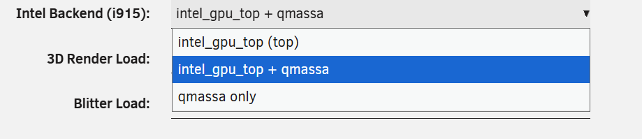

Release 2026.05.10
With this release you can now select the backend processing for i915. The default option is just to use intel_gpu_top.
Changing to top + qmassa will show fans, power draw memory usage for ARC cards.
qmassa can be set on its own, but you will loose utilisation. For XE drivers just qmassa is used as it support these metrics also.
PCI reporting has been updated to look at upstream speeds to remove the x1 reporting.
When using intel_gpu_top + qmassa the "GPU Clock (MHz)" show 0 when the card has no work. Only showing values over 0 under load.
When using qmassa only it shows a frequency at idle, and thats probably correct. In my case it will never be 0 as my hw is too old to get the card down in the lowest power saving state.

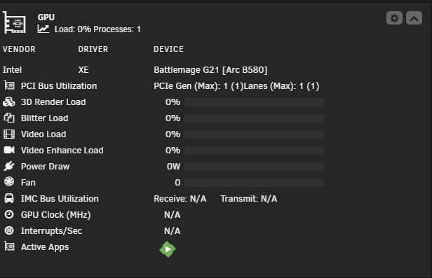

@SimonF Been about a year since I've been on this page looking for a situation with my b580.
Rolled up Unraid to 7.3.0 so using the default kernel again, over Thor's, and noticed that the PCI lanes, power draw and fan report values now - awesome work. Somewhat minor item now, appears with the more recent 2026.5.11 release the active apps has broken for myself when detecting transcoding sessions with Emby. Below is a screenshot of what it used to be (Around May 1, apologies I don't have the exact plugin version available but safe to say it would have been the released version for that time period) and what it is now when doing the same transcoding function.
Try doing ctlr + F5 to reload the page as may have cache the JavaScript.
No dice. Still not detecting. Below is the output of "ps aux | grep ffmpeg" both while transcoding and not for reference.
Transcoding -
nobody     20229  6.1  1.0 275874176 1395524 ?   Sl   16:29   3:35 /system/EmbyServer -programdata /config -ffdetect /bin/ffdetect -ffmpeg /bin/ffmpeg -ffprobe /bin/ffprobe -restartexitcode 3
nobody    303184  7.0  0.0 114020 28284 ?        Sl   17:26   0:07 /bin/ffmpeg -loglevel +timing -y -print_graphs_file /config/logs/ffmpeg-remux-2436e0ea-6ba6-424a-bc70-0ce0fa8be41e_1graph.txt -copyts -start_at_zero -f matroska,webm -ss 00:10:48.000 -c:v:0 hevc -noautorotate -c:v:1 mjpeg -c:v:2 mjpeg -c:v:3 mjpeg -c:v:4 mjpeg -i /mnt/Movies/somemovie.mkv -map 0:0 -map 0:1 -sn -c:v:0 copy -bsf:v:0 hevc_mp4toannexb -c:a:0 libmp3lame -ab:a:0 192000 -ac:a:0 2 -metadata:s:a:0 language=eng -filter:a:0 volume=1.4 -disposition:a:0 default -max_delay 5000000 -avoid_negative_ts disabled -f segment -map_metadata -1 -map_chapters -1 -segment_format mpegts -segment_list /tmp/transcoding-temp/CD650F/CD650F.m3u8 -segment_list_type m3u8 -segment_time 00:00:06.000 -segment_time_delta -00:10:48.000 -segment_start_number 108 -individual_header_trailer 0 -write_header_trailer 0 -segment_write_temp 1 /tmp/transcoding-temp/CD650F/CD650F_%d.ts
not transcoding
nobody     20229  5.9  1.0 275874128 1387148 ?   Sl   16:29   3:40 /system/EmbyServer -programdata /config -ffdetect /bin/ffdetect -ffmpeg /bin/ffmpeg -ffprobe /bin/ffprobe -restartexitcode 3
root      333301  0.0  0.0   4280  2504 pts/2    S+   17:31   0:00 grep ffmpeg
Transcoding -
not transcoding
Does this file exist and show any data? /tmp/hostapps
When transcoding.
Run qmassa in the terminal does it should any drm client.
cat /sys/kernel/debug/dri/0000:04:00.0/clients

Correct repo is here, https://github.com/SimonFair/gpustat-unraid
I will look into it, do you have errors set on PHP log settings?
Can you provide some info on the GPU you are using and the driver?
My PHP log level is set to default
The GPU is an Intel Arc Battlemage B580, using the XE driver
Thanks,
Josh
Thanks,
Josh
Created a new version 2026.05.16 which adds a debug option to settings so should not show the log entries now unless enabled.
Awesome, thanks for the quick turnaround, much appreciated

I'm having the issue with an ARC A310 where it isn't showing anything but fan usage and power draw. I've set it to top + qmassa... I've got tdarr almost constantly running GPU transcodes and I did confirm it is running when I did the requested support commands/documentation:
1&2:
root@[redacted]:~# timeout -k .500 .400 intel_gpu_top -J -s 250
root@[redacted]:~# cd /usr/local/emhttp/plugins/gpustat/ && php ./gpustatus.php
Could not open input file: ./gpustatus.php
3):
4) the contents of '/boot/config/plugins/gpustat/gpustat.cfg':
MULTIGPU = "85:00.0"
TEMPFORMAT = "F"
UIREFRESH = 1
UIREFRESHINT = 2000
DEBUGLOG = 0
DISPCLOCKS = 1
DISPPCIUTIL = 1
DISPPWRDRAW = 1
DISPPWRSTATE = 1
DISPMEMUTIL = 0
DISPTEMP = 0
DISPFAN = 1
DISPSESSIONS = 1
DISPENCDEC = 0
DISPTHROTTLE = 0
INTELBACKEND = "top_qmassa"
DISP3DRENDER = 1
DISPBLITTER = 1
DISPVIDEO = 1
DISPVIDENH = 1
DISPCOMPUTE = 1
DISPINTERRUPT = 1
DISPPWRDRWSEL = "GPU"
DISPEVENT = 0
DISPVERTEX = 0
DISPTEXTURE = 0
DISPSHADEREXP = 0
DISPSEQUENCER = 0
DISPSHADERINTER = 0
DISPSCANCON = 0
DISPPRIMASSEM = 0
DISPDEPTHBLK = 0
DISPCOLORBLK = 0
DISPGFXTRANS = 0
MULTIGPUJSON = "%7B%2285%3A00.0%22%3A%7B%22id%22%3A%2285%3A00.0%22%2C%22model%22%3A%22DG2+%5BArc+A310%5D%22%2C%22vendor%22%3A%22i>
