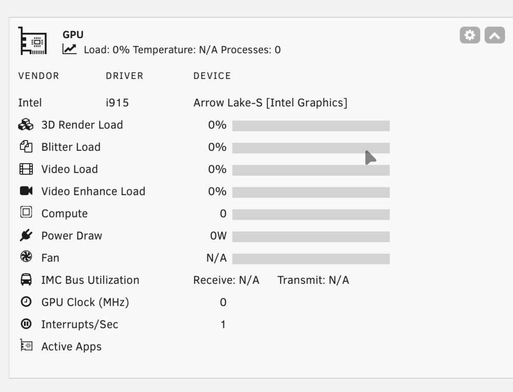

I have basically the same problem. I updated from an i7-8700k to a i5-14600k (where gpu reporting worked great) to an Ultra Core 2 265K, where all of the fields are blank.
Unraid 7.2.3, and the gpu plugins are all updated to current as of 12.26.25.
Here’s my cat gpu raw data output:
root@Tower:/tmp# cat gpurawdata0000\:00\:02.0
"[\n\n{\n\t\"period\": {\n\t\t\"duration\": 11.801962,\n\t\t\"unit\": \"ms\"\n\t},\n\t\"frequency\": {\n\t\t\"requested\": 0.000000,\n\t\t\"actual\": 0.000000,\n\t\t\"unit\": \"MHz\"\n\t},\n\t\"interrupts\": {\n\t\t\"count\": 0.000000,\n\t\t\"unit\": \"irq\/s\"\n\t},\n\t\"rc6\": {\n\t\t\"value\": 0.000000,\n\t\t\"unit\": \"%\"\n\t},\n\t\"power\": {\n\t\t\"GPU\": 0.000000,\n\t\t\"Package\": 19.067730,\n\t\t\"unit\": \"W\"\n\t},\n\t\"engines\": {\n\t\t\"Render\/3D\": {\n\t\t\t\"busy\": 0.000000,\n\t\t\t\"sema\": 0.000000,\n\t\t\t\"wait\": 0.000000,\n\t\t\t\"unit\": \"%\"\n\t\t},\n\t\t\"Blitter\": {\n\t\t\t\"busy\": 0.000000,\n\t\t\t\"sema\": 0.000000,\n\t\t\t\"wait\": 0.000000,\n\t\t\t\"unit\": \"%\"\n\t\t},\n\t\t\"Video\": {\n\t\t\t\"busy\": 0.000000,\n\t\t\t\"sema\": 0.000000,\n\t\t\t\"wait\": 0.000000,\n\t\t\t\"unit\": \"%\"\n\t\t},\n\t\t\"VideoEnhance\": {\n\t\t\t\"busy\": 0.000000,\n\t\t\t\"sema\": 0.000000,\n\t\t\t\"wait\": 0.000000,\n\t\t\t\"unit\": \"%\"\n\t\t},\n\t\t\"Compute\": {\n\t\t\t\"busy\": 0.000000,\n\t\t\t\"sema\": 0.000000,\n\t\t\t\"wait\": 0.000000,\n\t\t\t\"unit\": \"%\"\n\t\t}\n\t},\n\t\"clients\": {\n\n\t}\n}\n{\n\t\"period\": {\n\t\t\"duration\": 1010.531708,\n\t\t\"unit\": \"ms\"\n\t},\n\t\"frequency\": {\n\t\t\"requested\": 0.000000,\n\t\t\"actual\": 0.000000,\n\t\t\"unit\": \"MHz\"\n\t},\n\t\"interrupts\": {\n\t\t\"count\": 0.989578,\n\t\t\"unit\": \"irq\/s\"\n\t},\n\t\"rc6\": {\n\t\t\"value\": 0.000000,\n\t\t\"unit\": \"%\"\n\t},\n\t\"power\": {\n\t\t\"GPU\": 0.000000,\n\t\t\"Package\": 13.444708,\n\t\t\"unit\": \"W\"\n\t},\n\t\"engines\": {\n\t\t\"Render\/3D\": {\n\t\t\t\"busy\": 0.000000,\n\t\t\t\"sema\": 0.000000,\n\t\t\t\"wait\": 0.000000,\n\t\t\t\"unit\": \"%\"\n\t\t},\n\t\t\"Blitter\": {\n\t\t\t\"busy\": 0.000000,\n\t\t\t\"sema\": 0.000000,\n\t\t\t\"wait\": 0.000000,\n\t\t\t\"unit\": \"%\"\n\t\t},\n\t\t\"Video\": {\n\t\t\t\"busy\": 0.000000,\n\t\t\t\"sema\": 0.000000,\n\t\t\t\"wait\": 0.000000,\n\t\t\t\"unit\": \"%\"\n\t\t},\n\t\t\"VideoEnhance\": {\n\t\t\t\"busy\": 0.000000,\n\t\t\t\"sema\": 0.000000,\n\t\t\t\"wait\": 0.000000,\n\t\t\t\"unit\": \"%\"\n\t\t},\n\t\t\"Compute\": {\n\t\t\t\"busy\": 0.000000,\n\t\t\t\"sema\": 0.000000,\n\t\t\t\"wait\": 0.000000,\n\t\t\t\"unit\": \"%\"\n\t\t}\n\t},\n\t\"clients\": {\n\n\t}\n}]\n"
It always shows this even when Plex is using hw transcode.

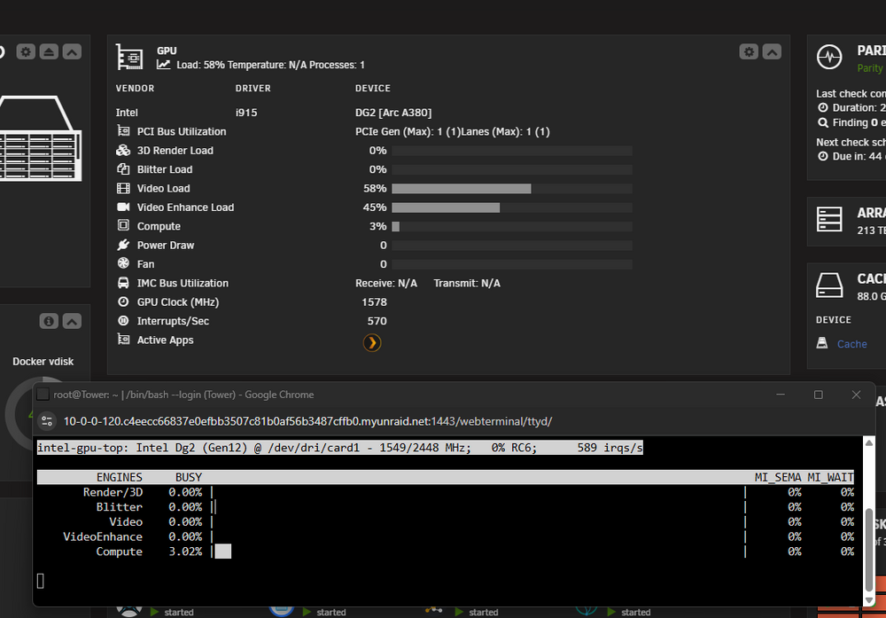

I Just installed a Sparkle A310 card.
It works excellent but I have "problems" with the GPU statistics Plugin
1. It shows PCIe Gen (Max): 1 (1)Lanes (Max): 1 (1) which is wrong. My Dell R740XD have PCIe Gen 3 and the port is 8X
2. How is it even possible that the card use 203% Video Load during transcoding/converting from MP4 to MKV?
Any idea what might be wrong?

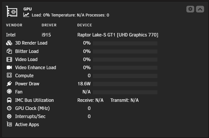

Hello and thank you for this plugin. I am setting up on fresh Unraid install 7.2.3 and cant get my Intel iGPU to show stats. I have an Nvidia Quadro P400 card also which appears to be showing everything correctly. Any suggestions on what to try to get iGPU working is appreciated!
root@OMNIUS:~# timeout -k .500 .400 intel_gpu_top -J -s 250

Do you have anything using the GPU? Panel match top output.

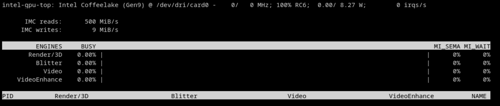

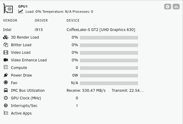

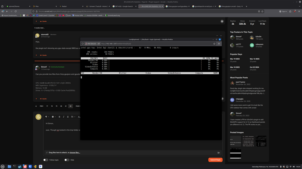

Hiya,
the plugin isn't showing any gpu stats except IMB bus utilisation. using an intel arc a380. It isn't bound to VFIO. Do you have any suggestions? thanks very much!
Can you provide two files from /tmp gpujson and gpudatapciid that matches the a380
sorry my response seems to have removed any text i had typed. I can not find a tmp folder that isnt empty. sorry for the silly question but where should i be looking?
Open a terminal
root@computenode:~# ls /tmp/gpudata*
/tmp/gpudata0000:00:02.0
root@computenode:~# ls /tmp/gpujson
/tmp/gpujson
root@computenode:~#

11 hours ago, SimonF said:
Open a terminal
/tmp/gpujson
root@computenode:~#
cheers!
gpudata*
"period":{"duration":1012.886109,"unit":"ms"},"frequency":{"requested":0,"actual":0,"unit":"MHz"},"interrupts":{"count":0,"unit":"irq\/s"},"rc6":{"value":0,"unit":"%"},"imc-bandwidth":{"reads":190.513769,"writes":53.30065,"unit":"MiB\/s"},"engines":{"Render\/3D":{"busy":0,"sema":0,"wait":0,"unit":"%"},"Blitter":{"busy":0,"sema":0,"wait":0,"unit":"%"},"Video":{"busy":0,"sema":0,"wait":0,"unit":"%"},"VideoEnhance":{"busy":0,"sema":0,"wait":0,"unit":"%"},"Compute":{"busy":0,"sema":0,"wait":0,"unit":"%"}},"clients":[]
gpu json
Time = Tue, 17 Feb 2026 09:34:12 +0000
{"03:00.0":{"clock":0,"fan":0,"memclock":"N\/A","memutil":"N\/A","memused":"N\/A","power":"0","powermax":"N\/A","rxutil":"190.51 MB\/s","txutil":"53.3 MB\/s","temp":"N\/A","tempmax":"N\/A","util":"0%","pciegen":1,"pciegenmax":1,"pciewidth":"1","pciewidthmax":"1","igpu":"0","vendor":"Intel","name":"DG2 [Arc A380]","3drender":"0%","blitter":"0%","interrupts":0,"powerutil":0,"video":"0%","videnh":"0%","compute":0,"sessions":0,"fanmax":4000,"active_apps":[],"vfio":false,"vfiochk":false,"vfiochkid":"0000:03:00.0","vfiovm":false,"driver":"i915","panel":1}}

Can you provide metrics when the GPU is in use? i.e. transcoding?
So after rebooting, and running a transcode again I guess it is "working" The fan, power draw, never move from zero.
And the PCI BUS info seem incorrect.
Plugin seems to install fine, but when my gpu is selected it causes the fan to ramp up and down. When this is happening it also shows the reported memory speed going up and down, but it's hard to just get a screenshot of that. NVTOP doesn't cause the same behavior and behavior existed with or without NVTOP being installed. Running current open source drivers on a 5060ti. The card does have a zero RPM idle out of the box and I haven't tried messing with fan curves manually.
